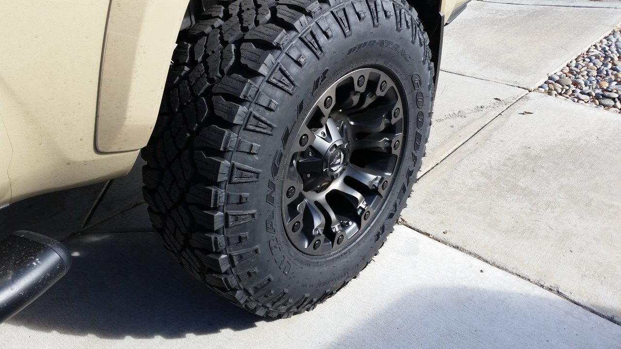

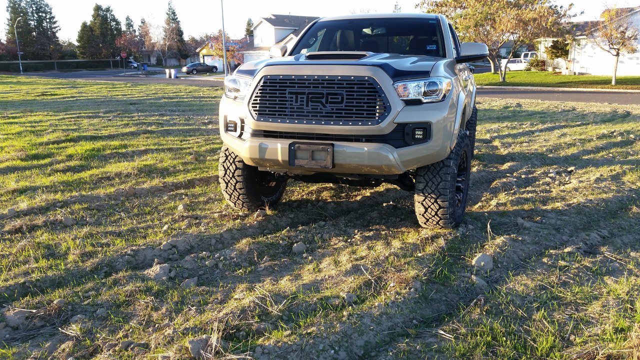

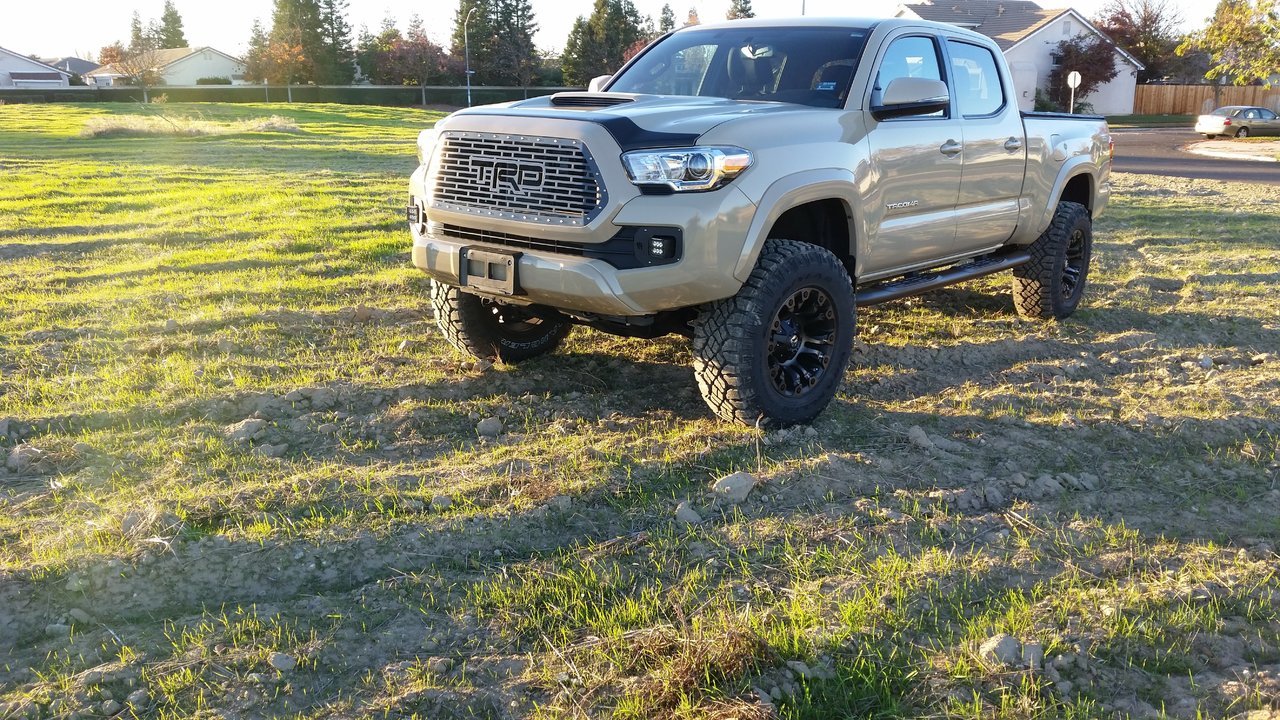

    Hey guys, so I have done a few things to my 2017 truck over the last 13,000 miles.

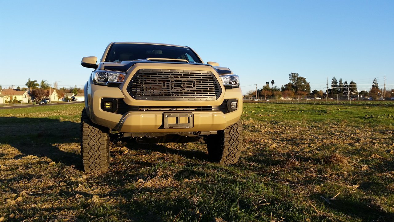

    *3/2 Rough Country suspension lift.
    -strut spacer and 2" blocks
    -No2 back shocks
    *285/70 R17 tires
    -goodyear wrangler Duratracs
    *fuel offroad Vapor 17x9 -12 offset machine tinted rims
    *TRD Sport OEM hood decal
    *custom grill
    *AVS hood deflector

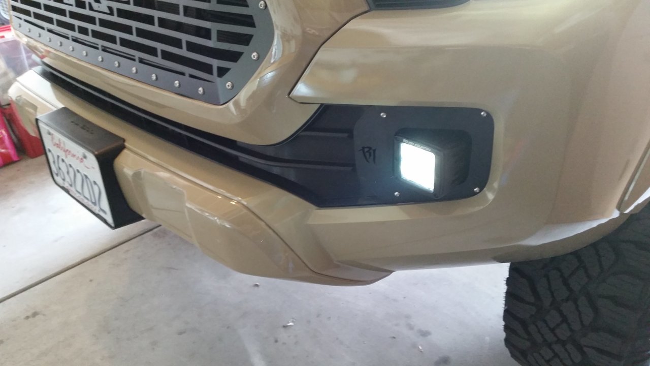

    *Rough Country 2" offroad LED black creed cube lights for fog light replacement

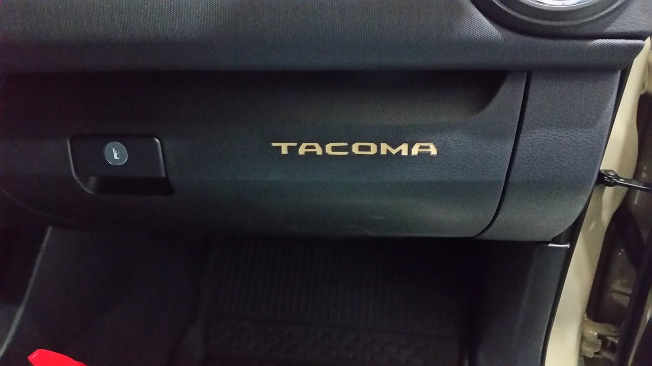

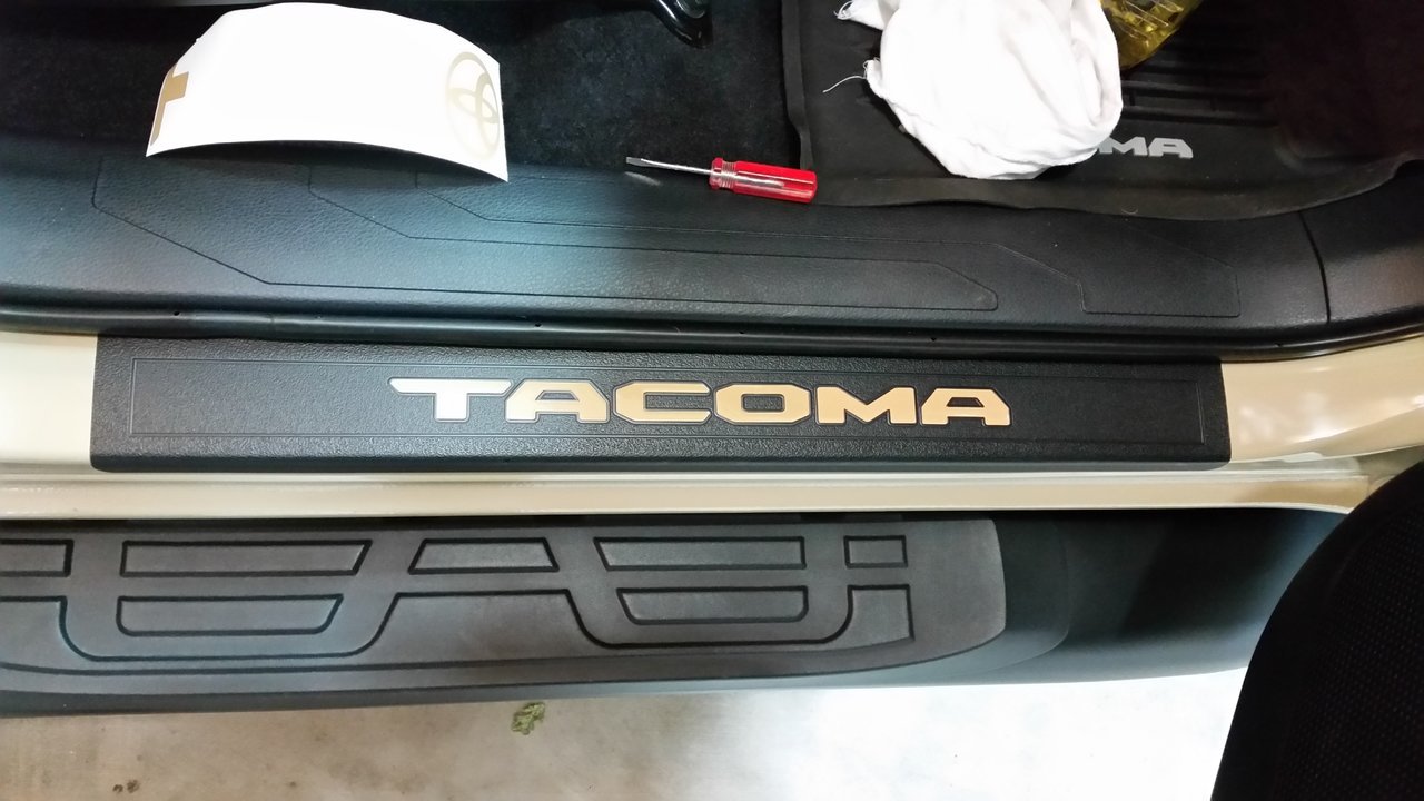

    *Rigid Industries fog mount light kit
    *vinal lettering for outside and inside

    Any rubbing with that lift and tires?
  4. Dec 20, 2017 at 9:54 AM
    3rdGen
    3rdGen [OP] Well-Known Member
    Jun 4, 2017
    #220680
    79
    17Toco TRDSport 4X4
    Hood decal
    Slight rubbing on plastic mudd flaps in front on half turn if going up or down a drive way fast. I took it off road, fairly easy, and no rubbing. No rubbing when normal driving on street. If I took off the flaps, it probably wouldn't rub at all. I have the tire pressure at 36psi and rides just like stock. Slight tire flap nice goING around 30 to 50 bit almost goes away on freeway

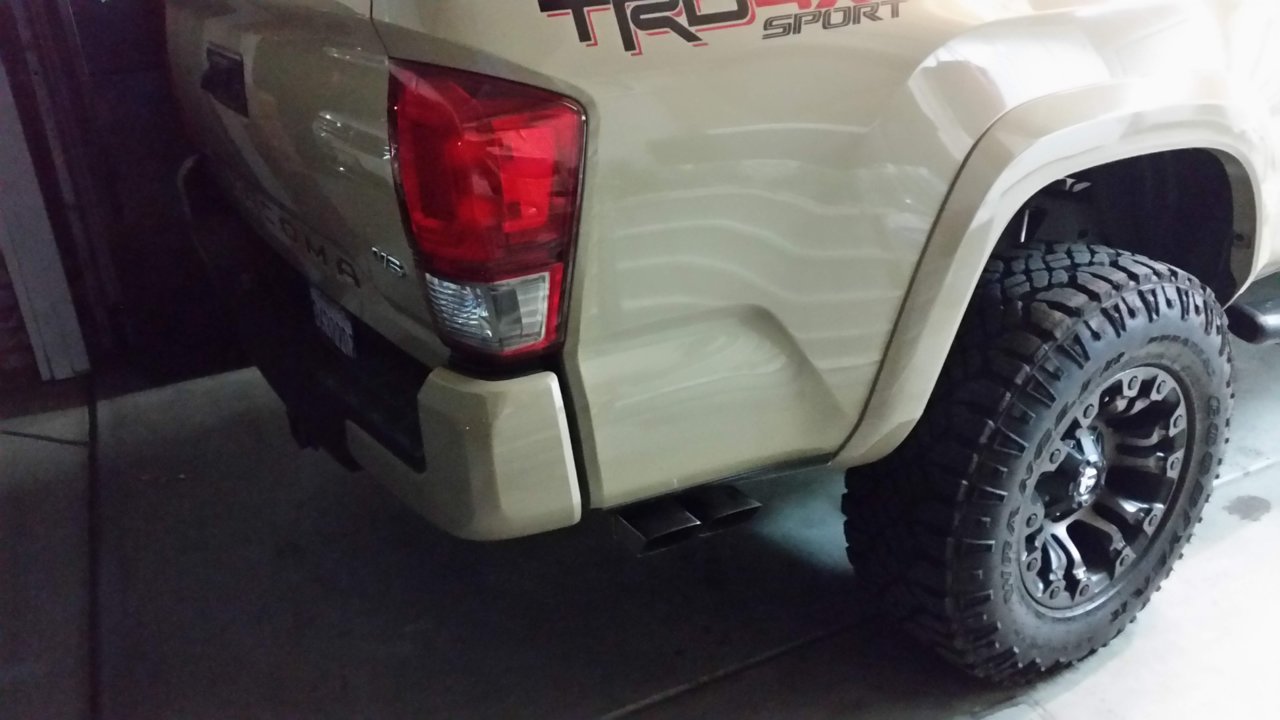

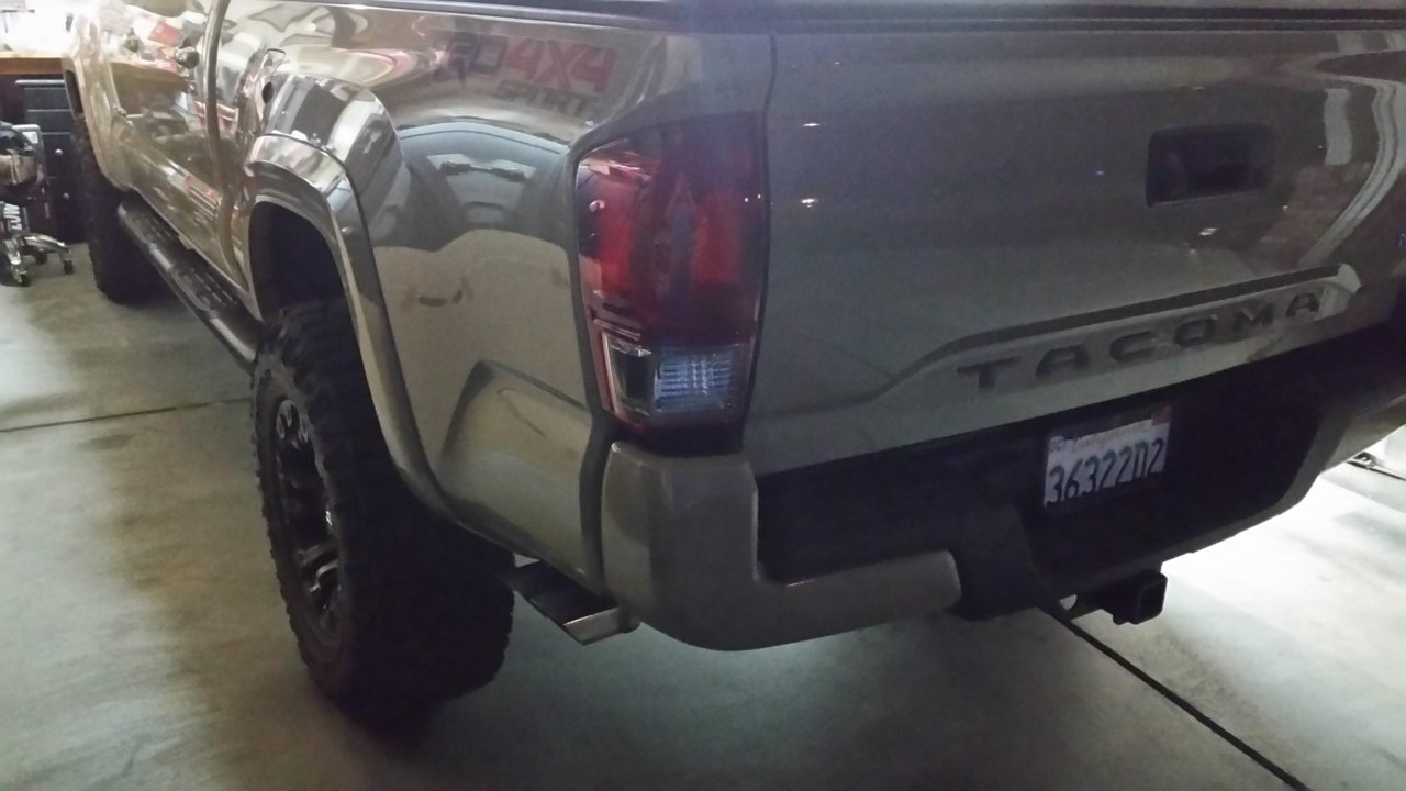

    Update on my truck. Put anew egsaust system on. Flowmaster delta 50 coming out both sides of truck. Sound good for a V6 I think. Of course it doesn't sound like an 8 but it's pretty deep sounding.

    Also, I found that with a 3/2 leveling RC kit, Fuel Vapors fit perfect with the positive 1 offset. I had -12 and they would rub slightly on the driver side. I have a 17x9 rim size with 285/70s
