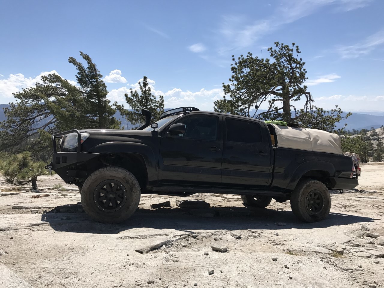

    So I've decided to start a build thread, to share with the tw fam and for personal reference. Hopefully I'll find all the pics I have from the beginning. It's a start and I'm gonna keep adding as I find new pics.
    Most recent pics...
    2011 DCLB SR5 4x4
    Suspension/Chassis
    FRONT:
    Bilstein 5100 @ 0"
    OME 886 coils
    1/4" top plate spaced on driver side
    Icon sway bar relocate
    Wheelers superbumps
    Camburg balljount UCAs
    REAR:
    Wheelers HD AAL
    Archive garage shackle flip
    Wheelers superbumps
    Bilstein B110
    Toytec U-bolt flip
    Wheelers extended brake lines(black)
    Lighting/Electrical
    50" radius roof led light bar
    20" Rigid amber single row(behind grille)
    Rigid side shooter ditch lights
    CBI ditch light brackets
    Perma-cool electric fan(condenser)
    "Raptor" Amber grille LEDs
    Red/Amber led "dust" lights
    Flyzeyes center console light
    Rigid flood pair(rear bumper)
    Rigid DOT fog pair(front bumper)
    Rigid hyper spot pair(front bumper)
    Offgrid engineering dual battery system
    Odyssey batteries
    Relocate winch solenoid
    EBay rock lights(~14)
    Amazon pods pair(bed lights)
    Cobra 29 CB radio & antenna
    Custome blue sea fuseblock mounting plate
    Blue sea fuse block(12 circuit)
    Blue sea circuit breakers
    Viair 400P-A onboard air custom mounted
    700/1400W inverter in center console
    Armor/Recovery
    BAMF weld-on Rock sliders
    SRD bed rack
    Lime green maxtrax
    Bruteforce Fab front bumper w/ hoops
    Bruteforce Fab rear bumper w/ dual swingouts
    Engo 10Ks winch
    Smittybilt snatch blocks
    Pro comp tow strap & tree savers
    Van beest 3/4" shackle
    Factor 55 pro link
    Peflreybilt front/mid/transfer/gas skids 1/4" aluminum
    Bubba rope
    Wheels/Tires

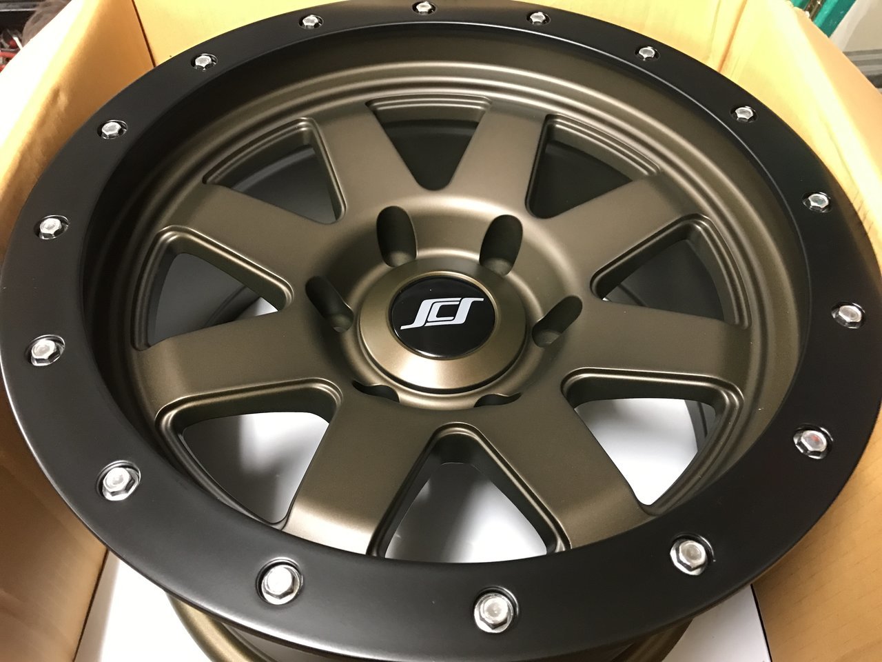

    SCS matte dark bronze 16" SR8(5)
    BFgoodrich KO2 265/75R16
    Misc
    Airflow snorkel

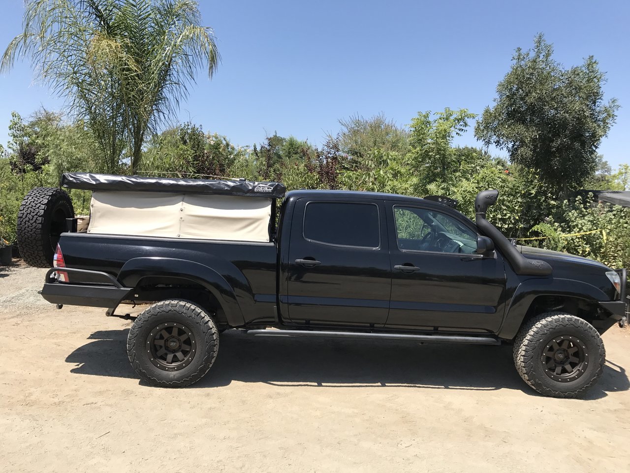

    Bedrack cover handmade in Visalia, CA
    Hi lift 60"
    Jack covers/step 22 lime green cover
    ARQ4wd 270* awning
    Custom hi lift slider adapter
    Custom extra large hilift base
    Milspec water and fuel 5 gallon cans

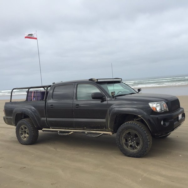

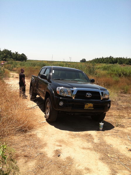

    One of the only pics I have of her when she was a pup, my buddy(pictured) and I headed out to play paintball with a couple co workers.

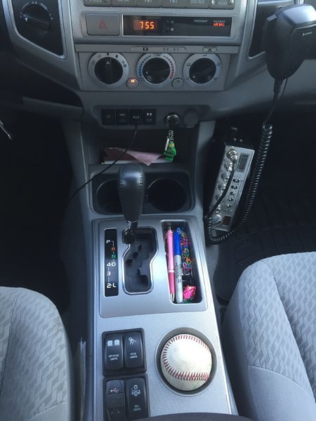

    Interior shot, just the center console for now..

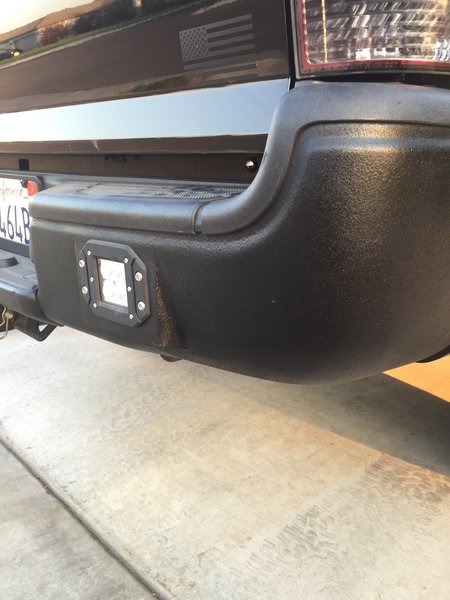

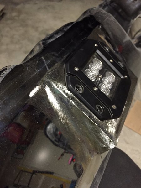

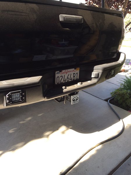

    My rear flush mount pods were aimed too far down so I modified the rear bumper to lift them up a bit.

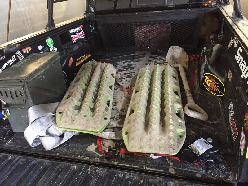

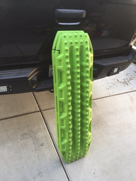

    Maxtrax!!!

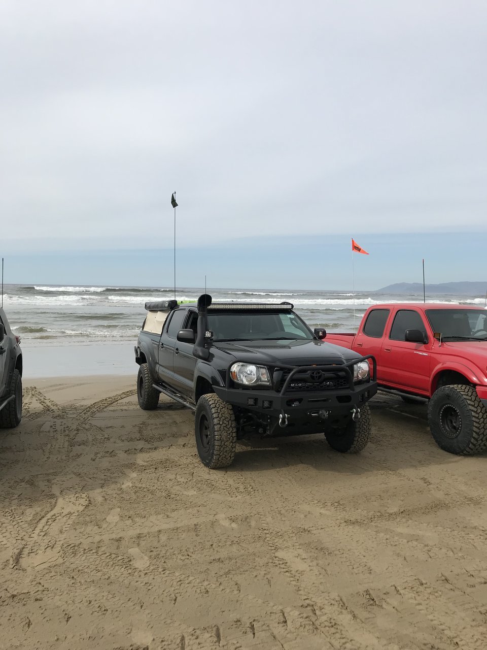

    Pismo trip
    OBA

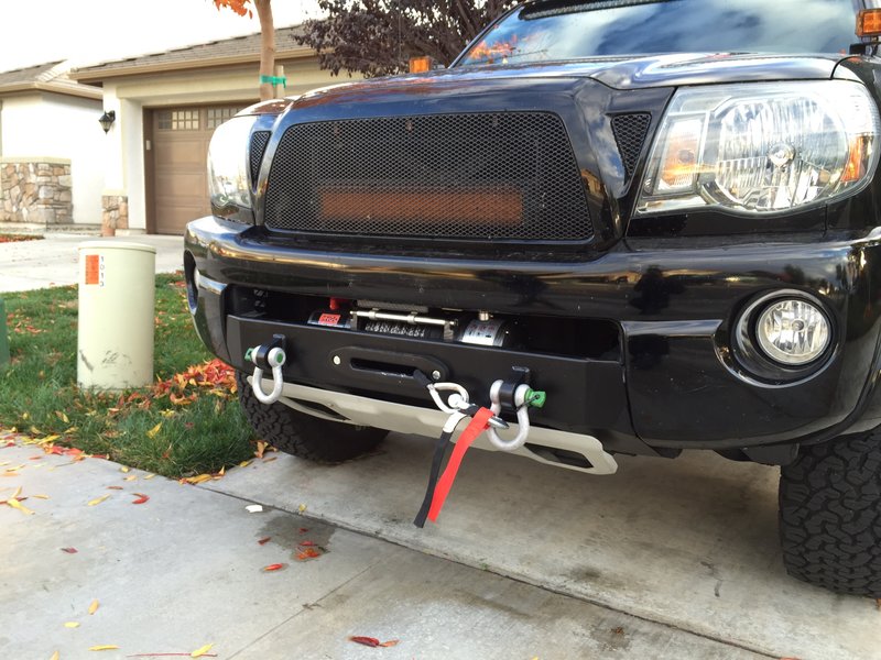

    Winch/bumper install

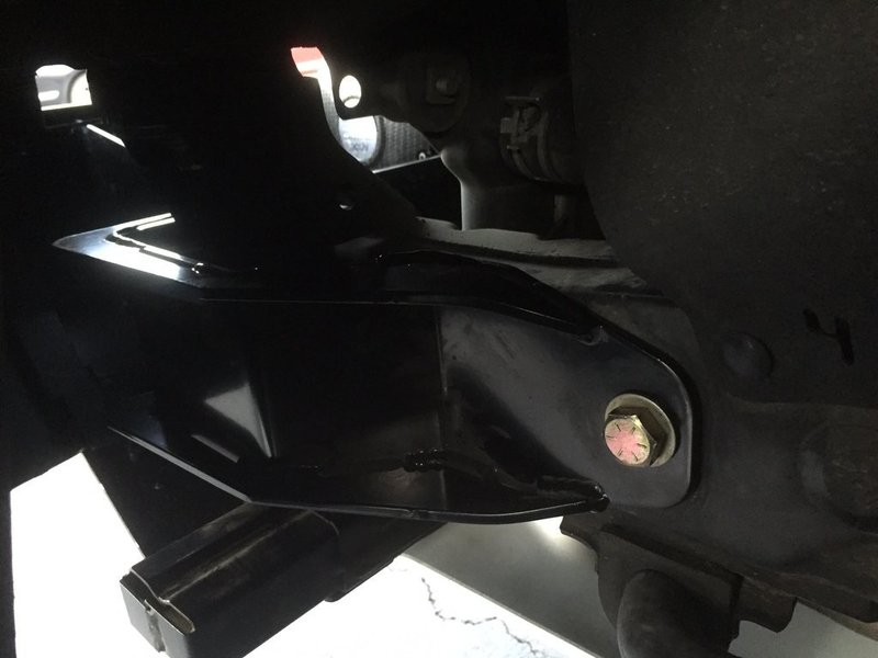

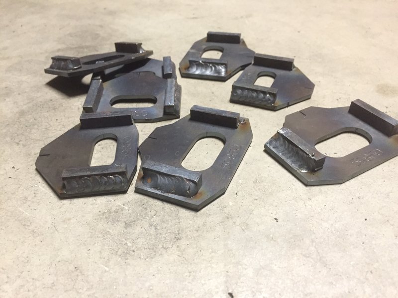

    TC spindle and cam tab gussets

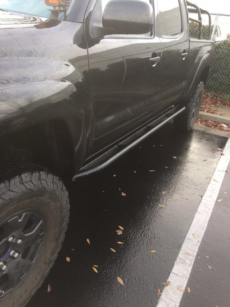

    BAMF sliders, weld-on

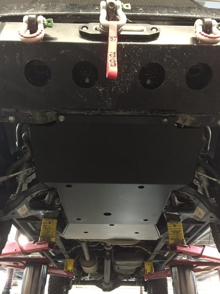

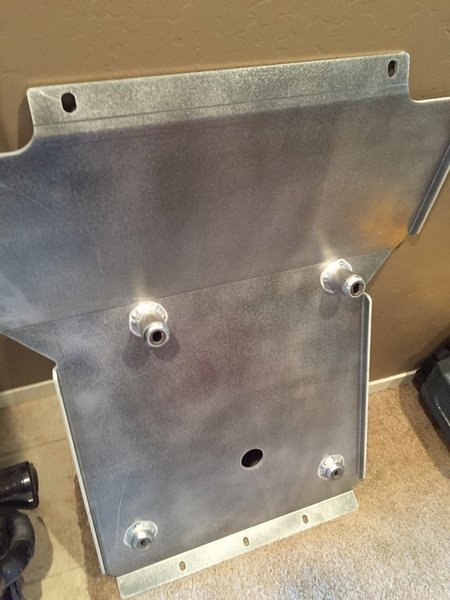

    So I added some @Pelfreybilt skids. Mid and ifs, in aluminum. Primed, coated with bedliner and top coated with satin black. Side note, they shipped fast, like Amazon fast, and great to deal with.

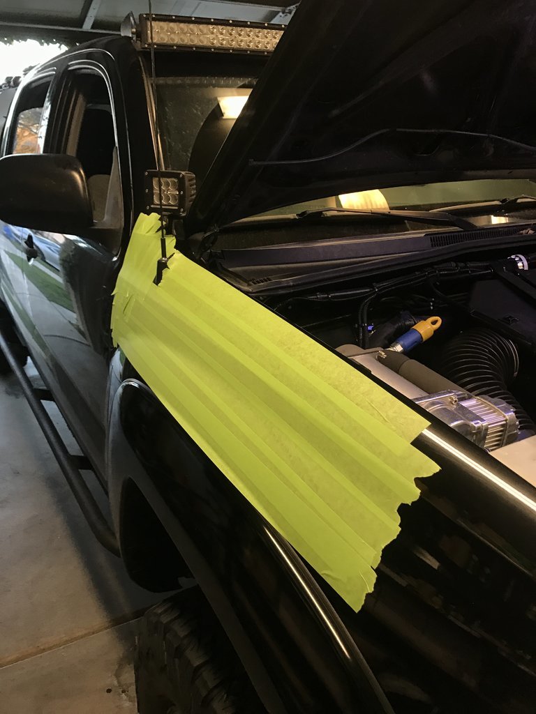

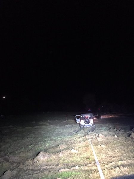

    I had about a foot long strip of LEDs that I mounted as hood lights. The other night after a recovery and I was trying to air up, I realized it was kinda difficult to see the battery and other engine bay areas without holding a flashlight. So I fixed that, used a hood switch. I might add more. image.jpg

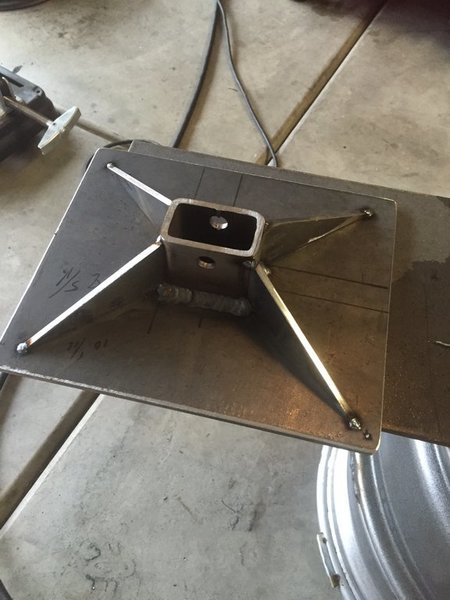

    I decided to make some accessories for my hi lift jack. An off road base and a slider adapter. image.jpg image.jpg

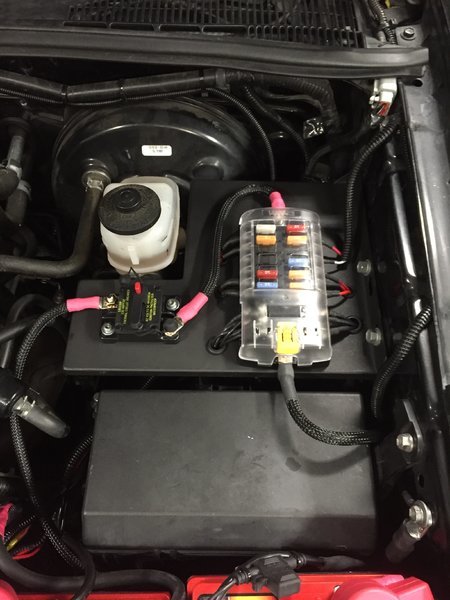

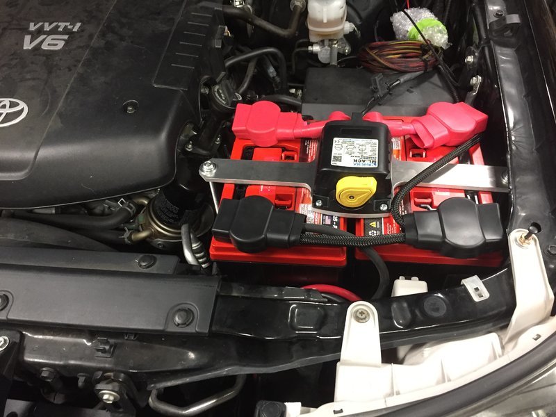

    The dual batteries installed...
    And my fuse block that I got from my SS @Sje1124 only took me 6 months to mount it lol

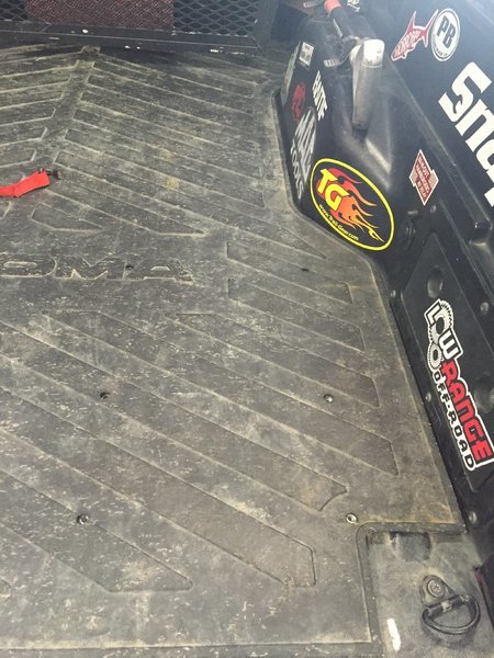

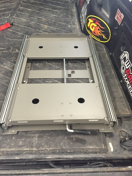

    The mounting holes for my indel fridge slide mount, just drilled holes into the bed and installed rivnuts, with some epoxy to help secure them into the fiberglass bed.
    Holes in the bed mat...
    And slide mounted...

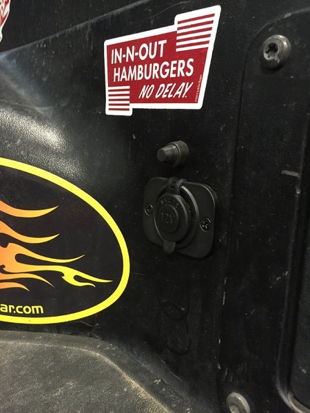

    And I added a 12v socket in the bed for the fridge, but realized I should of used some sort of connector. From using it for a few days, I think it will work for the road trip. Maybe later down the road I'll make a more secure type of connection.

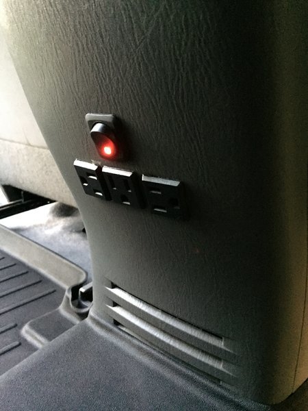

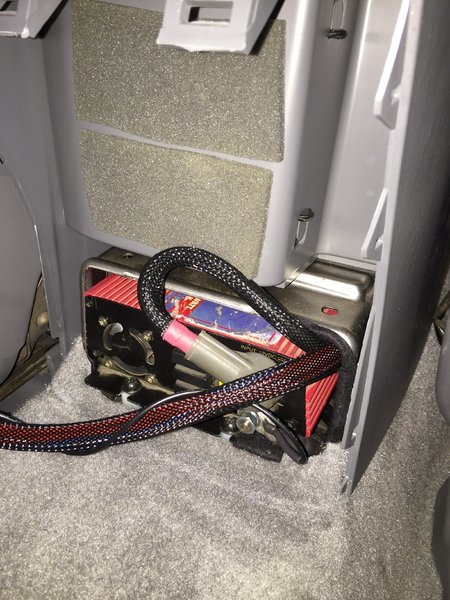

    Added a 700 watt inverter in the center console with rear facing outlets, for the kids gadgets while we're on the road...
    The inverter is old, I've had it for quite a few years, hence the dust.

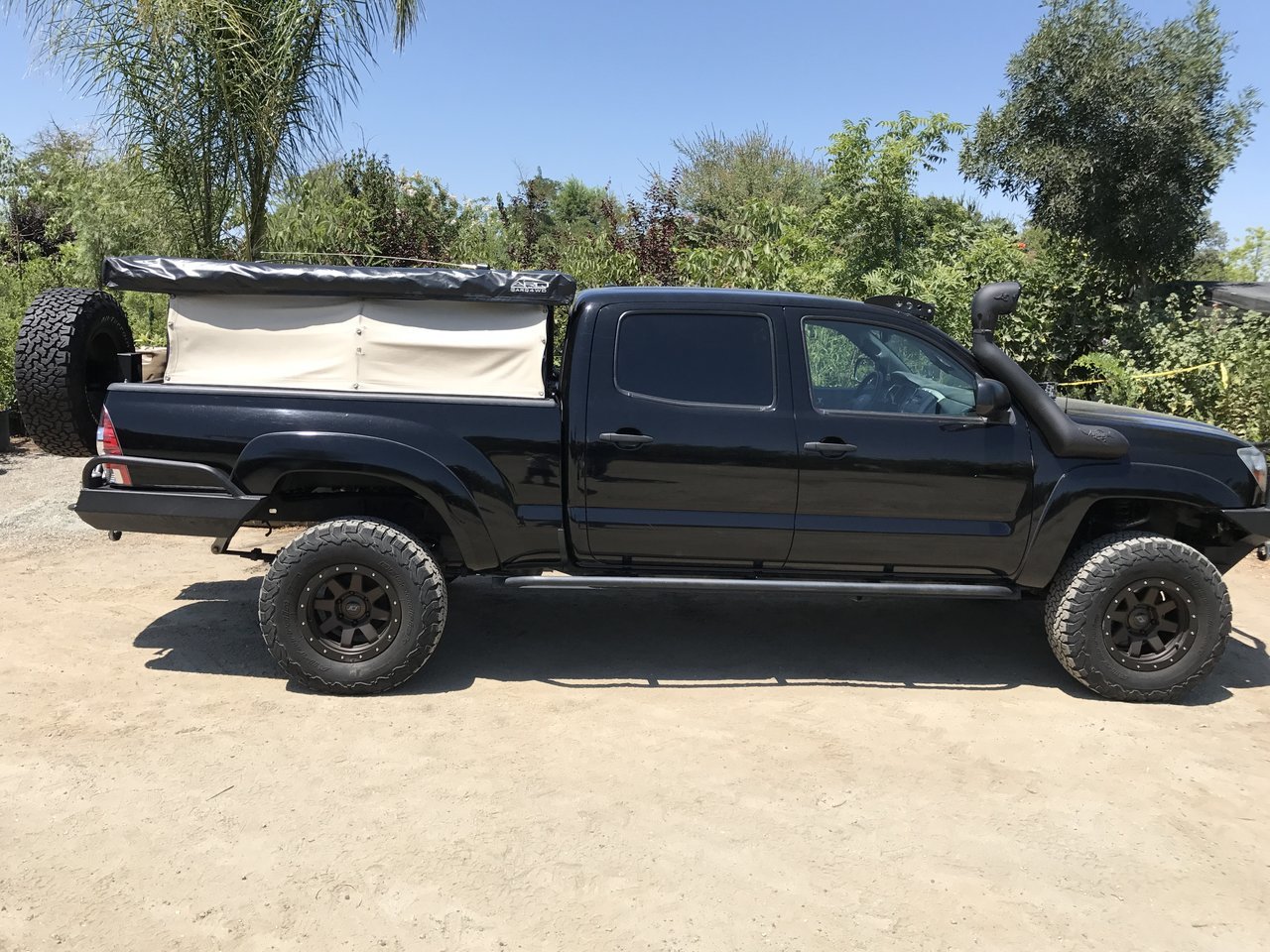

    Haha I totally forgot again. Here's a teaser :p

    Did you make that canvas top for your bed rack??​

    Yep!

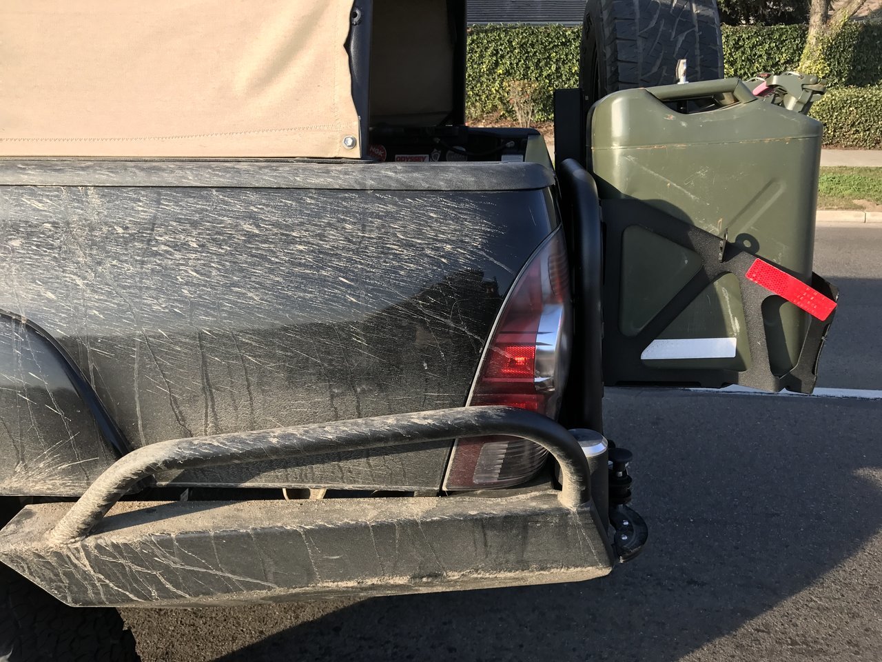

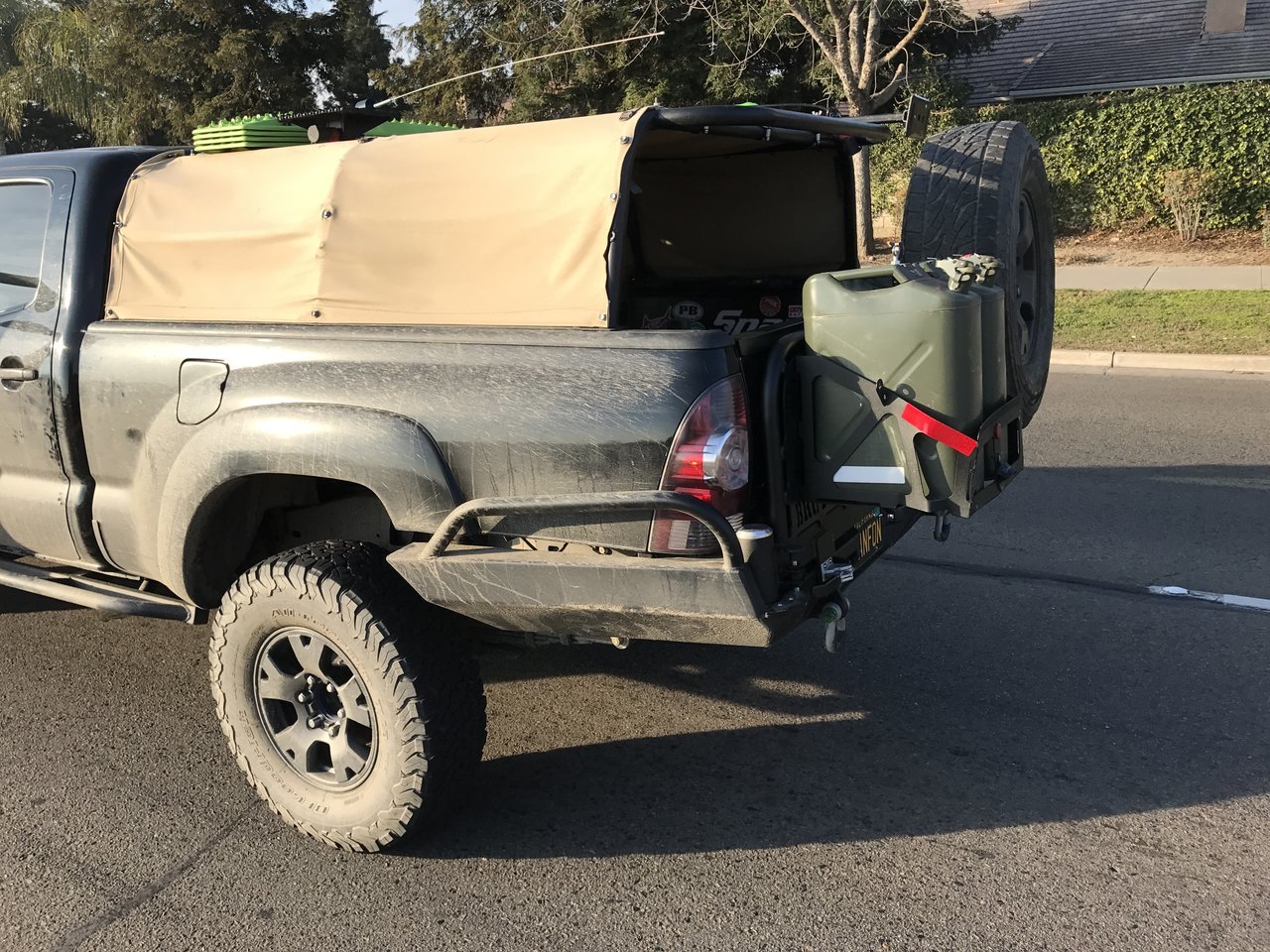

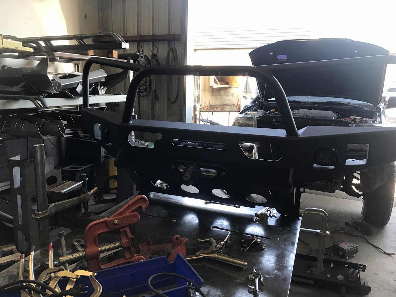

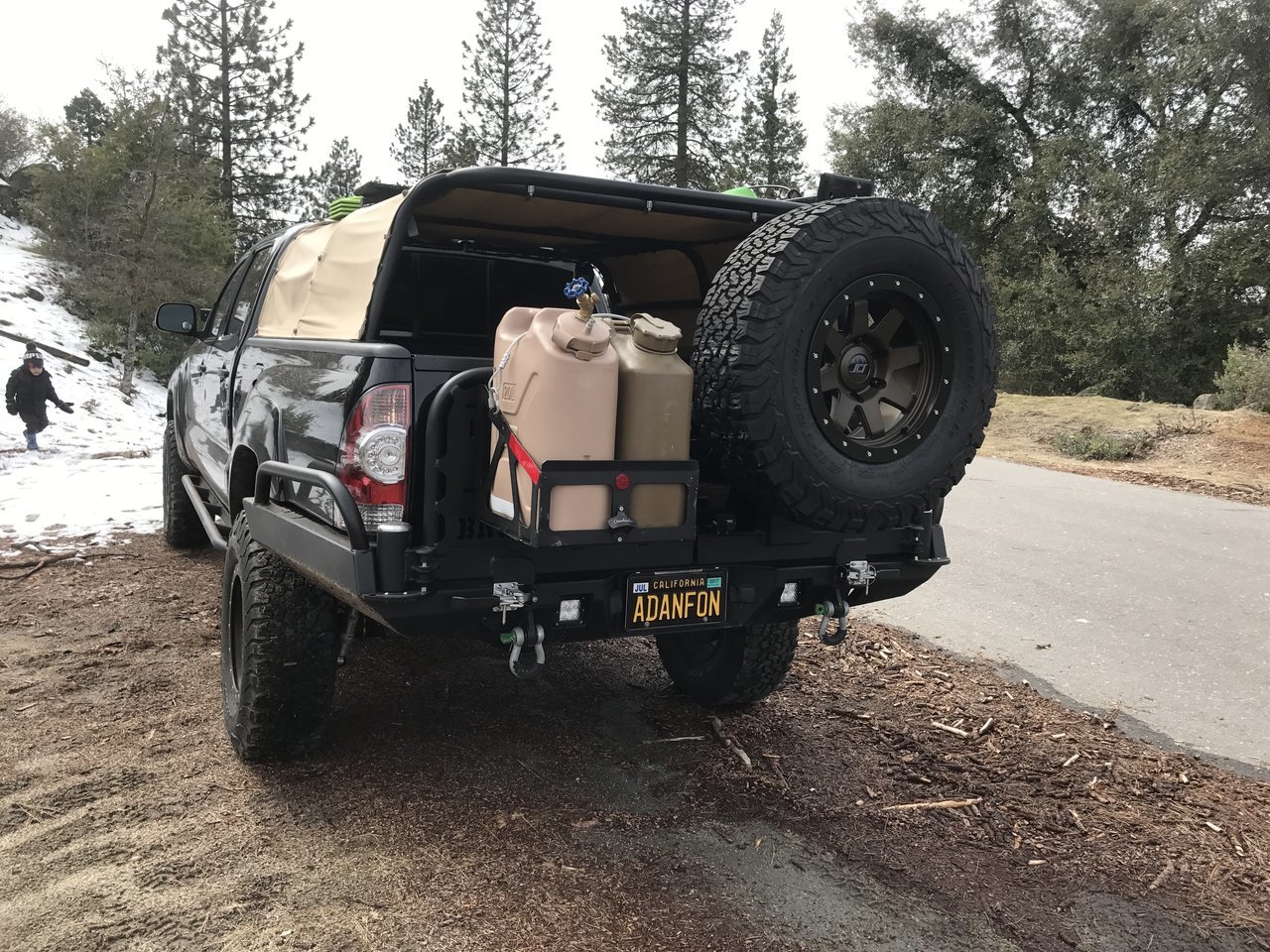

    So picking up where I left off a while back... I got a Bruteforce Fab rear bumper, had it for a month and I got rear ended:mad:
    The bumper held up unimaginably well! One of the swingout arms was bent a little, the jerry can holder was deformed, cans dented, scratches powder coat and slightly tilted forward. Other than that, nothing major needed repairing on the bumper or truck! The truck suffered a cracked taillight and dented tailgate, checked the frame and all was well! Dealt with the responsible parties insurance and everything went surprisingly smooth.

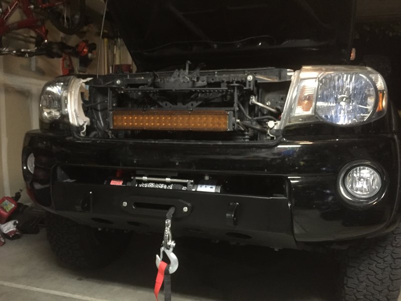

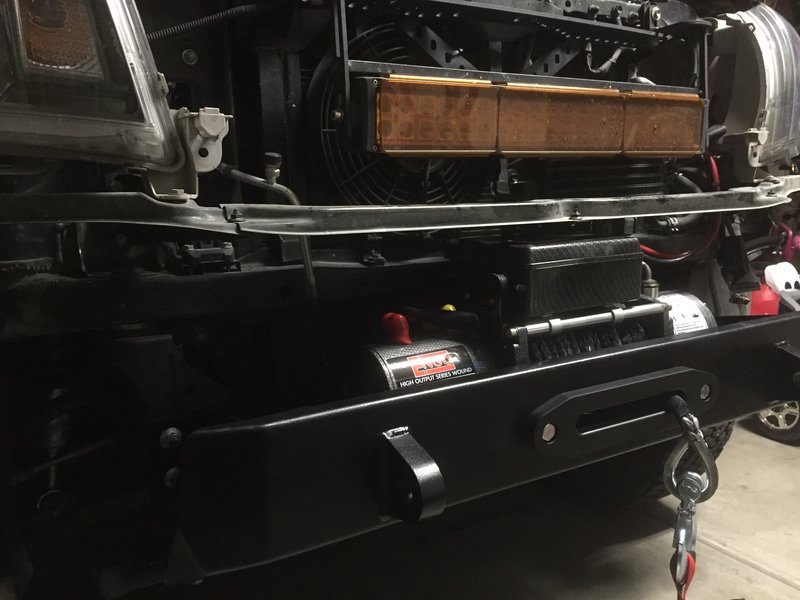

    So after being ecstatic that my truck wasn't gonna need any major repairs, I continued with my original plan to purchase a front bumper. So ordered that and splurged on some new wheels to eliminate the spidertrax spacers.

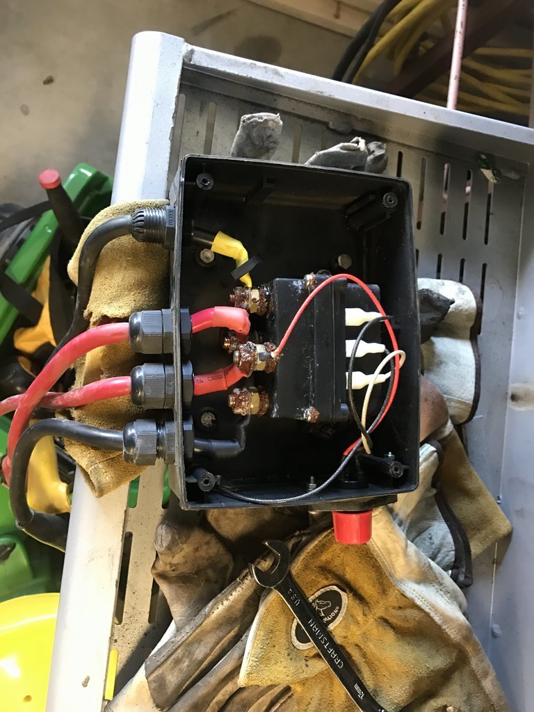

    While I had the winch out I decided to take a peak into the solenoid box, since it wouldn't fit with the new front bumper. My fear came true, severe corrosion and water still inside, from our river exploration trips. So figured might as well clean it up and relocate it, found a spot next to the power steering reservoir.

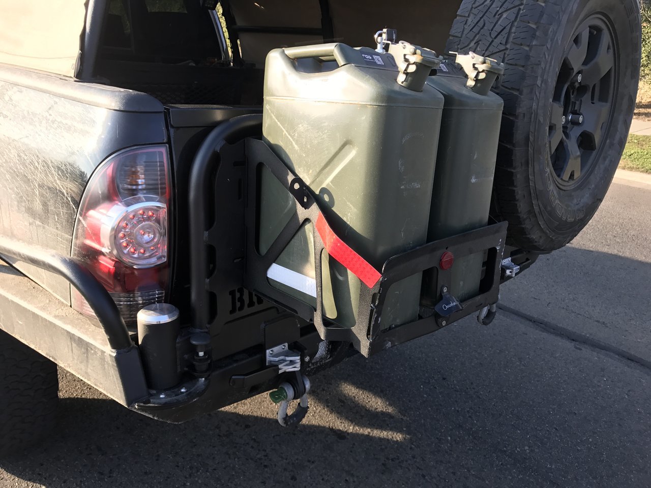

    Oh and after the accident decided to change my jerry cans up to the scepter milspec water and fuel cans. Added the spigot to the water can.
