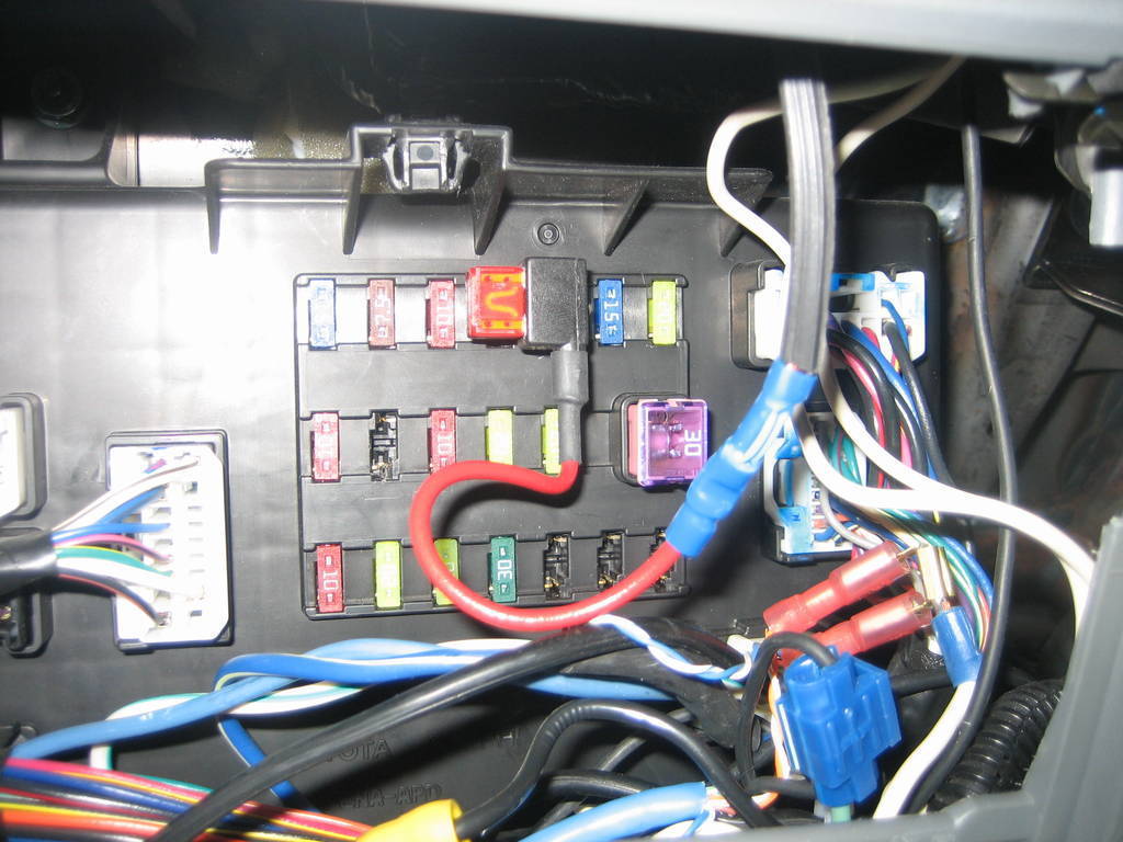

    I hope I posted this in the right area.. I want to use a mini add-a-circuit fuse in my 2006 tacoma. but the fuse that is in the tacoma fuse brick is smaller than the mini add-a-circuit adapter and it does not fit. will it still work?? or where is one i can get that work with the tacoma fuse??

    take that one back and get the smaller one, there are a few different sizes for fuses

    Get the small one shown below. If you stick it in where I did (where the 7.5 fuse is) you will get power switched on and off by the ignition.

    so you are using a Add-a- circuit min fuse?? and you changed the mini low profile fuse to mini 7.5 fuse??

    yeah man. you don't need the low profile guys. the standard mini fuses are just fine.
