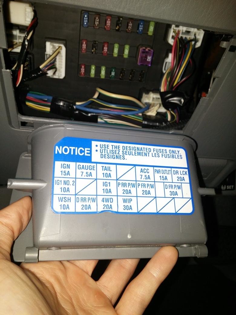

    Pretty sure the access cab doesn't have any extra powered fuse slots, I think another member in another thread covered that.

    Here's the chart. D RR P/W and P RR P/W.

    Yup.....just like mine, and you can use the wsh 10a

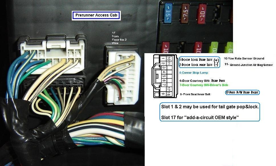

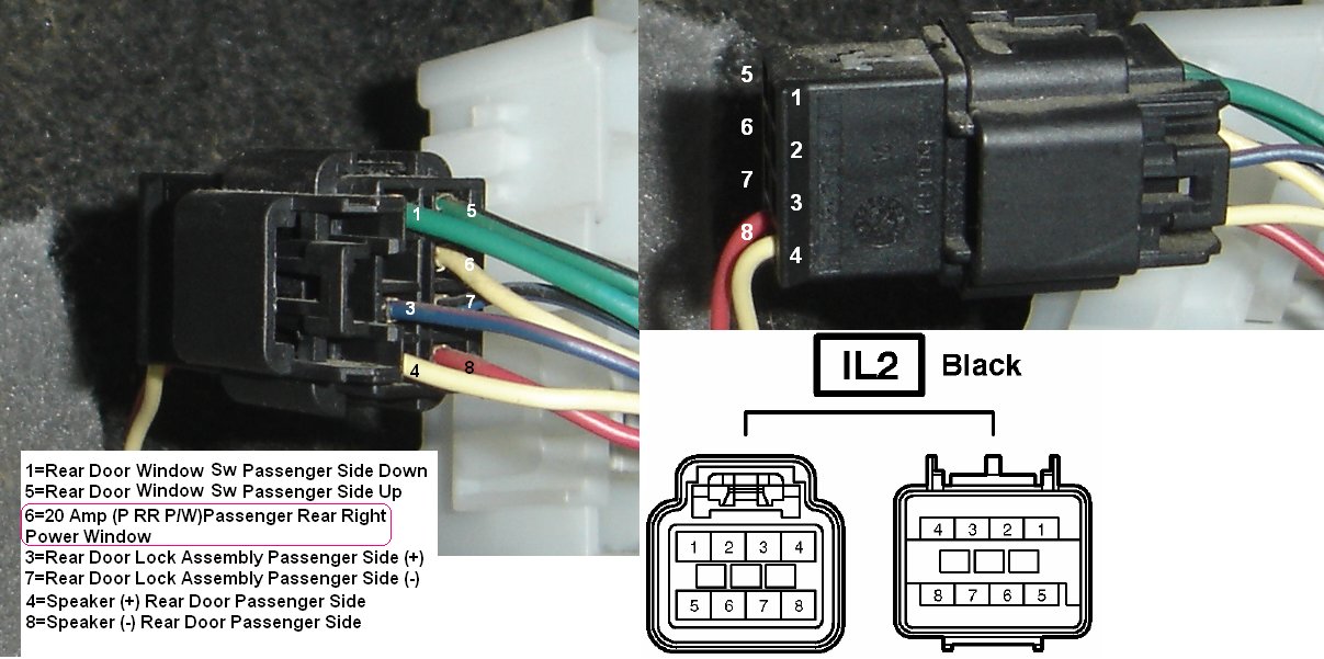

    In the passenger side kick panel you'll find the connector juiced and without the harness to the rear windows.
    On the Cab Fuse Box (BECU) the 1F Connector has Slot 17 empty which correlates to "rear right passenger power window".
