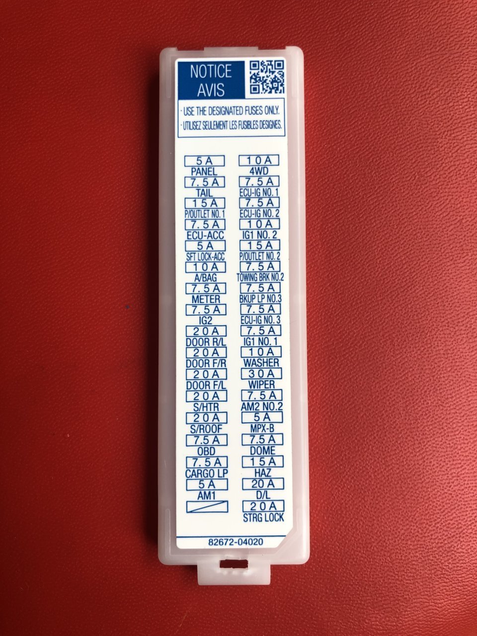

    20 amp Sliding Roof is always "hot"...
    vicali likes this.

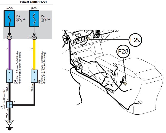

    2016 info:
    kfacc, honkonbobo and daveeasa like this.

    Hood Struts, My version Fogs always ON, Map & Overhead Light Mod,
    Your year might have these USB instead of the 12v socket in the center console:
    kfacc and daveeasa like this.

    I took apart the center console to change/add USB charging. Looking to put a PD charger for rear seat passengers. Was going to disconnect the factory one in the center console and use the wiring to power the new USB charger. It is a 2x45 watt PD charger.
    So probably at/or over the limits of what I should connect to the factory harness. But, those wires going to Poutlet2 are mighty small. How do they rate those for carrying 15 amps? I am going to run new power wire myself.

    I ran 8 gauge power from the battery and switched it with a high current relay triggered by poutlet1 to a blue sea compact fuse block. That gave me 8 circuits to work with. That covers seat heat, USB power in the dash and rear of center console, my Germes unit and my front camera. But it does take up a fair bit of space.
    Prior to running a direct battery feed I used the trailer brake controller as a +12v battery power source.
    Details in my build thread if you are interested.
    I also did not like how thin the wire is for these outlets and wouldn’t want to push 15 amps through them.
