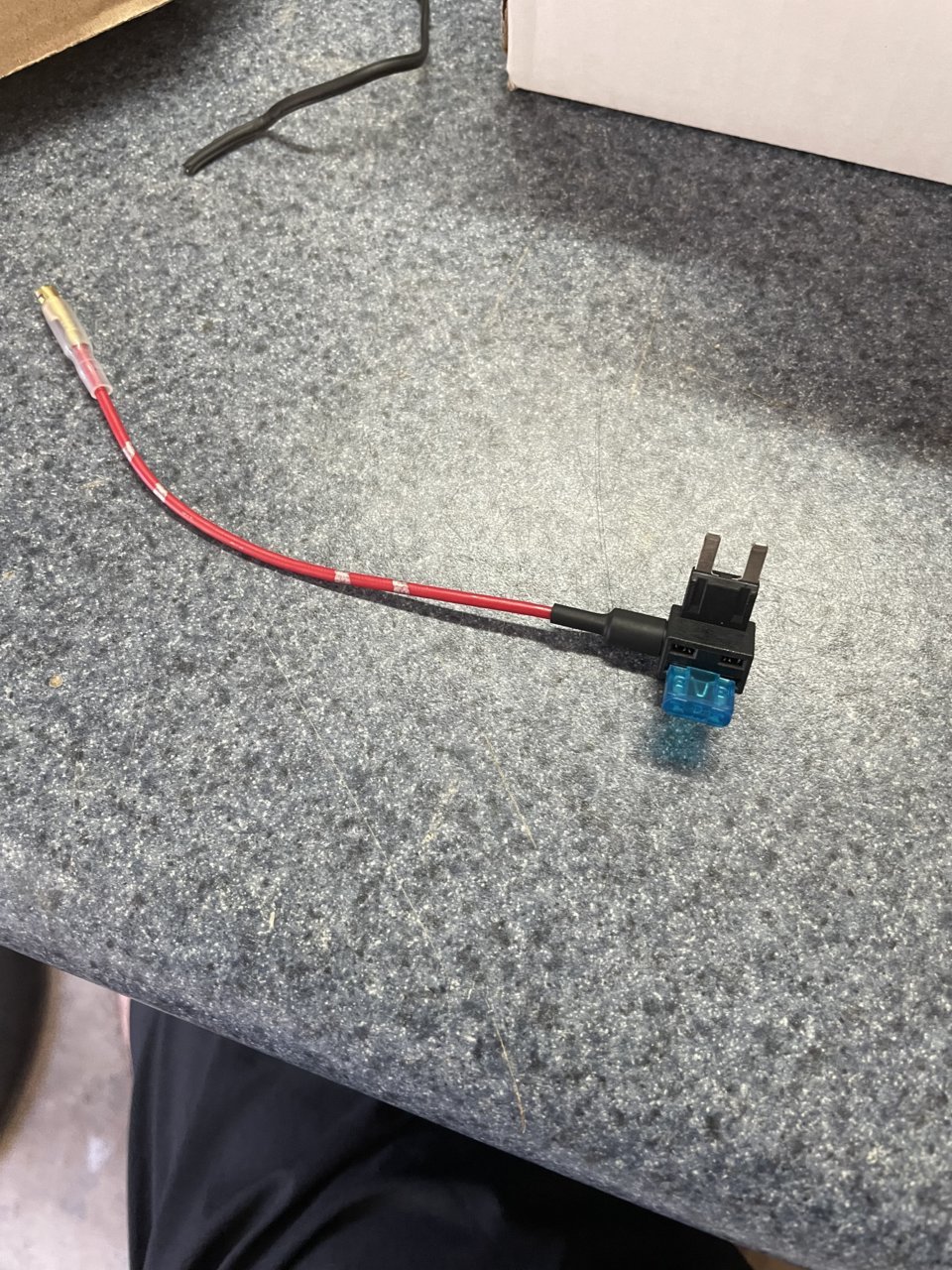

    I got some raptor lights for my 2021 TACOMA TRD SPORT and the add a fuse that came with it has a different fuse connector. Any idea me know what part number and where to get it? The pic is the one I have.

    Auto zone. Take one of your fuses with you. with you. Also YouTube video of Jessie Rico is the way to install. Give it a watch.

    Bussmann ATM Add-a-Circuit Low Profile Fuse Tap

    The "ATM" sized add-a-fuse will work fine with the Tacoma fuse block. The recessed fuses have the same width and connector dimensions. The only one that's really incompatible is if it's "ATO" sized.
