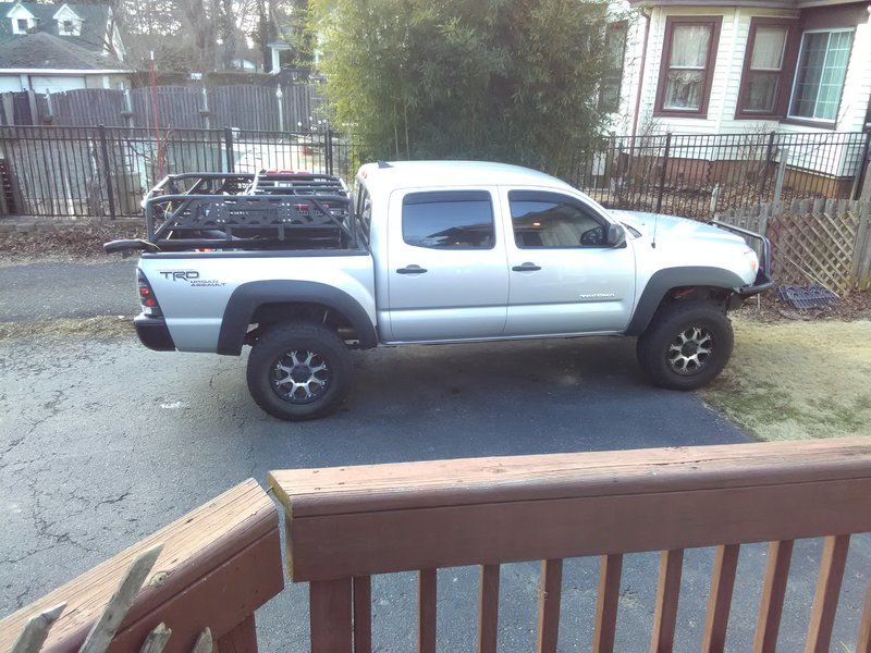

    Just put a level kit on front end. Not sure if I want to put a aal on the rear. Will the front end settle a bit after a few hundred miles?IMG_20170329_182043760_HDR.jpg

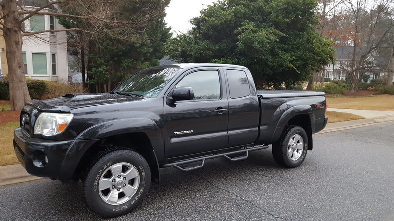

    What did you set the front 5100's at? I started my 2005 Access Cab at the 1.75" settling in front, and it was too high. I installed the Toy-tec rear AAL (just had the new tsb leaf springs installed) and it looked way better! But... Major needle bearing noise at 1.75", so I re-adjusted to .85". Gives me a slight rake still, and levels nicely with weight in the bed or trailer attached. The driver's side needle bearing noise is less noticeable, but still there even at .85. It's only been a few weeks, and I don't drive it much, but it hasn't settled yet. The ride quality is great! However, when I crawl under and move the CV where it goes into the clam shell, I have a lot of play on the drivers side, none on the passenger side. If I end doing the ECGS bearing replacement, I'll go back to 1.75, which actually gave me almost 2.5 inches of lift.

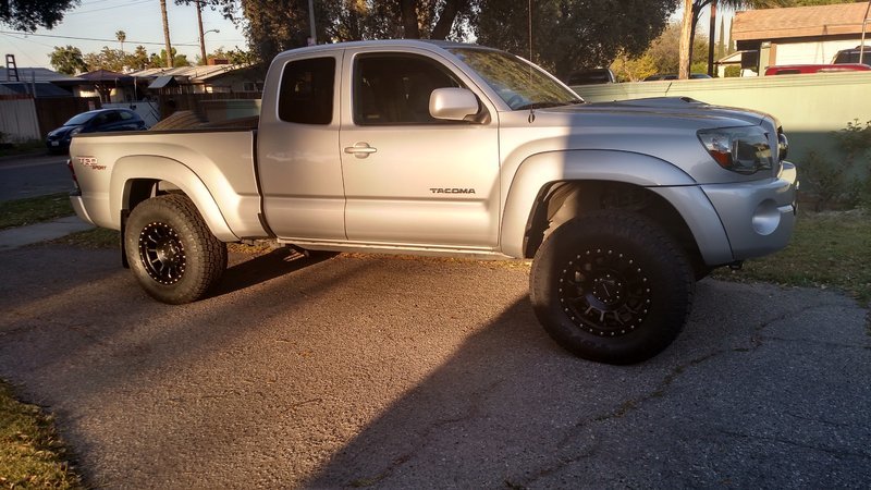

    I did 5100s in the front with ome 885 coils. Set at 0. And 2" aal with shitty pro comp rear shocks going to be upgraded soon. The front end settled a bit. But im level all around.

    Looks great!
