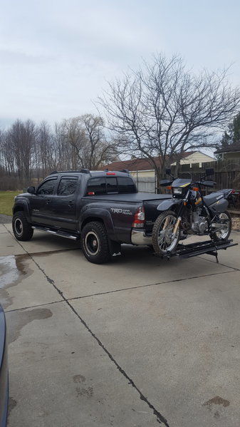

    20170324_134136.jpg I want to add some height to the rear of my truck plus add a leaf to help carry the added weight of the bike. Without the bike it sits level, the bike weighs about 400 pounds and drops the back of the truck about an inch and a half , any suggestions.

    Full leaf pack replacement or bags

    Really? The add a leaf won't handle it??

    I'm getting to tackle doing my AAL in a few weeks. I'd give it a shot, not terribly expensive as it gets to be more money from there on up.

    If you haul it regularly I would definitely replace it with a full pack. Really not much more money.

    I loaded up our family's toon the day after I installed my AAL and it was only for 20 minutes and it sagged so bad after that.

    I've got the deaver 3 leaf overload replacement, part# F85. I'd recommend them if your carrying just the bike and a few other normal bed items. They raise the rear that 1 1/2" that you need
