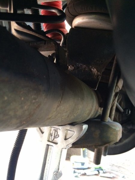

  9. Jul 8, 2015 at 8:35 AM
    David K
    David K Well-Known Member
    Jun 27, 2009
    #18969
    12,407
    Pala Mesa, California
    2010 4WD Off Road DC
    Differential Breather Mod Light Bar: 4 Cree LED lamps Bilstein 5100s Ride Rite Air Bags

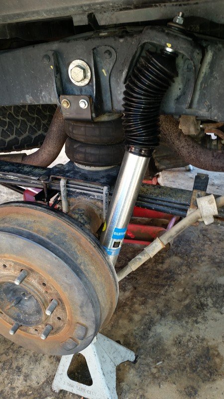

    After 5 1/2 years since being on my last truck, my Ride Rites are now on my newer truck! Instant raise of 3" with just 20 psi in the bags. No more bottoming or sagging!
  10. Jul 8, 2015 at 8:37 AM
    David K
    Jun 27, 2009
    #18969
    12,407
    Installed by Jason 'Speed Freek' in Vista, CA
