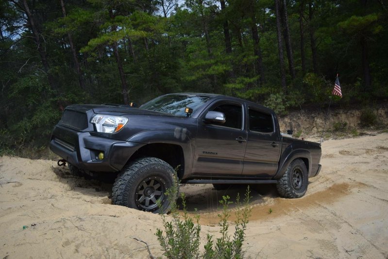

    I had the 2" wheelers AAL and the standard 5100s in the rear. Wheeled plenty of times (even got on three wheels at one point) and it was just fine. IMG_0525.jpg

    Hell yeah on that flag. Are those 285s in the pic?

    Yep! Those are 285/75r16s. They're cooper discoverer MTP's.

    This is my favorite pic that shows the beefy stance.
