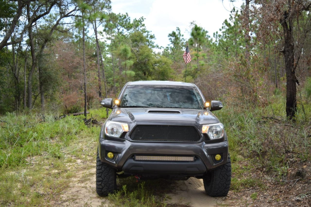

    You'll clear the UCA. You have 4.5" of backspacing, and that's the tried and true number for clearing the UCA. You're going to stick out 2.5" over stock though, so you'll definitely rub the CMC. I had wheels that stuck out 2" over stock, and I did the CMC as mentioned above, hammered the pinch weld and trimmed some plastic with a dremel and was all good. I hammered the pinch weld preemptively, so you could wait and see if you need to do it.
    https://www.tacomaworld.com/threads...lat-with-a-sledge-hammer-lets-discuss.425850/
    What config is your truck? double cab, access cab, 4x2, 4x4?
    EDIT: On the plus side, 285s look sick as hell when there's a little stance. This is sticking out 2" over stock.14311434_10157397892455092_9017729934155_3e803a04451fee4791ce3bc147d5f474d0e2fec3.jpg
