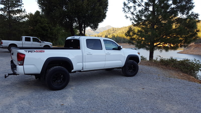

    Anything more than what I have will def look better ! Also this pic is old . I have 6112 set at top notch and Total Chaos UCAs to be installed next week .

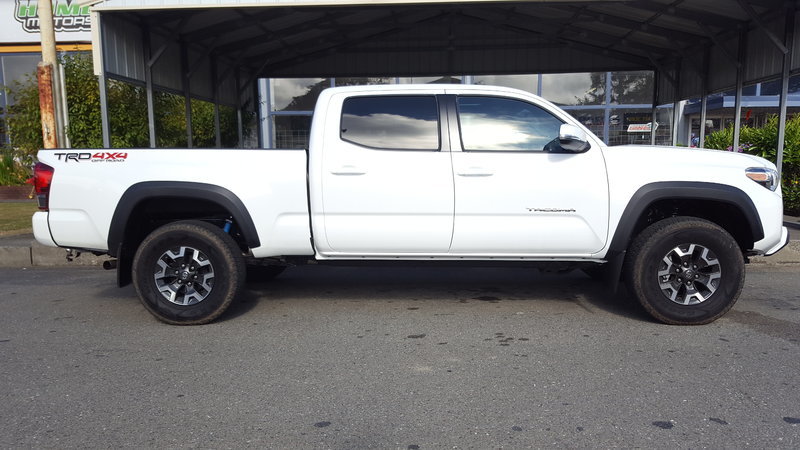

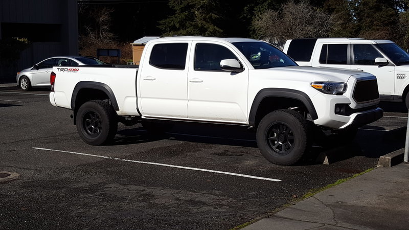

    Bilstein 6112 front, 5100's rear with blocks, camburg UCA, 17" XD's with 285/70/17 AT 3's and a blackout front grille.
    Before and After

    What are all of the components you added/changed? Tire and wheel specs? People are going to ask so...

    Camburg setup from their website. Bilstein 6112's in the front with camburg uni-ball upper control arms, 5100's in the rear. I added a 1.5 inch steel block in the rear but after loading it with weight a few times and just generally driving, I don't like it.
    Wanted 285's but the tire pro shop phucked me on wheels so I had to settle for 265/70/17. I regret using that shop because every time i look at the truck I wish the tires were taller.
    Going to install the 2 inch add a leaf and see how I like it. If it sucks, progressive pack next.
    (photo is when it was on the 4th notch front shocks)
