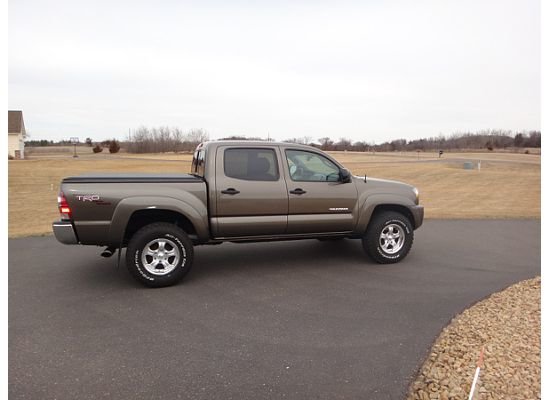

    This is my truck stock with the rear TSB done. didn't notice any difference in the ride(maybe slightly stiffer but not real noticable)

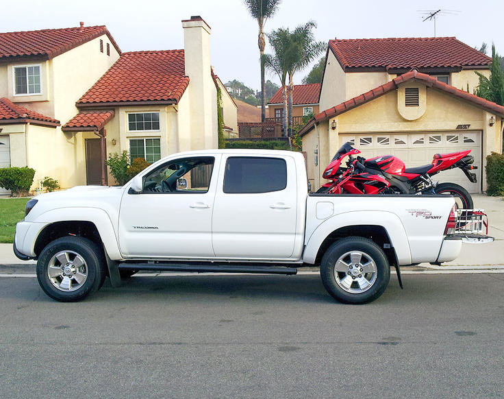

    I told the Service Manager and the Mechanic not to touch my Shock as I already put a Bilstein 5100's on it and all I want is the Leaf Spring, U bolt and Bump stop
    btw prior to this I have no idea about the TSB and bought AAL from toytec and I feel the slight difference with a ride it get a bit stiffer (I mean really tiny bit ) I wonder what's the difference between TSB and AAL
    the guy from toytec told me that even with the TSB if I needed to make the bed more firm that I can added the AAL even after the TSB is done
    on the pic its showing only 1 bike but I normally haul 2 bike

    If you are hauling two bike ---- you will want the tsb and the AAL
    I had hellwig over load springs and they were not enough for a 600 lbs ATV. The TSB only added about 200 lbs more than the stock non TSB springs
