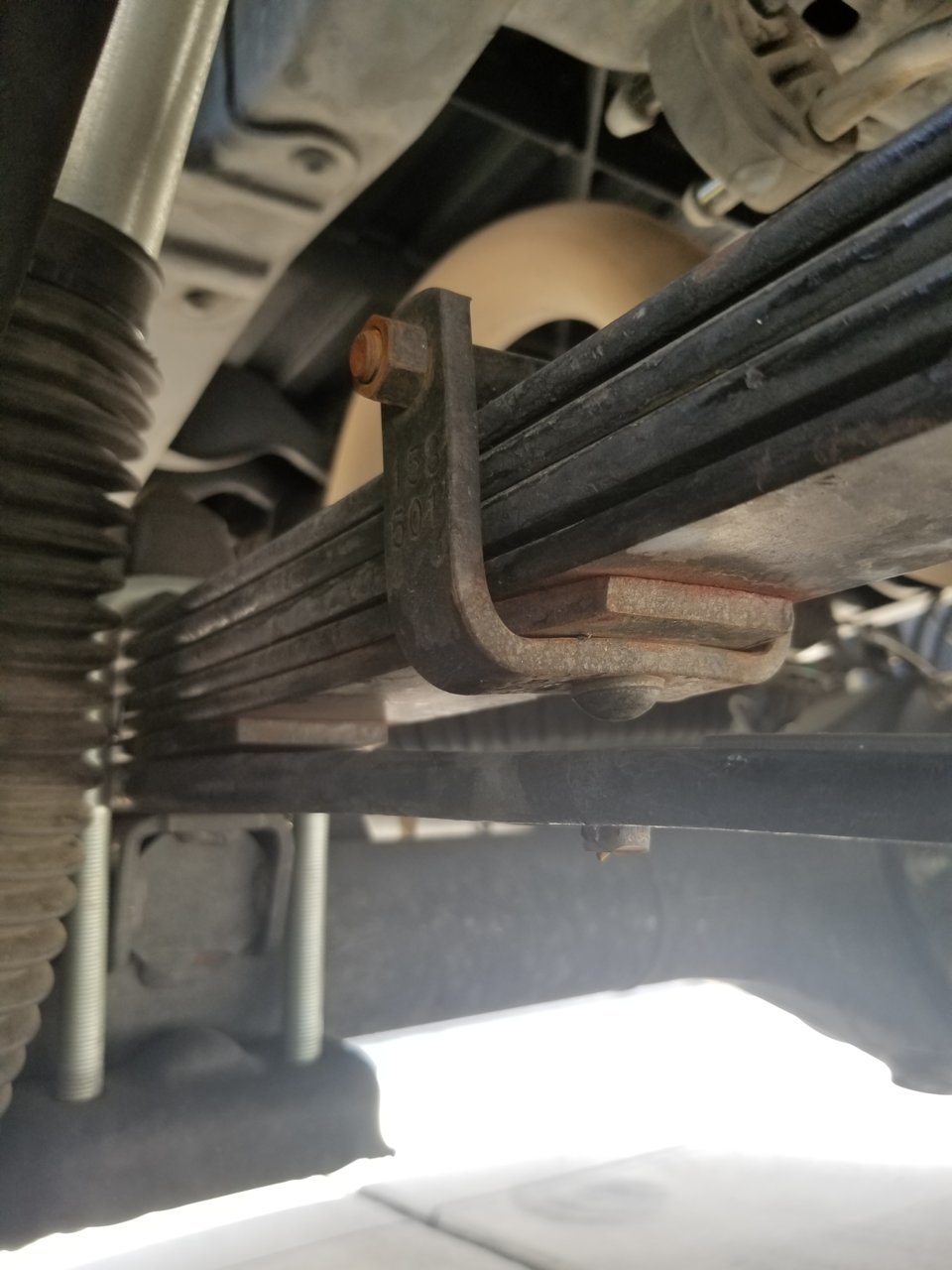

    You dont have yo cut the overload leaf to make it fit. You have to cut off the clamp on the overload in order for it to fit without hitting anything. I just grinded off the bolt holding the clamp and the clamp came off. I have the icon AAL with the over load left in and I love it . Gives it that stock rake. On the picture I included you can see where the old clamp was held on and was not allowing the new clamp to sit flush.
