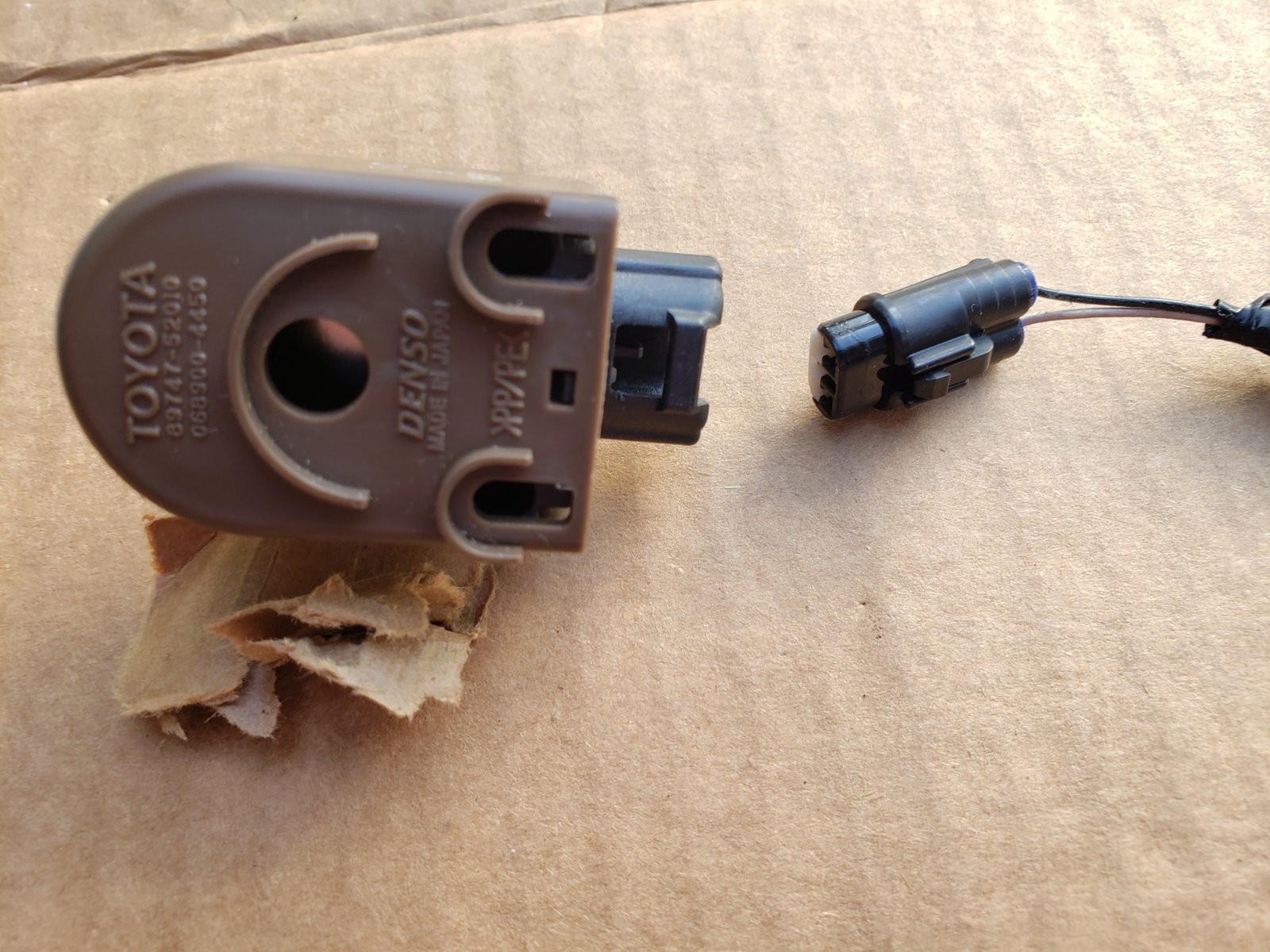

    Salvage vehicle parts included BSM Sensors 88162-04015 and CTA sounder 89747-52010.

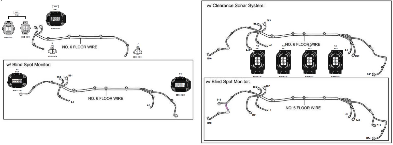

    The project was intended to look and perform as OEM. Therefore, necessary terminals w/wiring were added to connector EB5 in the engine bay junction box (EBJB) and connectors BE1 and BE2 at the rear bumper harness (RBH) connections.
    The rear bumper harness was identified by examining another vehicle on the dealer lot at the time of the SR5 purchase. Using the harness (Toyota, $138.) saved significant time identifying, purchasing and assembling connectors.

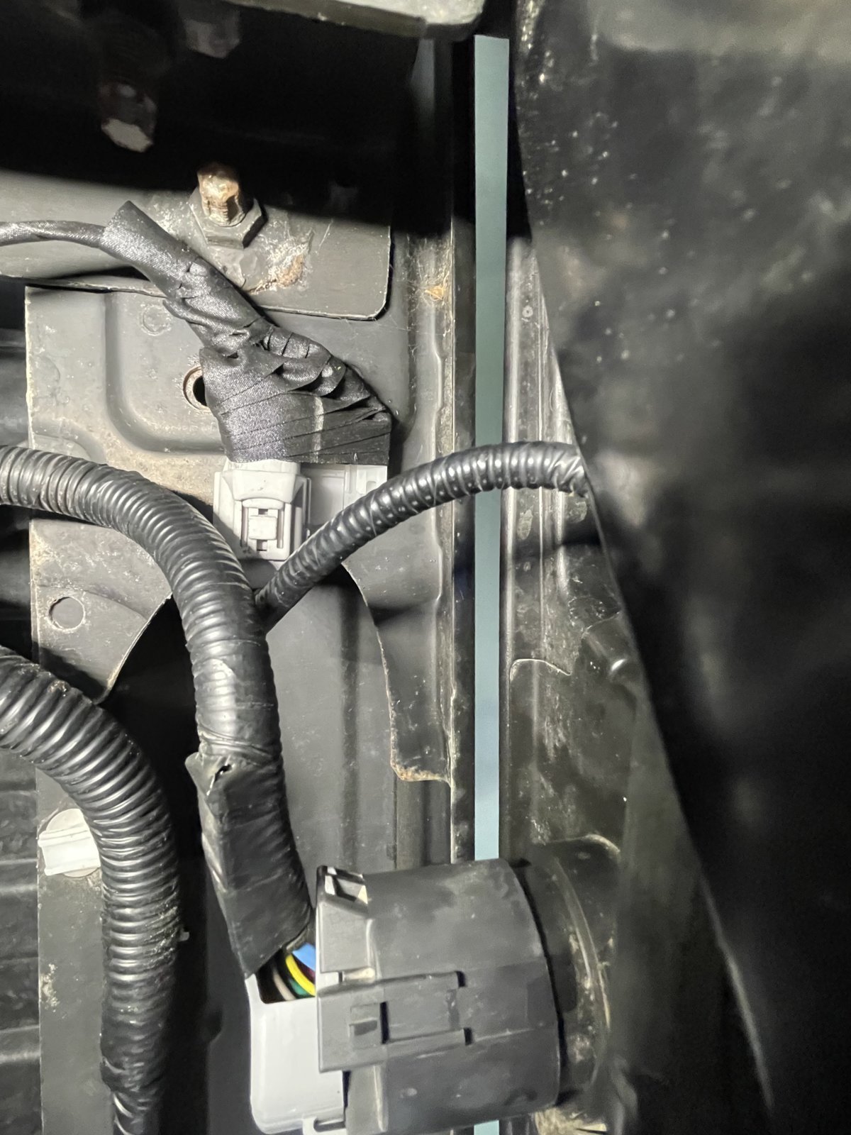

    A custom wiring harness between the EBJB and the RBH is approximately 18-1/2 feet of wire in 17 feet of plastic loom. Assembly was accomplished by stretching 11 wires between anchor points. Four of the wires make two twisted pairs for a CAN communication loop. The plastic loom is snapped over the taut wires and black electrical tape used to secure closure every 12 inches.
    Exact wire length required for mating with BE1 and BE2 connectors are cut and appropriate terminals added with the harness/loom on the work bench.
    The harness is routed rear to front adjacent to the main wire harness, but not secured.

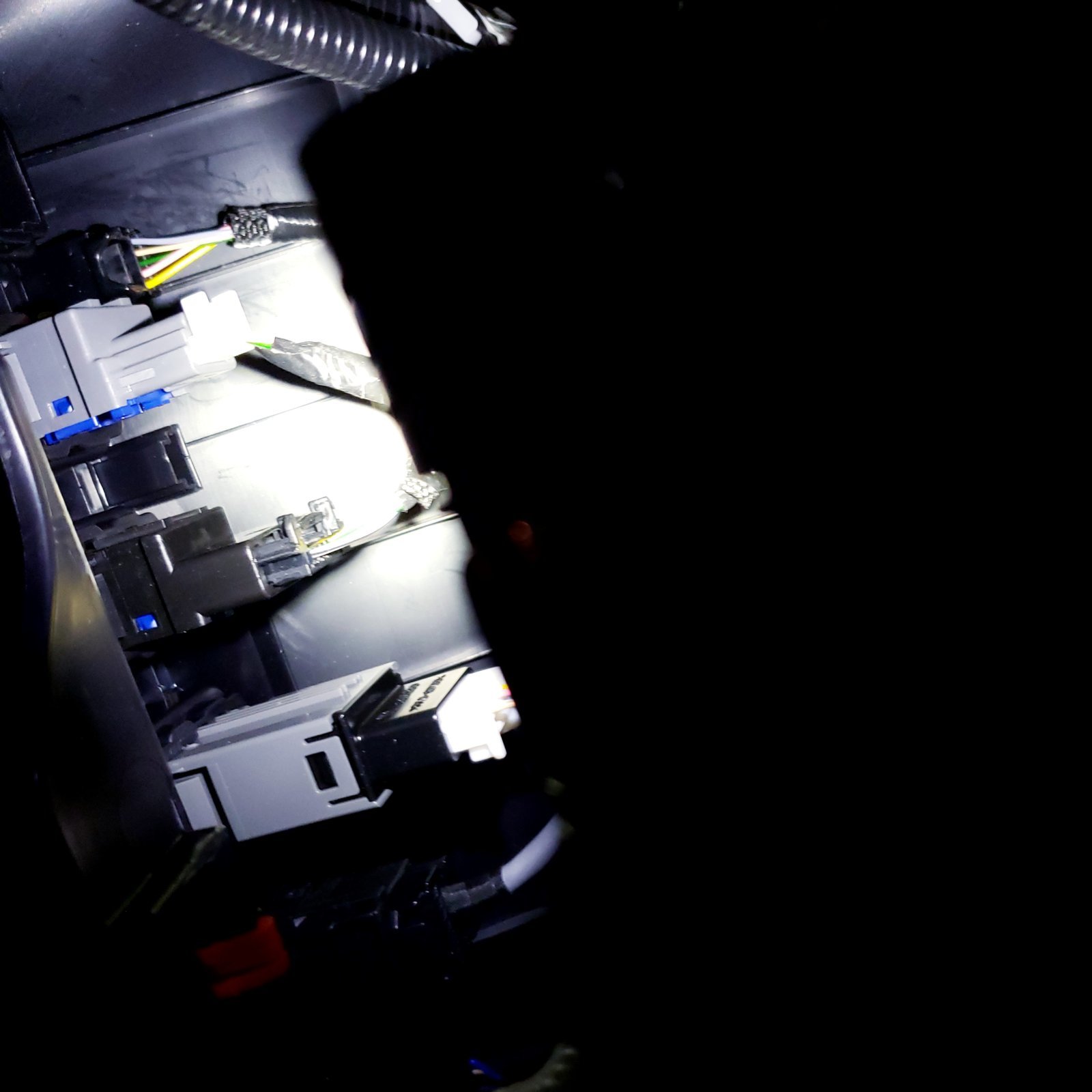

    Terminals, previously attached, are inserted into the existing connectors after removing seal plugs.
    The new wire harness is drawn out and secured to the main harness using plastic wire ties.
    At the rise under the EBJB, locate the new harness on the back of existing, away from the hot engine.

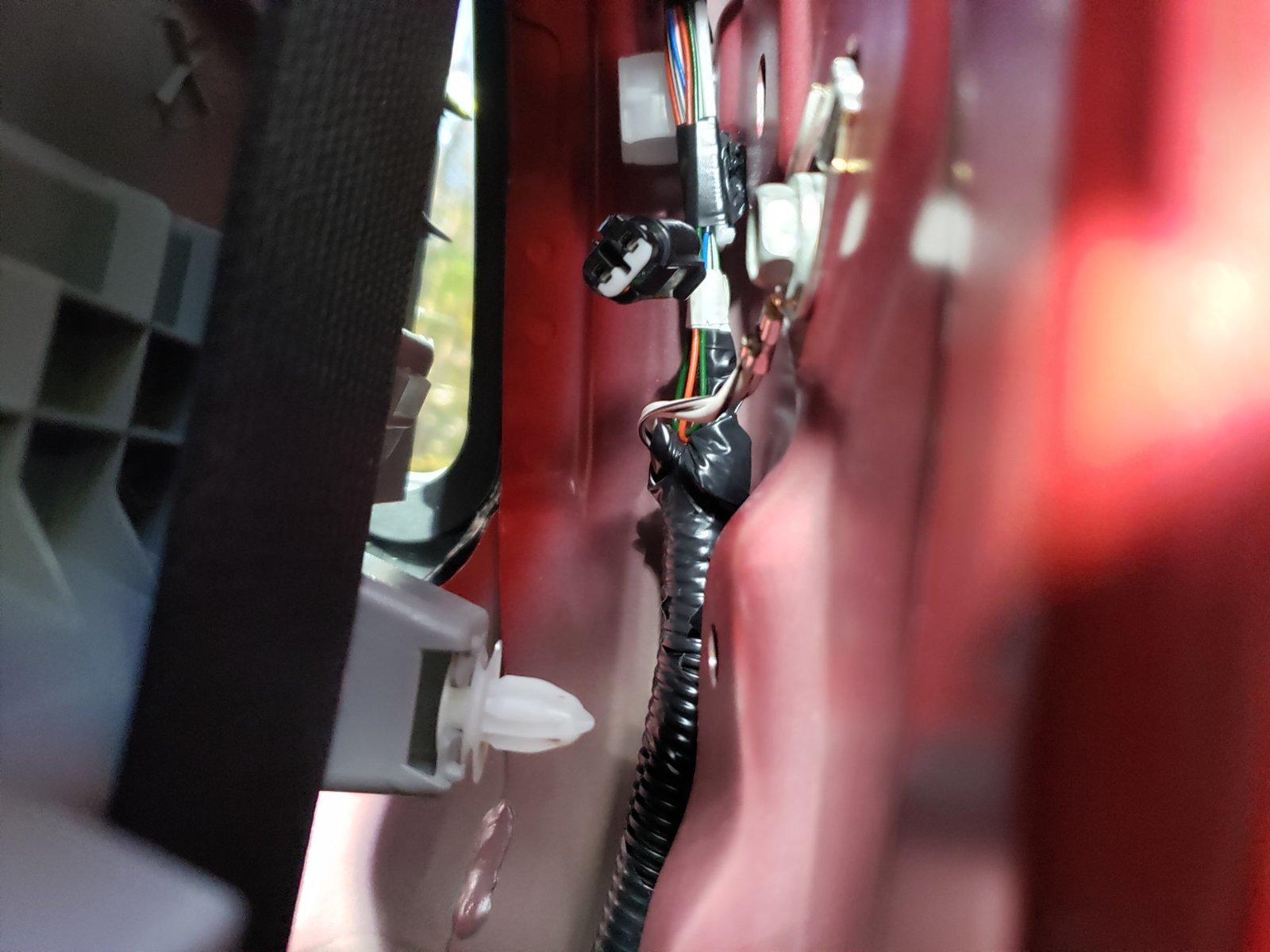

    Open (not remove) rear cab trim and install CTA sounder to existing wire and secure to body. Reattach rear cab trim panels.

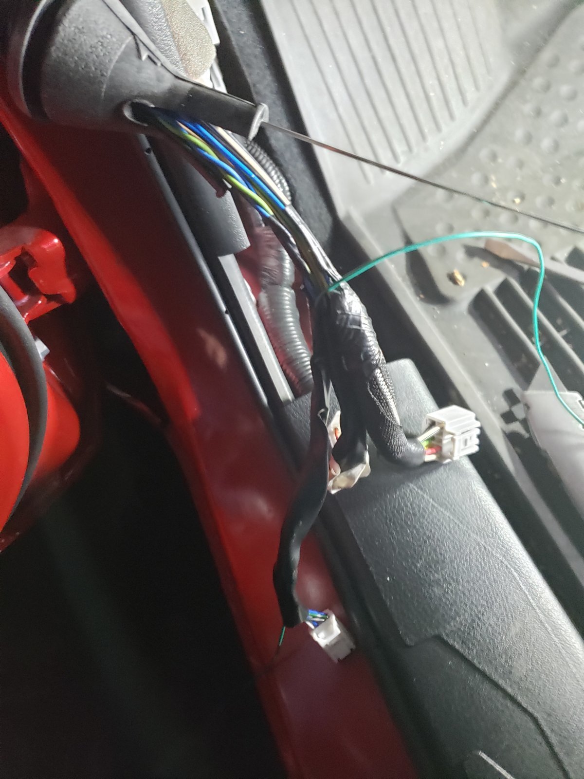

    Add green or blue wire from mirror connector (door/harness side), route through flex conduit to appropriate connector behind kick panel.

    Note2: CAN wiring shown in the BSM wiring diagram is incomplete. A CAN loop is required. Refer to the CAN MPX wiring diagram.

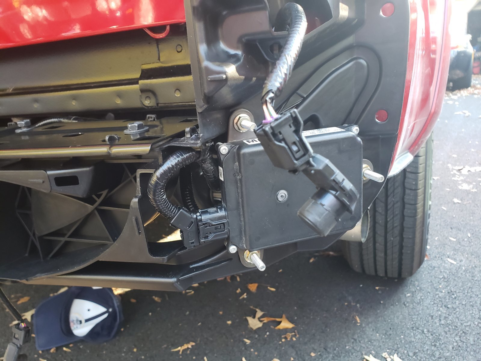

    BSM on RHS
    BSM switch-at top, location for unused plug on other side of gray connector
    (Front of dash is on left, we are looking down from radio/display)

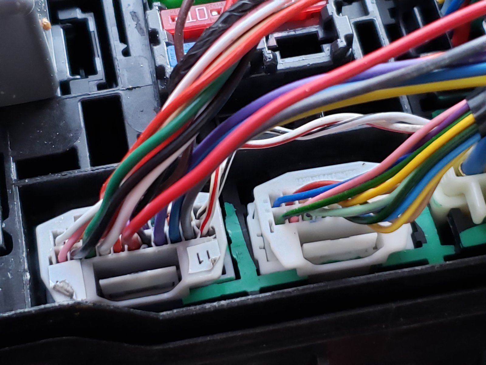

    EB5 with BSM added in EBJB
    Sounder CTA existing plug-wire.jpgCTA Sounder location - unused plug awaits!
    CTA sounder

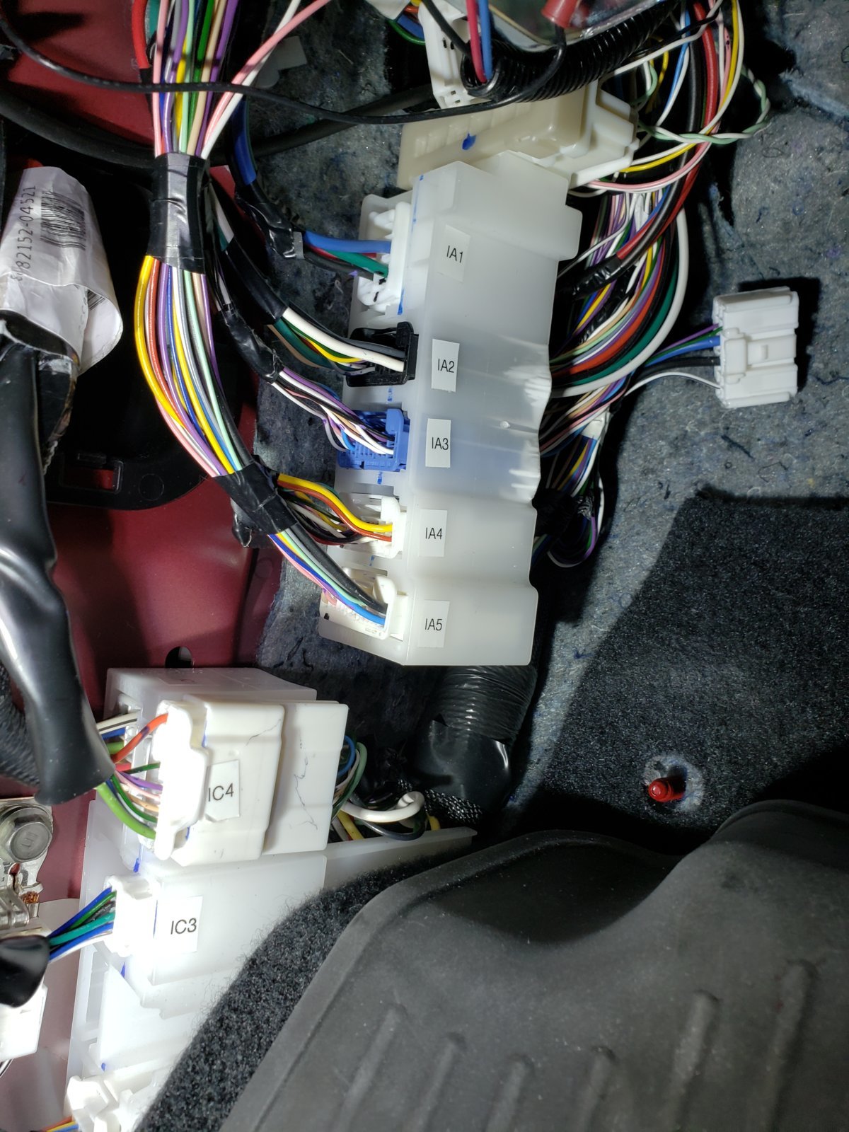

    Add wire to mirror BSM indicator!
    Indicator wite to IC3.jpg Green wire for BSM indicator added to IC3.

    I do not understand the "CAN loop" statement. In the multiplex/CAN schematic, as well as the BSM schematic I can only find the Vehicle CAN going to the Left BSM module and then the data connection between the two BSM units on pins 1&6 in a Series connection; whether this is CAN or not, I suspect but am not positive. Was the CAN necessary for the BSM to properly work? Also if you did try it without CAN what were the difficulties? I am only trying to understand the vehicle, or rather the thinking of the Toyota engineers.
    Have attached the MUX schematic I have.

    CAN works at radio frequency. It is subject to RADAR-like reflections within the wire.
    A CAN bus is usually seen as a pair of wires, one high and one low. In practice, they are twisted to negate outside interference.
    The CAN bus may be quite long and requires resistors at each end to dampen reflections.
    Control modules are connected to the bus by branches. The branches are required to be short, usually 18" or less, to avoid reflections.
    Since the CAN bus for the BSM is located in the engine compartment junction box (ECJB), the "branch" to the BSM would be 18 feet long.
    The reflections resulting from the 18Ft branch would be seen as messages and drive the CAN network crazy.
    Toyota's solution is to "loop" the CAN bus from the ECJB to the bumper harness and back to the ECJB. The branch to the BSM module can then be about 18 inches.
    Connection between the BSM modules is a separate bus, may be CAN but I suspect that it is LIN.
    Print and splice the multiplex diagram for easier viewing. The BSM diagram merges the loop and branch, which is misleading.
    The multiplex diagram features the multiplex module.
    Toyota uses the multiplex module to create different CAN buses, another technique to avoid reflections.

    I am familiar with CAN, a past vehicle (GM) did just what you describe with the length issue. They routed the CAN to each module directly and then back out, if you removed a module it broke the CAN circuit, i.e. nothing much worked. If one wished to eliminate an entertainment or monitoring module you had to jumper the CAN Bus at the module connector to continue the circuit to the remaining modules. Not to mention that all modules were inventoried by a master module and if one were missing errors would set.
    I forgot to mention I thought it was great you mentioned that the CAN wires should be twisted. The CAN Bus is “differential amplifier” based, only what is different on the two wires is amplified and the rest (noise) is suppressed by the diff amp. They are twisted so any outside noise is equally impressed upon both wires and can be cancelled out by the diff amps. A very popular application was the original telephone wires which can run for miles operates on the same principle and picked up much noise in their journey to your house or business.
    I’m guessing here, but it looks like J20 is the CAN junction I now remember seeing at the rear of the vehicle you are referring to. There is one like it I have seen just in front of the battery and behind the driver’s headlight.
    The LIN circuits on this vehicle is one wire, the LIN circuits I have explored a bit are the alternator and the window controls.

    Yes. J20 is a CAN junction. I did not add a J connector adjacent to the bumper harness. Rather, I added the twisted pairs to the BE connector, saving a crimped connector.
    The decision was to avoid a potential point of reflection.
    EB5: The subject CAN bus is present both ends of the EB5 connector on pins #1/#12 and #11/#22.
    I lifted pins #11/#22 and added them to a new connector I call EB5A. Two additional wires from EB5A land on the original EB5 locations.
    EB5A provides a break in the existing can bus to allow extension the loop to the rear bumper.
    The loop (two twisted pairs) from the BSM go to EB5A to complete the CAN loop.
    The GM system designer could do as he wished using CAN but the description sounds a bit like a token ring.
    LIN may use a dedicated ground. But that was a guess. Inter BS module comm may be a dedicated CAN bus. Don't know for sure.
    Do you know the character of the wheel speed sensors? A typical variable reluctor, magnetic pickup increases voltage and frequency simultaneously with speed.
    Can you confirm the maximum volts and frequency? Typical output would be helpful.

    Update to add BSM wiring pin-out for EB5 and BE2.
    Attached.

    I am brand new to the world of Tacomas. My son has a 21 3rd gen. I honestly am not sure whether it is an SR or SR5 but I was looking into adding some of this tech for him. Odd he has things like LDA and collision avoidance along with Radar Cruise, but not parking assist or BSM. I really would like to add park assist and have found the part numbers for the modules but the harness is confusing me. If I look under the back of his truck, there is no BE1 connector. I find it hard to believe Toyota would have different harnesses for different trims lines. I am a long time Ford truck person and I know they put the same harness if all of their trucks regardless of finished trim line. But maybe just the way it is....

    Sorry for the late response ... just saw your post.
    Apparently, all 3rd Gen Tacos have "safety features" LDA and collision avoidance along with Radar Cruise.
    You are correct: Toyota saves a ton of wire by customizing wiring harnesses for every conceivable accessory variation.
    Actually, I think that the variations are part of the Toyota marketing strategy to make the post-factory addition of OEM options as difficult as possible.
    Your photo of the SR bumper harness is revealing. No BE1 connector and bare minimum wiring to BE2.
    The easiest way to retrofit OEM rear parking sensors and BSM/CTA to an SR would be to obtain the wiring harness from a high option Taco salvage vehicle.
    That would include EB5 in the engine bay to and including the rear bumper harness.
    Alternatively, you can make a supplemental harness (about 14 wires in plastic loom), add terminals and BE1 connector.
    Also, purchase the rear bumper harness from the same salvage vehicle or fabricate.
