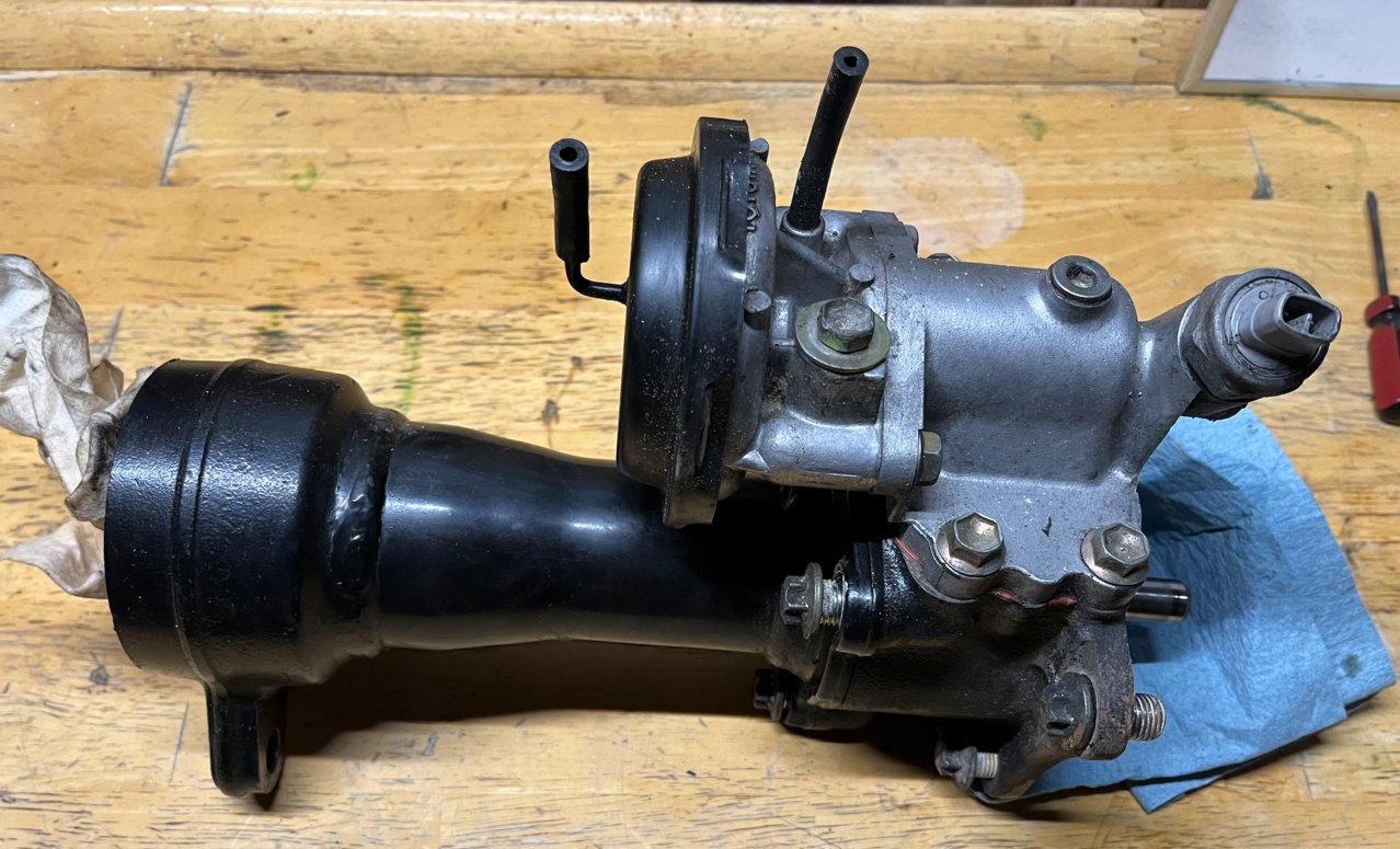

    Real simple question perhaps .
    Is the vacuum operated actuator in a 99 front axle the same physical size as newer(2004) Electric Actuator ?
    That it would bolt right in to the older axle. The design of the newer axle completely different ?
    I don`t have the electric one in hand to compare .
    That is all I need to know the rest I can work around
    Another Gratis project for my neighbor Prerunner 4x4 conversion the seller has given up on after sourcing parts from many different unknown years.

    I just need to know the physical differences between the vacuum and the electrical ADD actuators.
    Can they be switched just the actuator or does the whole differential assembly need changed?
    I have a front ADD differential out of a 1999 Tacoma the vacuum operated actuator was smashed .
    Will the Electric ADD be a bolt on Option to the 1999 differential??

    It's less Tacoma and more mod
    They bolt in place of one another I believe. I have a vacuum actuator assembly on the bench at home right now, I will take a picture of the mounting side for you later if you'd like

    Okay, I asked because I'm pretty sure the entirety of #2 is swappable (I've read of people swapping out actuators for manual tubes) but I'm not sure if you can mix the sub-components of #2 between vacuum and electric.
    I think I have an electric actuator/tube assembly at home. I can grab measurements of pics later if they'll help.

    A few days late I got around to checking this and realized... I think the actuator I have is actually vacuum?
    I assumed that the electrical connector meant electronic ADD and the two tubes were just breathers, but now I'm thinking they're vacuum lines.

    Yep, that is a vac actuator. I believe I have an e-actuator as well as the vac. I'll check for it tomorrow. Need to pull down a box of leftover mixed up stuff from the conversion to check. More to follow.
