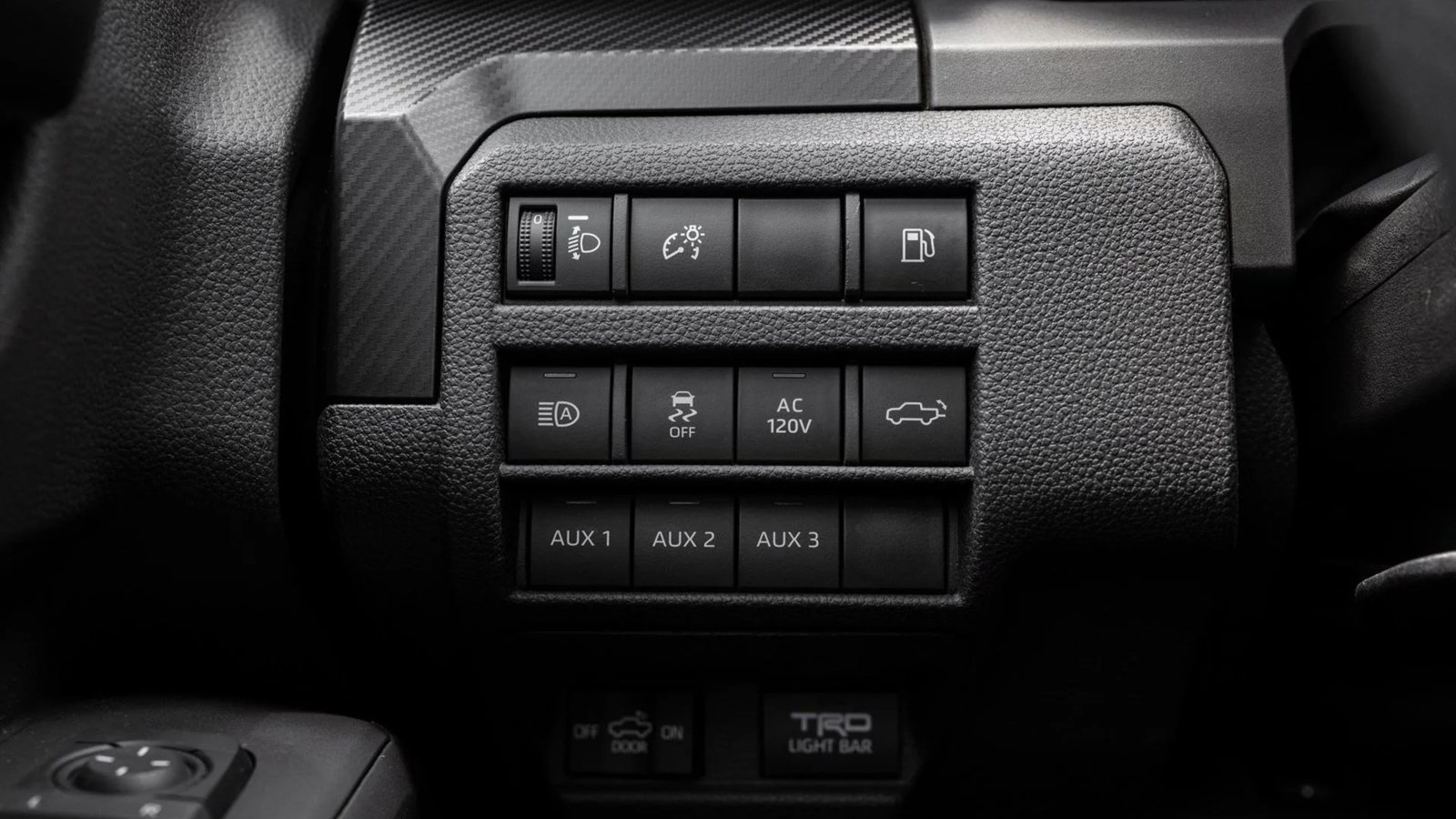

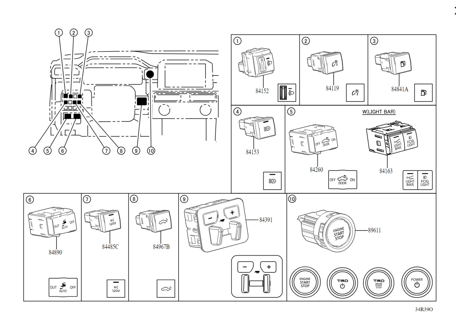

    On my poverty edition 2024, Toyota omits the 3 Aux switches but leaves the wiring harness in place.
    I have dug through the parts catalog trying to find the part number to order these. It doesn't seem to exist. I can find the switch cover blank, but not the switch. I have changed trims as well to see if it shows up.
    Does anyone know the part number of these and the corresponding pigtails needed at the business end of the wiring harness?
    For reference, Aux 1-Aux 3 in the attached pic.

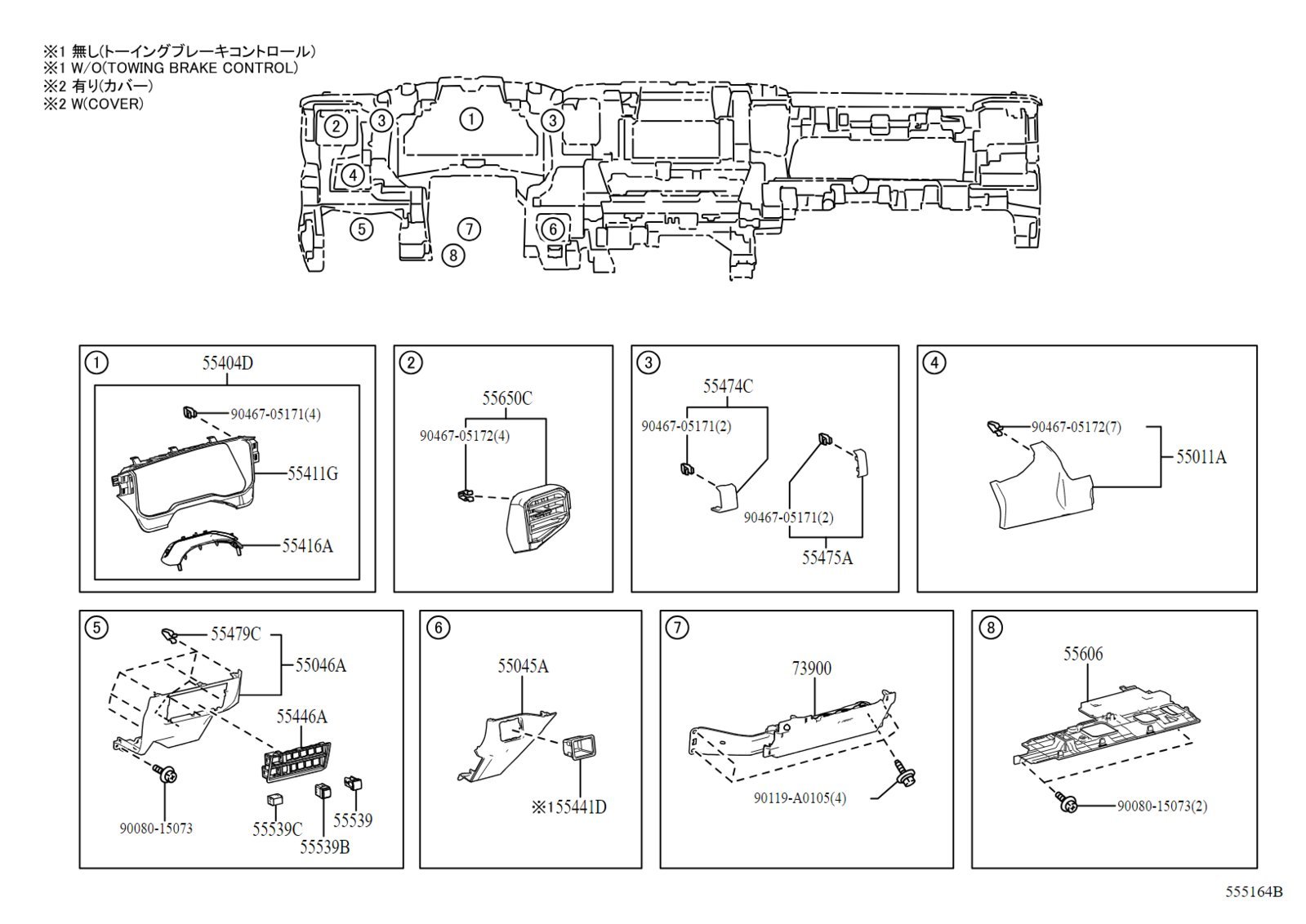

    There's no rhyme or reason how parts are sorted on the Toyota website. I've gotten as close as I can. Perhaps this will help if someone else is looking for these parts so they don't duplicate the work unnecessarily. In box 5, the components look to be parts labelled 55539.
    It *might* be any of the following:
    Spare Switch Hole Cover 55539-0C220-C0
    Cover, Spare Switch Hole 55539-12130-A1 or 55539-20020-B5
    I found this in Home / Parts / Body / Instrument Panel & Glove Compartment
    and
    Home / Parts / Body / Console Box & Bracket
    This is on autoparts.toyota.com. It looks like the price will be somewhere around $100 for the switches, which is far too rich for me, estimating what other identical switches cost in the diagrams below.

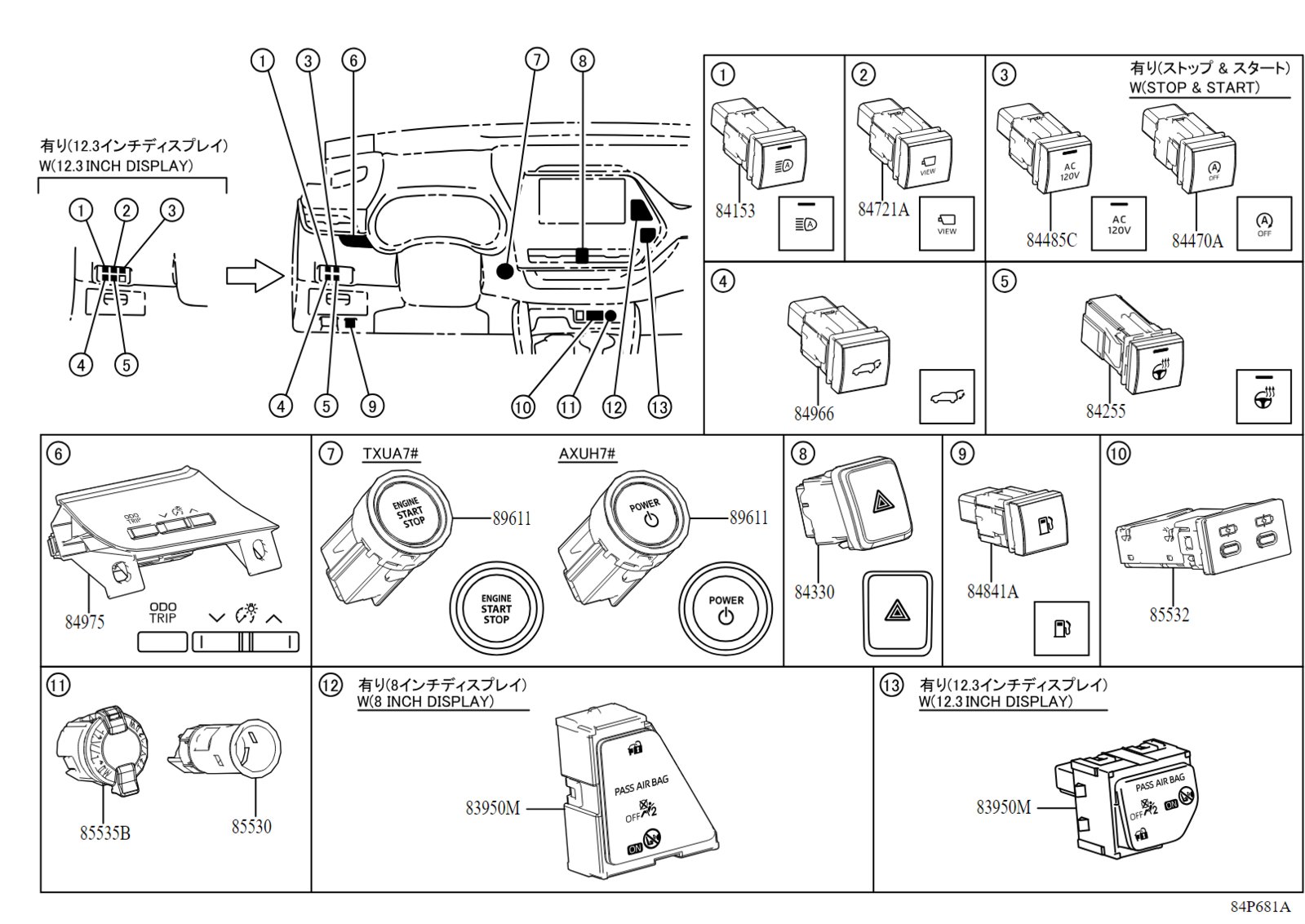

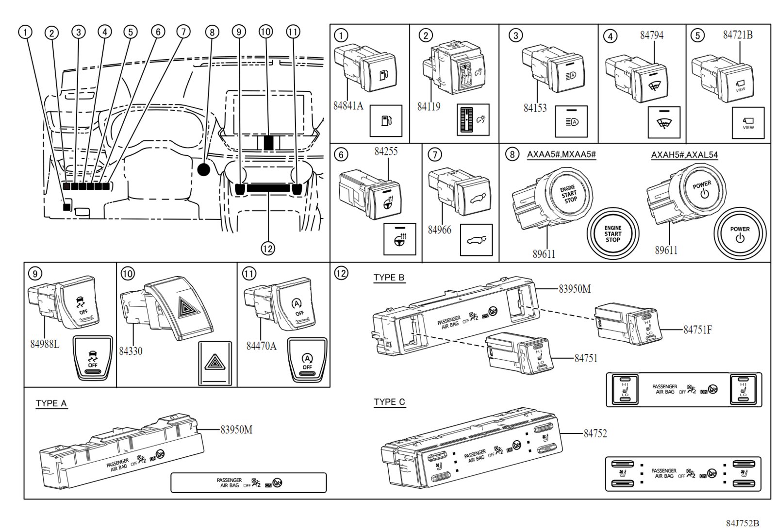

    Here's some other interesting parts for people who want OEM switches or mods. This is in
    Home / Parts / Electrical / Switch & Relay & Computerupload_2024-7-27_14-18-26.png

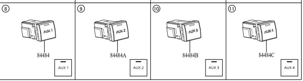

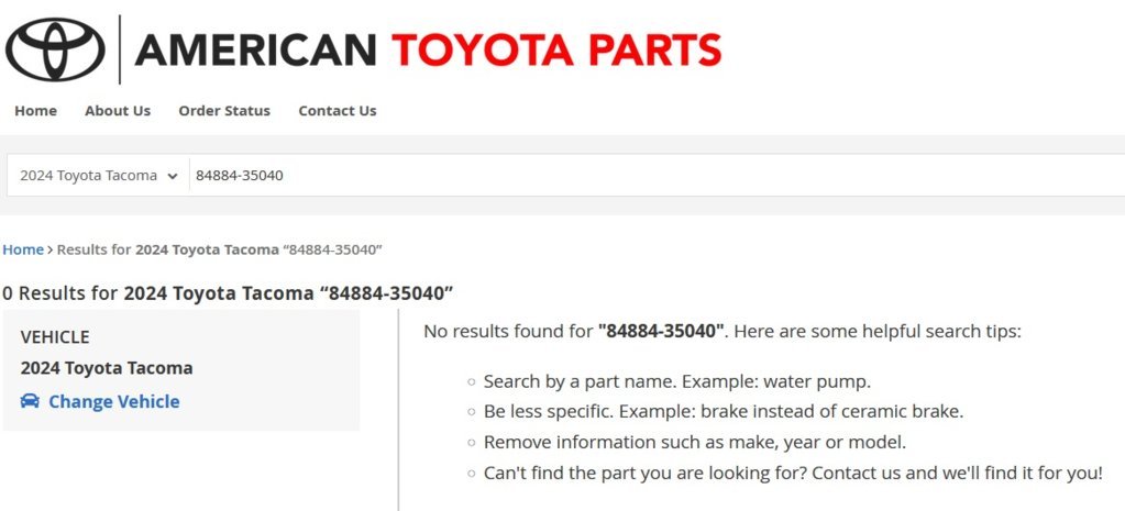

    AUX1: 84884-35010
    AUX2: 84884-35020
    AUX3: 84884-35030
    AUX4: 84884-35040
    AUX?: 84884-AK040

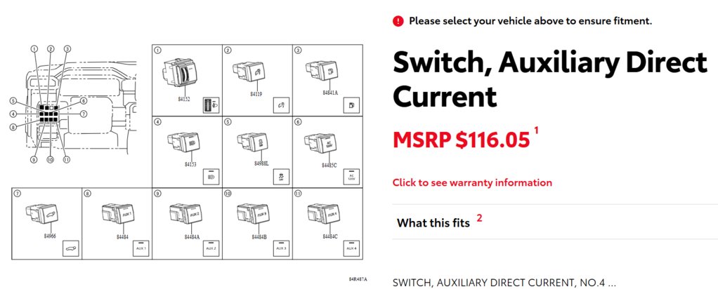

    Or just get switches from cali raised for $15 each vs $360+ for 3 switches....

    Interesting. I ran all the numbers through my dealer and they are not good numbers. This is the third part number I've checked and it doesn't come up.
