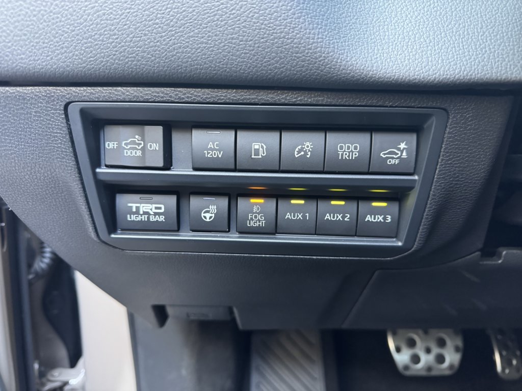

    AUX1: 88485-AK010
    AUX2: 88485-AK020
    AUX3: 88485-AK030
    Bucci and Vitamins[OP] like this.

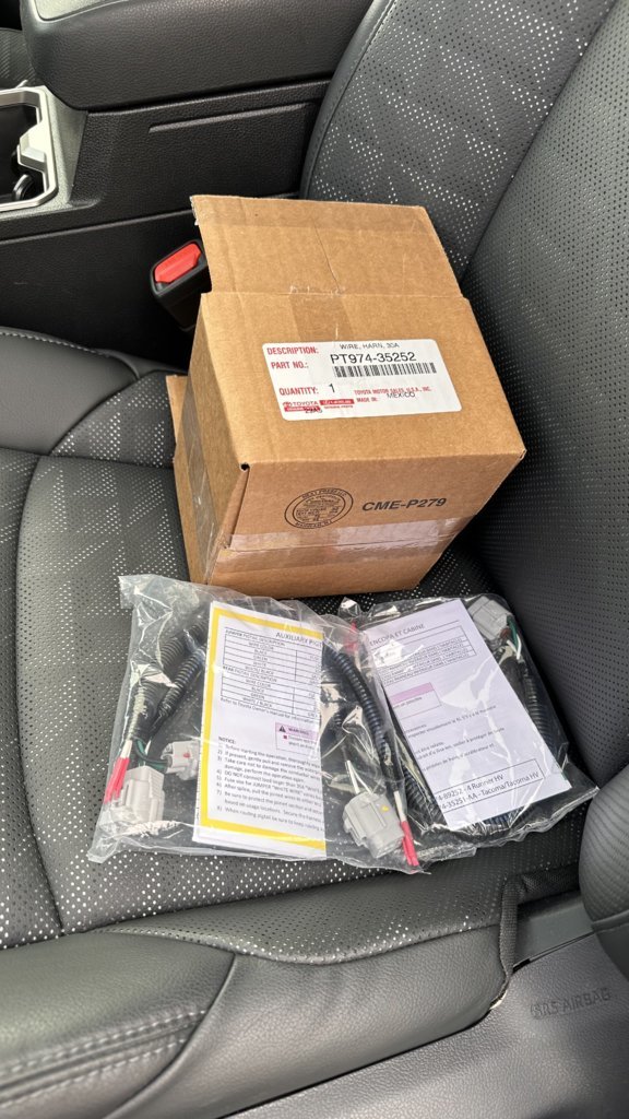

    These were in my backseat after I purchased my truck. Was wondering what these were used for.

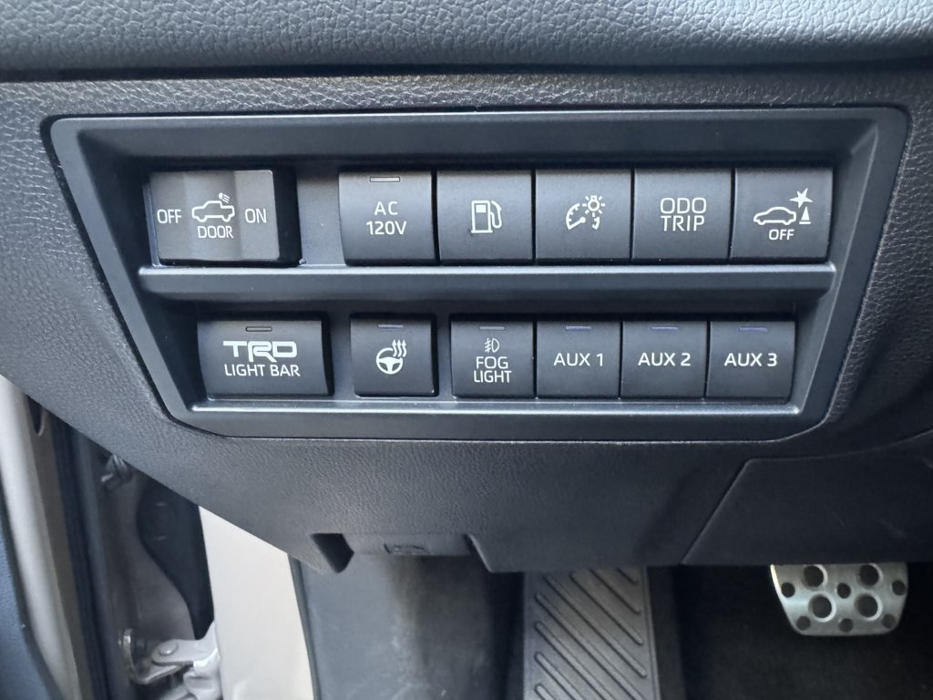

    Added an LC OEM fog switch
    sudobash and Yoda's TRD like this.

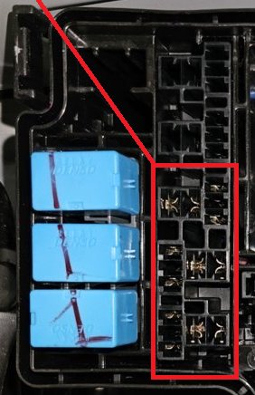

    I wasn't able to find the wiring in the engine bay, nor the 4th one under the bed. Can you please confirm you had wiring all the way to the engine bay, near the fluid reservoir?
    Would be nice if it were as simple as adding the switches and buying the pigtails.

    Did you see this? (empty relay spots but with relay terminals ready?)

    Reviving this thread as i was curious this morning and checked my 2025 sr5 4x4 without aux switches. I have the fuse block terminals that have relay terminals, and i have the engine bay connectors, but i dont have the cabin kick panel connector nor the under bed connector at the rear. Im going to play dumb at the dealer today to see if i can find anything out.. Seems kind of strange to have it set up in the front with no way to connect them anywhere else.
