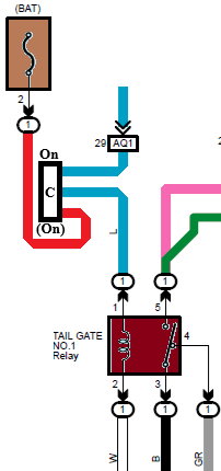

  5. May 8, 2025 at 12:39 PM
    #25
    caribe makaira
    caribe makaira Well-Known Member
    Feb 13, 2011
    #51121
    11,733
    Caribbean, Puerto Rico
    05 PreRunner TRD Offroad AutoTrans
    Hood Struts, My version Fogs always ON, Map & Overhead Light Mod,
    My post would work for your needs: battery (source) not ignition, fuse- momentary switch to 29 pin on AQ1.
    Kinda can't visualize the access to switch while doors are locked though.
    TacoTuesdai[OP] likes this.

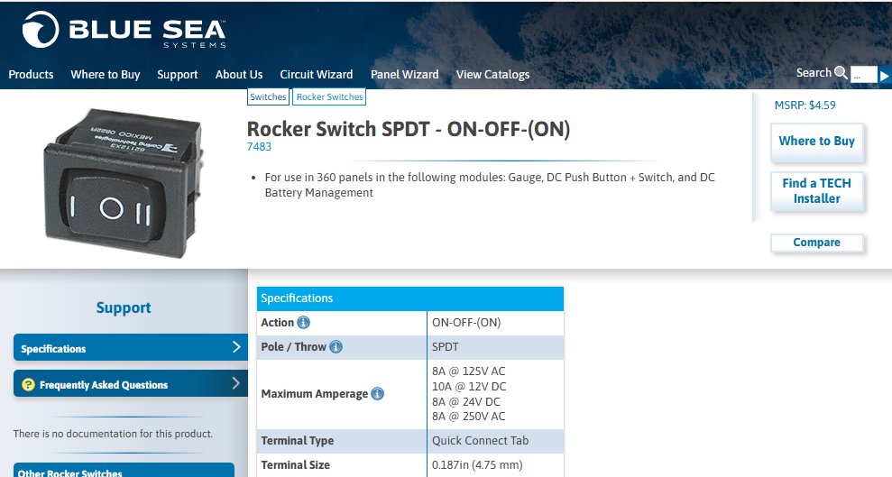

  6. May 8, 2025 at 8:47 PM
    #26
    caribe makaira
    Feb 13, 2011
    #51121
    11,733
    SPDT switch, On side to maintain OEM function, (ON) Momentary to actuated tailgate unlock. And also an OFF feature.
