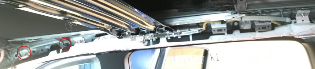

    ^A look at the roof structure with the headliner removed: https://www.tacomaworld.com/posts/15503347
    You can poke holes in the headliner and install a strap handle using these two bolt holes highlighted. One highlighted bolt is actually used to hang the curtain airbag above the door. You'll need to add spacers and use longer bolts to avoid pinching the headliner. As the bolts are above the airbag, I'm 70% certain attaching a handle to them will not materially affect curtain airbag deployment. :D

    That's very interesting! That's the best (only actually although there must be others...) pic I have seen. Still would be good to have a better view of where the airbag is. Maybe I don't know what I am looking at and it is there. Would be great to have the location of the sockets so I could punch the holes in the headliner without having to remove the whole thing first.
