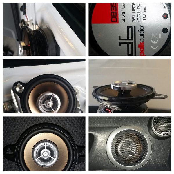

    2015-08-21 10.32.36.jpg Install went good. Used the old tweeter wires but found out those wires have a stock bass blocker wired in and I wanted full range for these 3.5" since i installed tweeters. So I tapped in to the 6x9 wires.
    Thanks for the idea.

    How much if any modifying needs to be done to the factory tweeter bracket

    No modifying. I could only use 1 oem bolt to attach. It is secure along with the pressure of the door panel. Gives me a very clean sound. Replacing the 6x9's are my next project.

    So wait is the magnet stuck to the door? I would think this would cause problems.

    Yes it is. Never had problems with that issue. Sounds great.
