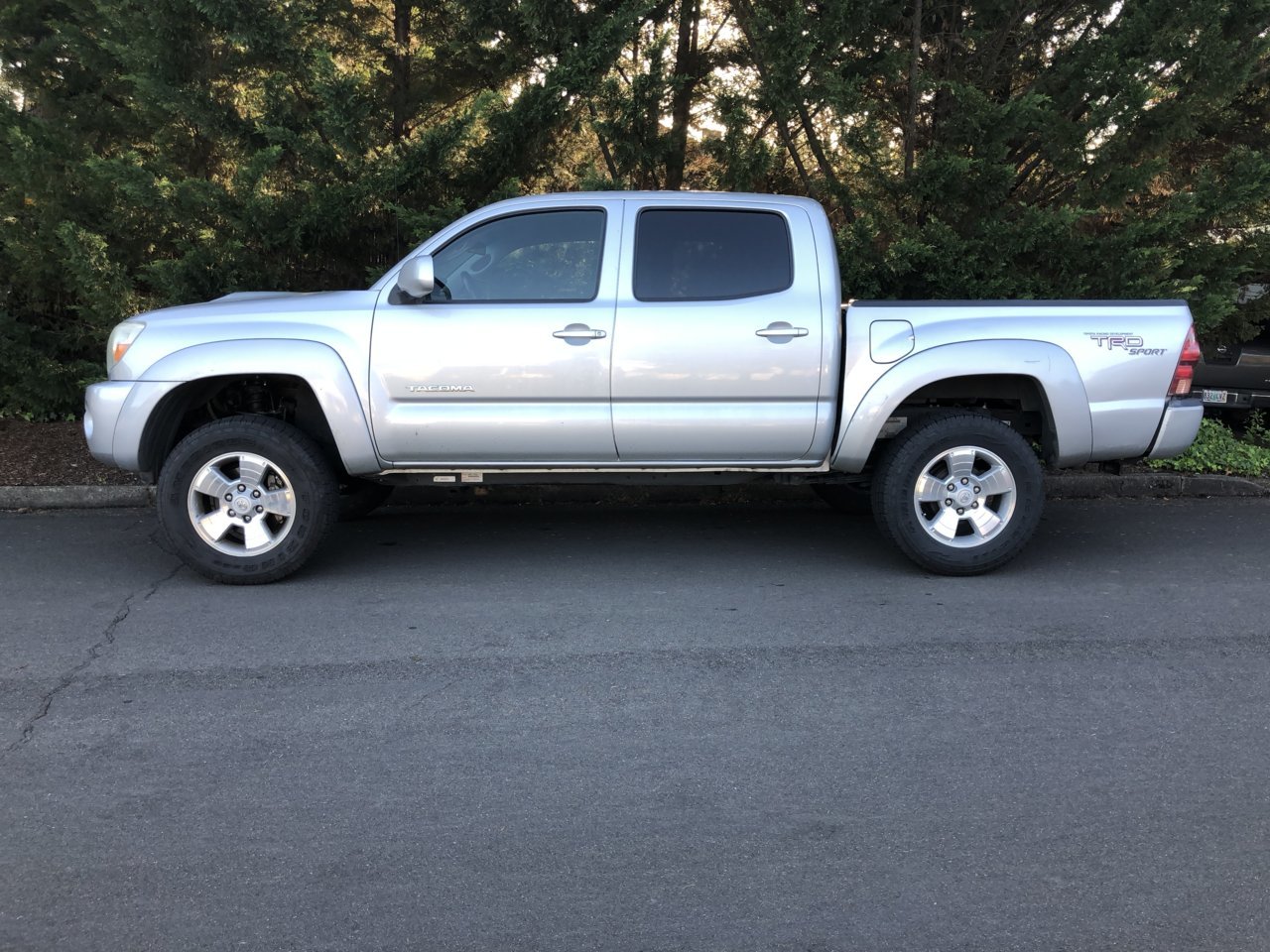

    I just bumped my 5100 up to the 1.75 setting after having the frame replaced. The rear leafs are a different model than the tsb parts. It sat almost level with the shocks at stock height. Thinking I should add a 1.5 aal to get the back up to match the front. What do you think?
    FYI. Later this week I will be putting Ray 10 on with 265/75r16 wildpeaks.
