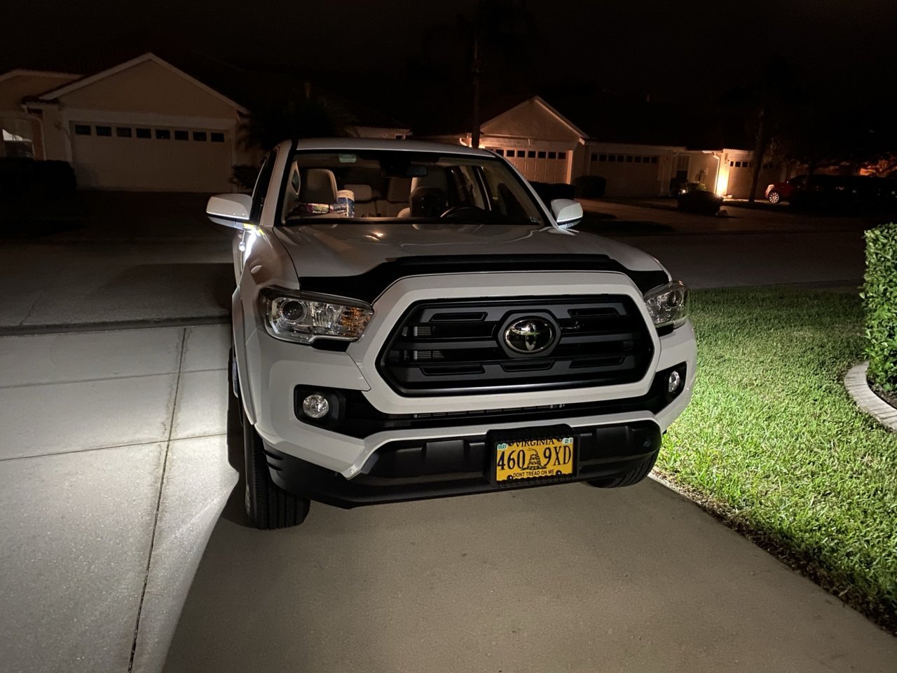

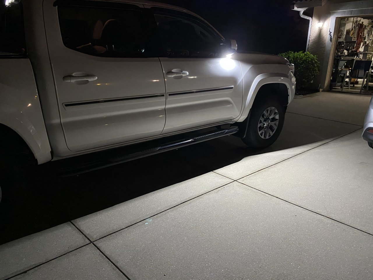

    Very bright.

    Looks great! Those puddle lights are bright!
