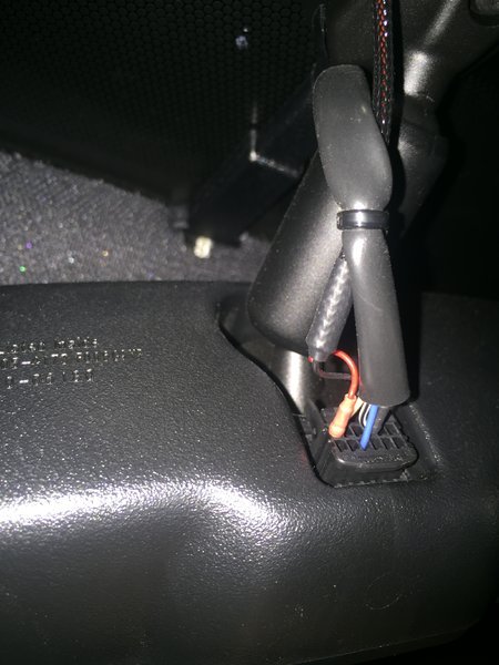

    Do you mind posting a close up shot behind the mirror?

    I'd like to see that too. And does anyone know if a 3rd gen mirror's power source set up is the same as a 2nd gen?

    Hard to get a good shot. Tan wire is hot and black/white is ground.

    Thank you sir.
