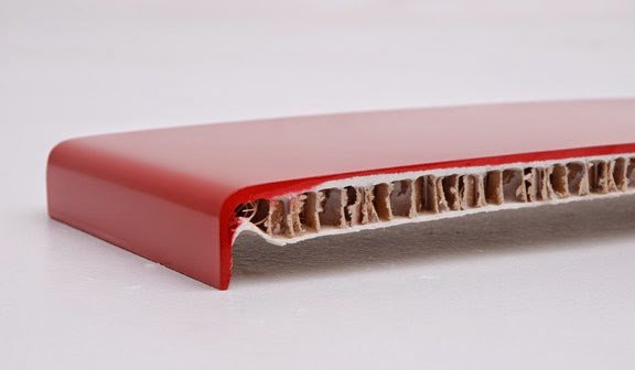

    Probably wouldn't be a bad idea to some how seal up around the edges where that paper like product will be exposed after you cut it. Even if you fill that all with sealant before you drop the vent in.

    Great idea. What about using some fiberglass then maybe an epoxy sealant over that? When we were kids my brother would buy fiberglass repair kits for his surfboards. It would be sealed and rigid on the edge. I like that idea. :)

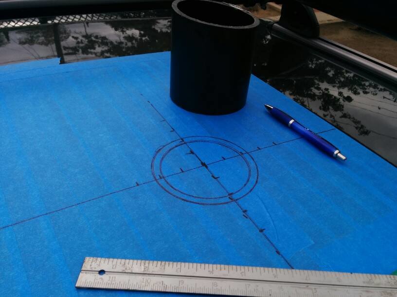

    Project underway. Went full custom, I am installing an ABS pipe with low profile vent.

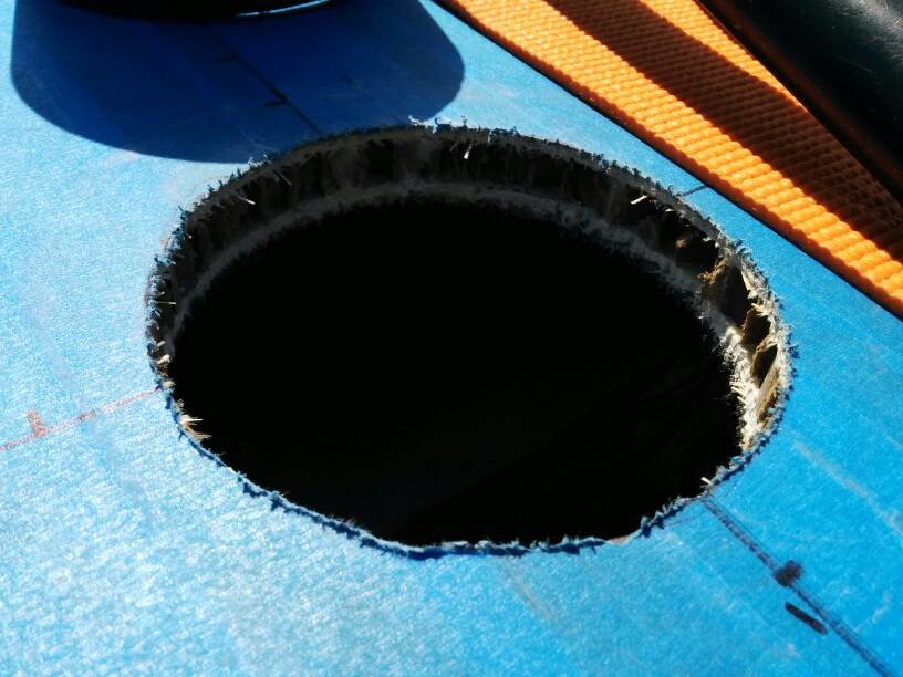

    Bet you triple checked that measurement

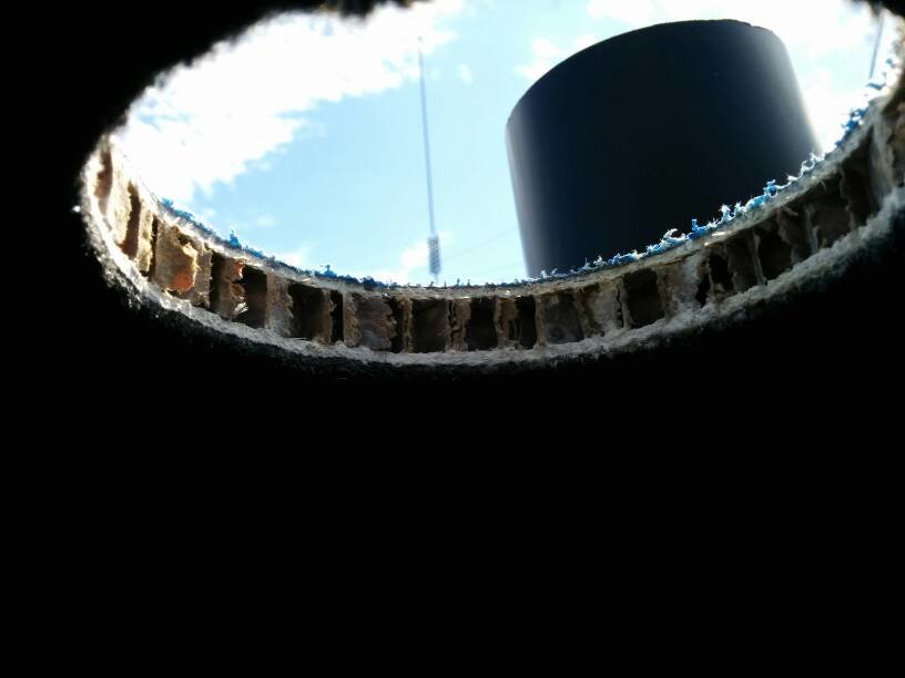

    You could say that. The Canplas ABS vent cap is made in Canada. Thought of you when I saw it. ;)
    Cut has been sealed now. Going to smooth out the glass and prep the joint for adhesive roof sealant. :cool:

    I think it's going to work great. I laughed when i saw dust escaping through updraft while working. Once I'm all done I'll test by taking temperature measurements post install. Next week it's supposed to be 90 on Thursday so that will be a good day to measure.
    I'll seal the vent in tomorrow and post picture. I think it looks good.
