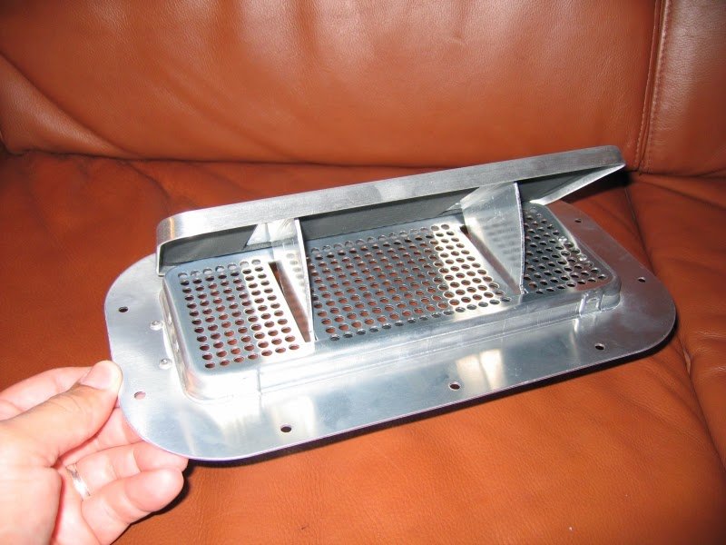

    I did not know about the tropical roofs! :D Very cool concept. I see folks had a discussion a few years ago on EXPO about it.

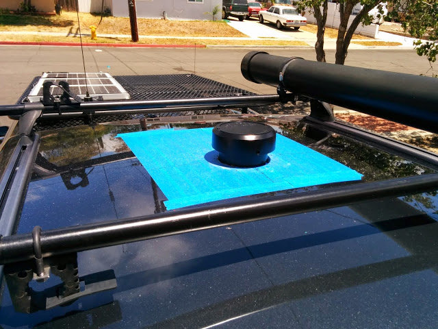

    That looks like a nice vent you got. I had unique constraints in that I needed something very low profile < 4" tall. I went with a Canplas ABS vent cap for $15 from Amazon. I already had the 4" ABS pipe.

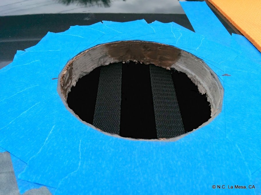

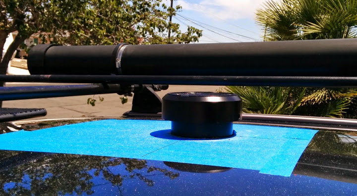

    Here is a picture from the test fit:
    I may revisit this concept. I realize that above the cab I'm pretty much ready to go in that I have a roof rack that covers the whole cab, I would just need to line it with something. On the drivers side I get a little relief from the solar panel array.

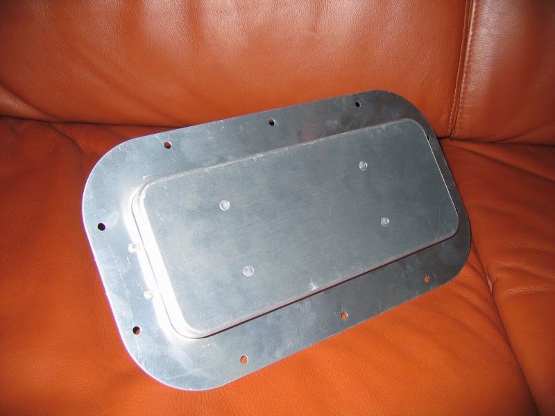

    You can see it in this picture:
    Fabbing something for the shell would be a fun challenge because it has to function and still look good.

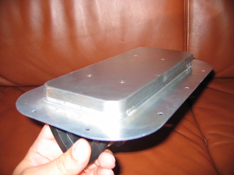

    Wait a sec. How about a trailer roof vent? Or did you already consider this? Crank operated from the inside, 12vdc fan, seals well, build up the base with putty to fit the contour of your roof. This one is 2 3/8" closed, 3.25" open with 12vdc fan: http://www.etrailer.com/Enclosed-Trailer-Parts/Ventline/VP-543SP.html
    This one is 4.5" closed, 10" fully open, adjustable with the crank: http://www.etrailer.com/Enclosed-Trailer-Parts/Ventline/V2094SP-34.html
    May not work for Crom, but could work for me. A smoked plastic version would look good on the darker shells.

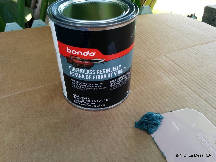

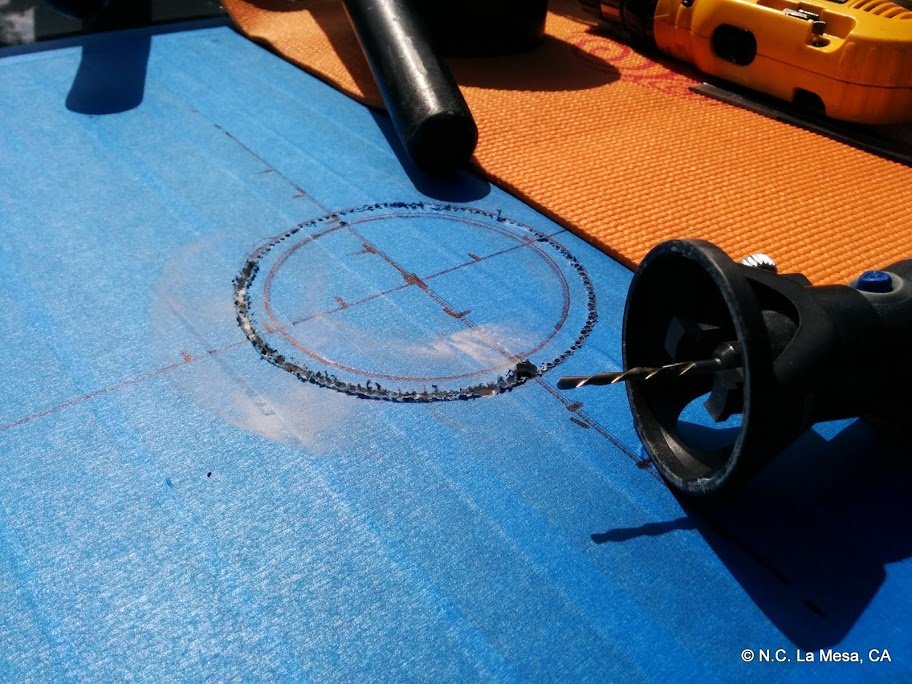

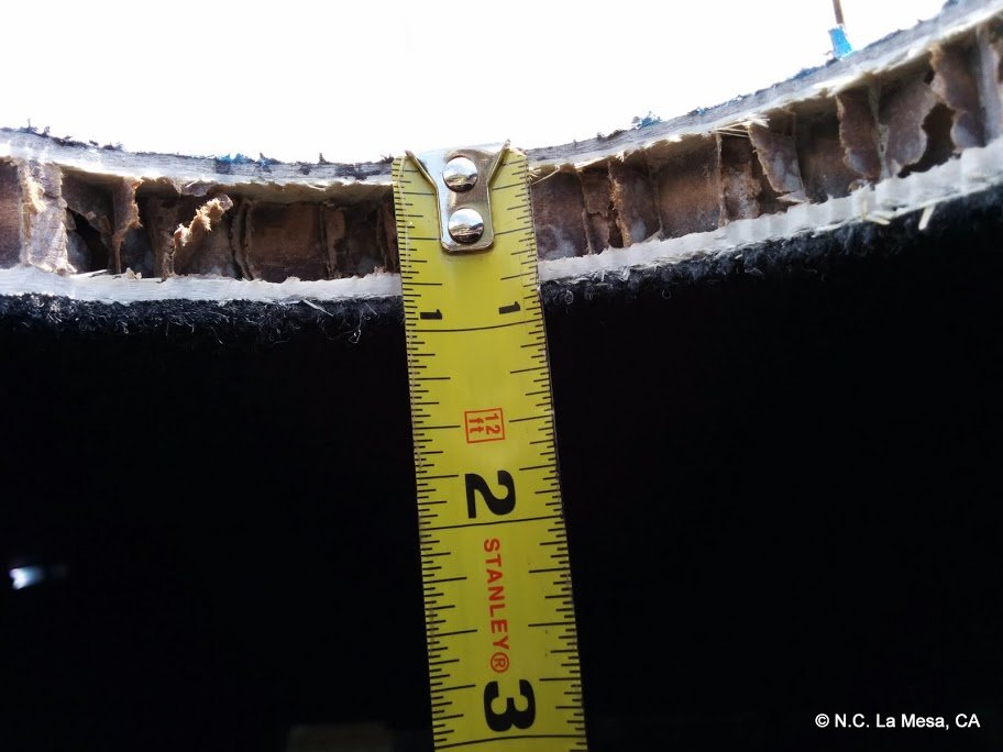

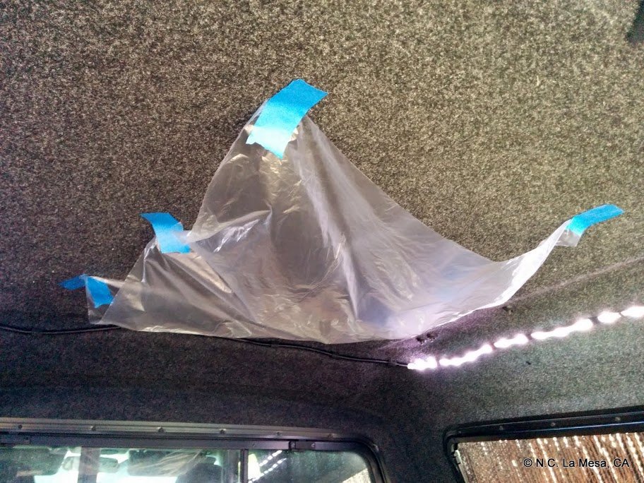

    I updated the OP with more photos and a "how to" on installing a vent on a shell. Hopefully it helps someone out. ;)

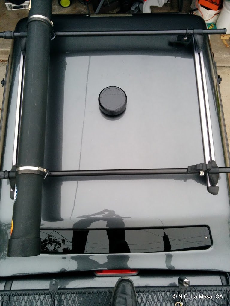

    Thanks! It is doing very well, I am surprised in fact by how well it works. Adhesive is fully cured now and I've driven it freeway speeds, it's rained, no issues at all. Very happy :)
    That vent should work great!
    The heat bellowing out is a thing of the past for me now. The heat goes out the vent! It works! It really works! I've been taking measurements each day and on average the vent is keeping the shell 20*-25*F cooler near the roof line.

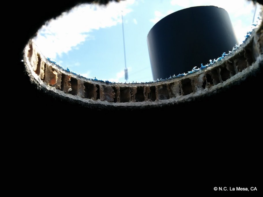

    @Crom, can you post an interior pic? Do you have a headliner? What did you do on the inside of the topper?
