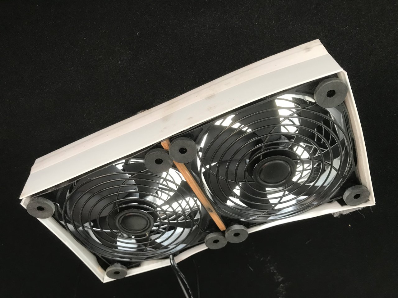

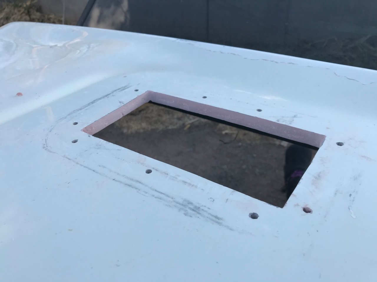

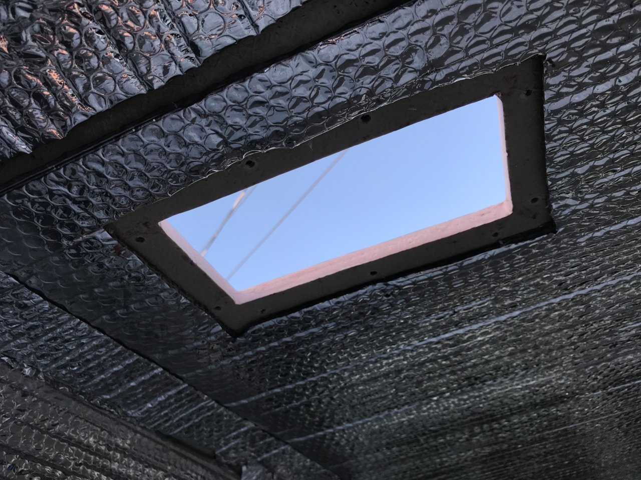

    I also had an Issue with heat and humidity, I ended up buying a spring horse vent because I wanted to keep low profile due to the fact that we use a ladder rack on occasion with the camper as well as we did not want any protrusions to hit our heads on while camping, this unit closes flush on the inside. Once we had the vent we used a jig saw to cut the hole, we insulated and sealed the hole then added insulation and cloth interior carpeting to the rest of the interior.
    We bolted the vent on with acorn loc nuts as they are small enough that they do not protrude from the insulation/carpeting. To aid in the vent moving air I purchased a dual computer fan assembly and mounted them together to fit over the hole. We use a jackery 250 battery with 100w solar panel for excursions so using this fan unit all night only uses roughly 10% power and is recharged by 11am on an average day.
    $25 White Pop Up Vent (Small) - Trailer Horse Float Livestock Truck Caravan RV
    https://www.ebay.com/itm/112329865703 -Vent
    $20 AC Infinity MULTIFAN S7, Quiet Dual 120mm USB Fan for Receiver DVR Playstation Xbox Computer Cabinet Cooling
    https://www.amazon.com/gp/product/B00JLV4BWC/ref=ppx_yo_dt_b_asin_title_o05_s01?ie=UTF8&psc=1 -Fans

    Great idea! Tandem fans and vent appear to be different shapes and sizes. How did you get them to function together?
    Fan is USB powered; did you install a switch? Where did you run the USB cable to?

    The fan unit came prewired with a switch and running together with 3 power settings (unfortunately no reverse), jackery/solar panel are our off grid power so we can plug directly into those with usb, a/c, or d/c, the battery is in an open air compartment under the mattress area.
    As the fan is only in when we are outing the cable is run down the wall along the large window in the back with velcro so we can store it away when not in use.
    Since the hole ceiling hole and fans are not perfectly matched up in size with one another (good eye jnossoff) I bought some flexible window frame seals to box in the gap between the fan bodies and the ceiling, the fans on high (where we leave it overnight) runs at 104 cfm, so even with a semi decent seal, the air is pulled out pretty efficiently, enough to make a light breeze inside with another window open.
