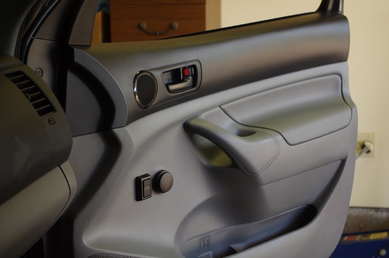

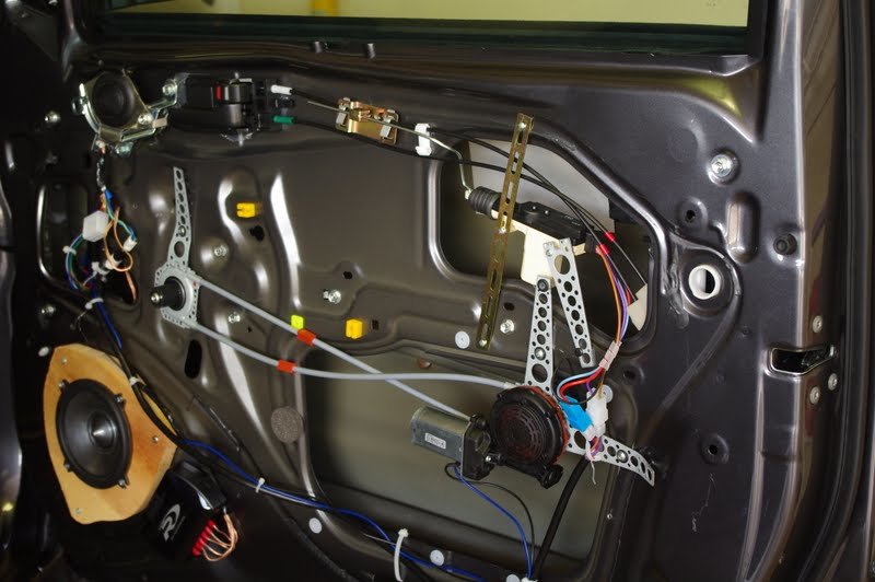

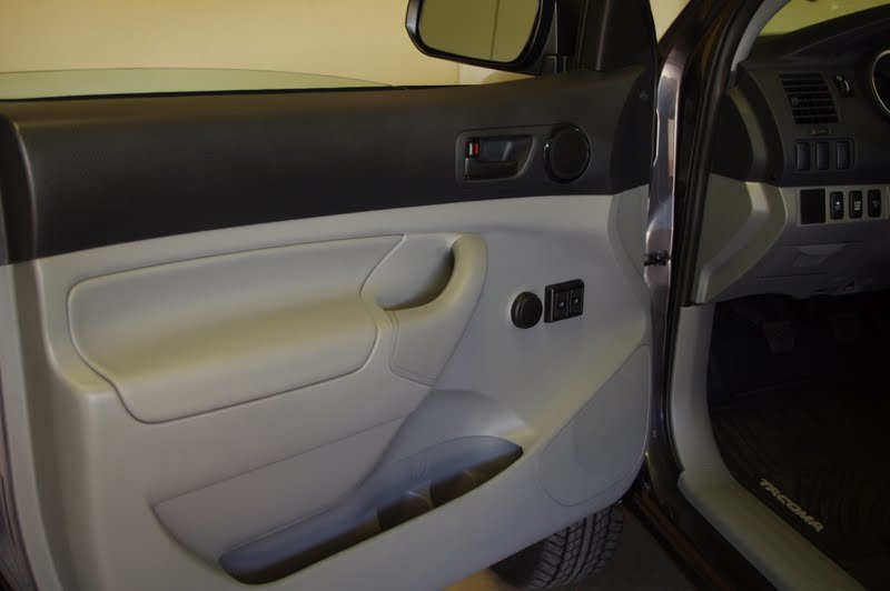

    Added power windows and locks to my regular cab manual 4x4. This is what I got:
    http://www.a1electric.com/Merchant2/merchant.mvc?Screen=PROD&Store_Code=AEOS&Product_Code=SPAL-0128
    http://www.a1electric.com/Merchant2/merchant.mvc?Screen=PROD&Store_Code=AEOS&Product_Code=W01C
    I've installed the exact same two products on my old Titan. The Titan was super easy to work on and there was an install guide available on a1's site. I didn't think it was going to be too hard, but it was a bit trickier in the Tacoma. Space is a little limited (when compared to my Titan). Anyway, here's what I ended up with:
    notes:
    There's not a lot of room for the window switches. I got the switches that were raised (not flush mounted) because I planned to mount them next to the door handle. But after debating it for awhile, it was just too hard to access the switches as my arm had to contort to reach them. Still though, it was a good thing I got the surface mounts as there isn't a lot of room behind the door panel where I eventually mounted them. plus the cables are right behind where I had initially planned to mount them - may have been an interference.
    The window motor has to be mounted fairly high in the door, with the motor facing inside, facing out will hit the window, mounting it lower will hit the door panel. I still had to shave a bunch of foam off the door panel.
    I had to cut about an 1/8th of an inch off of the long gear (that slips over the old handle knob to be flush)
    For the locks, I think the rod should be bent fairly close to how I did it. Originally I had it coming towards the cabin from the actuator then snaking up and towards the cable, but it was hitting the door panel. So I had to rebend it to go as far up first, then start going towards the cabin.
    For wiring, I had to tap into a total of 3 wires. For my truck, I used white/blue for the locks(constant), white/green for the windows (Acc), and green for the illuminated switches. I tested all of these wires with a test light.
    In hind sight, I wish I didn't do both of these on the same day. Took way longer than I had hoped. Probably about 6-7 hours. Everything works great though. Central locking, so if you open one, the other lock opens. I plan to add an alarm soon. Window motors are strong and fairly silent. Hope this helps anyone looking to do the same.

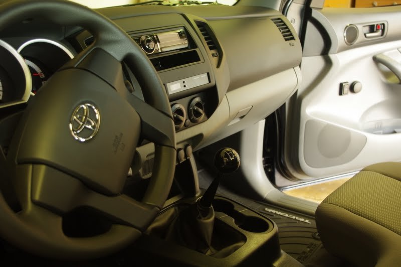

    also installed a sickspeed shift knob:
    Oh, and as you can see, I used a 2005-2011 dash kit for my stereo. I knew it was going to be off, you can see how the lines to match up. I planned to replace it when the 2012 kit comes out, but I may not even bother.

    i also ment to mention,.... do you think that those switches would fit to left of the steering wheel if i modded the blank covers?

    No write up. Also, the window motors are currently installed a bit differently. I put the metal covers back on the inner door panel and mounted the motors to that. Unfortunately no pics of that either. I completely removed all the foam from the door card. Also installed sound deadening - that's what prompted the reinstall of the metal plate, to close off that huge opening. But everything is working great.
    The exact switches I got are too wide to fit in there, but there might be switches that fit. A1 lists the dimensions for each switch. I cutout cardboard templates from the dimensions I got from the website and made sure they would fit.
