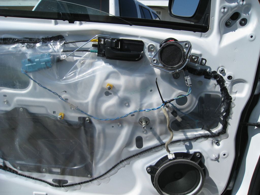

    So i ordered the kit above from a1 electric, i noticed in this pic it looked as if he tapped off the speaker wire for power? is this true?
    If not, where would the best place to find somewhere with 12volt constant other than battery...?
    EDIT: Does the fuse box by the steering wheel have a constant 12v fuse? that where i plugged in my fog switch for power.
    [QUOTE
    [​IMG][/QUOTE]

    wheres this white blue wire you speak of located?

    LOL, no...
    What looks like a shadow next to the hole in the door under the tweeter harness, you can see the blue pair passing down into the door.
    Yes.
    Both switched and constant are available on that box.

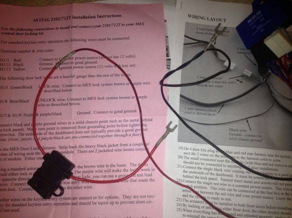

    I have the cable kit the OP has with they keyless entry system you posted a link to above, installing the actuator and everything else is self explanatory, I was just wondering where or what place is best to tap into for a constant 12v without running a wire to the battery. He said he tapped into a blue/white wire, just wanted to know where that's all. So if there's a open fuse that has 12v constant I will go buy a add a fuse like I did with my fogs, but I have another question, is it safe to run the door lock actuator harness off of that and that into the top of the harness for the power to the keyless entry system or should I run separate power sources and grounds?
    Edit: also would I be able to get away with splicing both power wires from the keyless entry and lock actuator harness into the one add a fuse and put it in the fuse box? The find a ground and use the same point for both grounds?

    This was awhile ago, so details are a little blurry. As far as I can remember, the locks come with it's own fuse, no need to add another one in. The constant power I tapped was on the driver side, underneath the steering wheel, next to the fuse box. I ran new ground - drilled a hole near driver side kick panel for a self tapping screw - using the same ground for windows and locks.

    Yea they harness has a fuse but my intention was to use a "add a fuse" wich is basicicaly a flues looking adapter with a wire to plug into a fuse box for an assesorie but don't need to add a fuse like this http://www.amazon.com/gp/aw/d/B000GKEXK22 for the 12v power and find a ground, would it be safe to power both the lock harness and keyless system off the same power source from the fuse box?

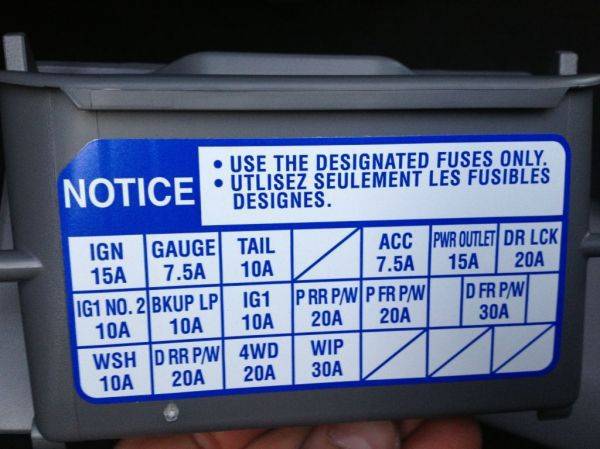

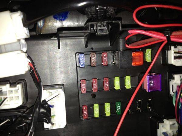

    Ok so, the 3 fuse blanks on the right of the fuse block get no 12v power at all, i noticed the top right one is 20a and gets 12v constant power. On the little cover it says "dr lck 20a" im assuming that this fuse is for power locks? (wich i dont have from factory) so would this be a safe place to "add a circuit" aka add a fuse for power to both harnesses, just like i did for my fogs?. Finding ground is not an issue, just don't want to splice into another wire if i dont have to and for easy trouble shooting if any future issues arise.

    so heres what i came up with, [​IMG]
    End of power wire plugged into the 20a socket since the harness has a 15a fuse inline that i soldered in and black to ground. What do you guys think.
    Also will the keyless entry system work without the "yellow" ignition wire connected? i don't really want my doors to lock when i turn the ignition on.
    Please let me know what u think. Thanks -kyle
    Edit: Sorry for the tripple post but i plan on installing this tomorrow and would like to know before hand.

    That should work.
    If you want the keyless to activate the interior light, confirm that it applies a ground and connect it to the blue wire in the A-Pillar.
