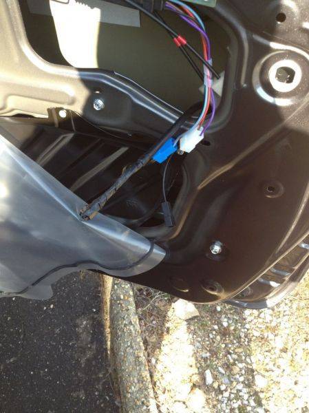

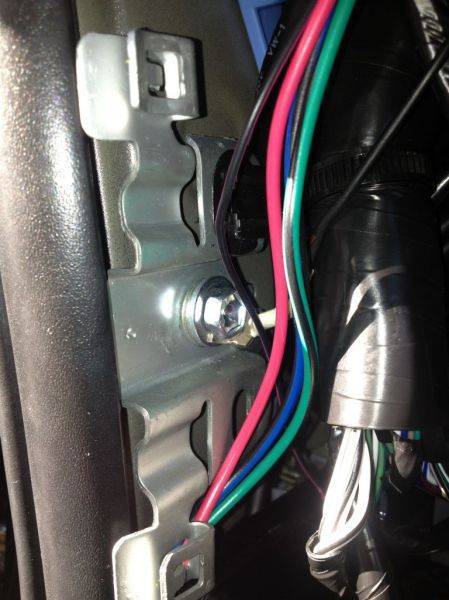

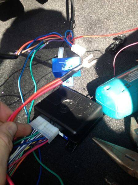

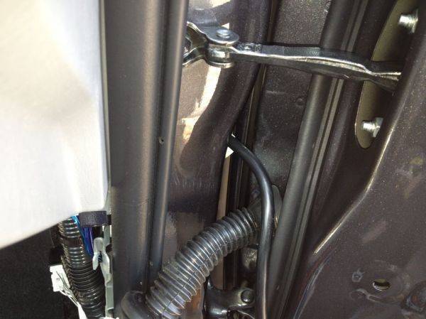

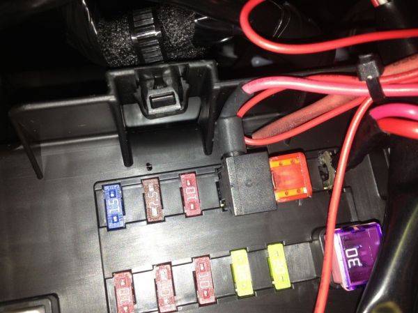

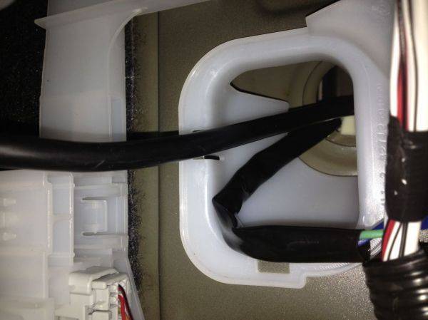

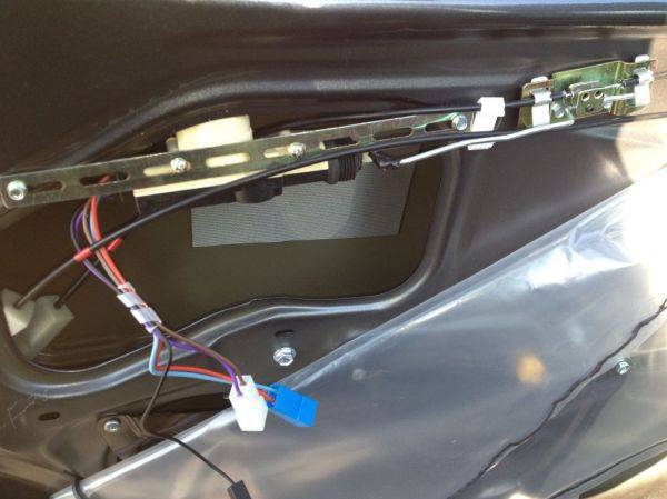

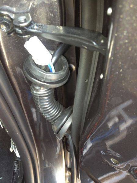

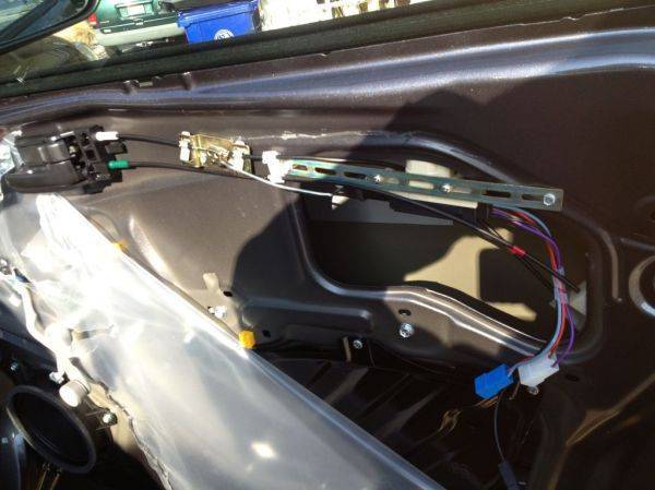

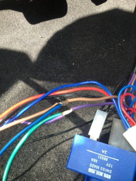

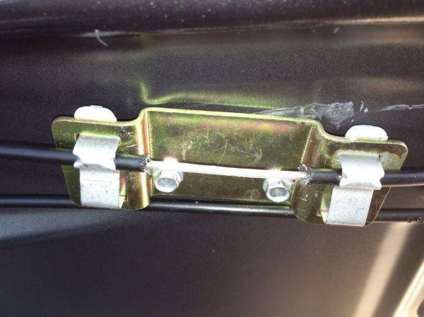

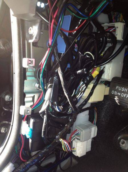

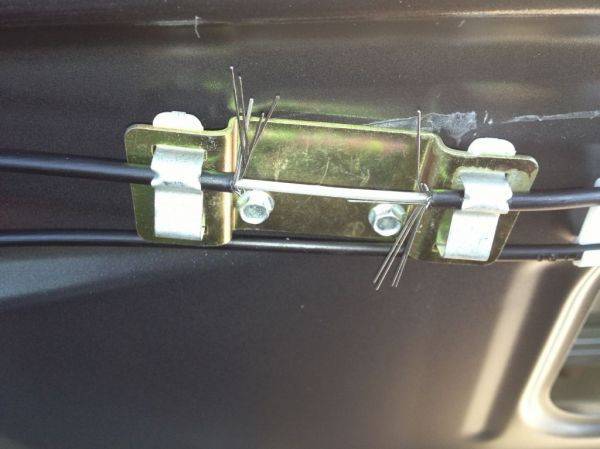

    Well i finished took a while about 5 hours but i was taking my time and trying to make as clean of an install as possible, heres how i did mine.
    Mounted bracket, stripped, plastic cover, wire, and more plastic to get to cable underneath.
    Mounted bracket, actuator and bent rod linkage so its aligned with the cable bracket system.
    same thing to other side

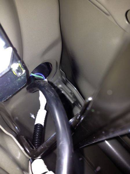

    snake wires threw hole behind kick panel
    Pulled both ends of the boot out to i can snake the wire threw easier, and disconnected speaker wire
    Put wire threw door
    Snake it up to actuator
    Soldered both power wires from door lock harness and keyless entry harness together to 1 connector
    Soldered the black blue wire from the keyless entry system to the brown wire on the actuator harness, this Unlocks The door. Then same thing with green/black to purple wire for locking.
    Taped each wire up i soldered, then the whole bundle.
    All grounds went here, to the bolt that holds the kick plate bracket in place.
    I then put the keyless entry system here, all extra wires are tucked into a pocket behind where i put the keyless entry box.
    Plugged the power wires i solderd into 1 connector into the "20a Dr Lck" socket
    I then put everything back on, kickplate, running board cover, door panels, ect. works great. Only had 1 issue threw whole process. On the top right of the door panel is a triangle cover that covers the mirror bolts, it has 3 little white plastic clips, one you pop that cover out take the clips out by squeezing them. If you try to push the cover back on with them in the holes they will fall threw! so make sure you take them out and put them on the cover and not leave them in the holes when you reinstall them, i lost 2 clips :( had to use Velcro to keep them from falling out. Threw the whole process i made sure windows cleared the actuators and wires and made sure the actuators had a little play in them so they dont bind up. On the drivers side you may notice electrical tape on the cable. i put that there cause i didnt want the cable to hit the bracket and make noise. This is because i put the cable coming out of the top on the hole on the actuator and it was close to the bracket. on the passenger side i put it coming out of the bottom and it had more clearance, but i had already bent the driverside cable so i wasn't going to redo it.
    Ps my fingertips are killing me now lol there sore as hell for some reason.

    Which way is more reliable? the cable method or the way Anthony says to?

    Done properly, Anthony's method.
    But it's way easy to screw that up and not get a secure connection or to get binding/interference.
