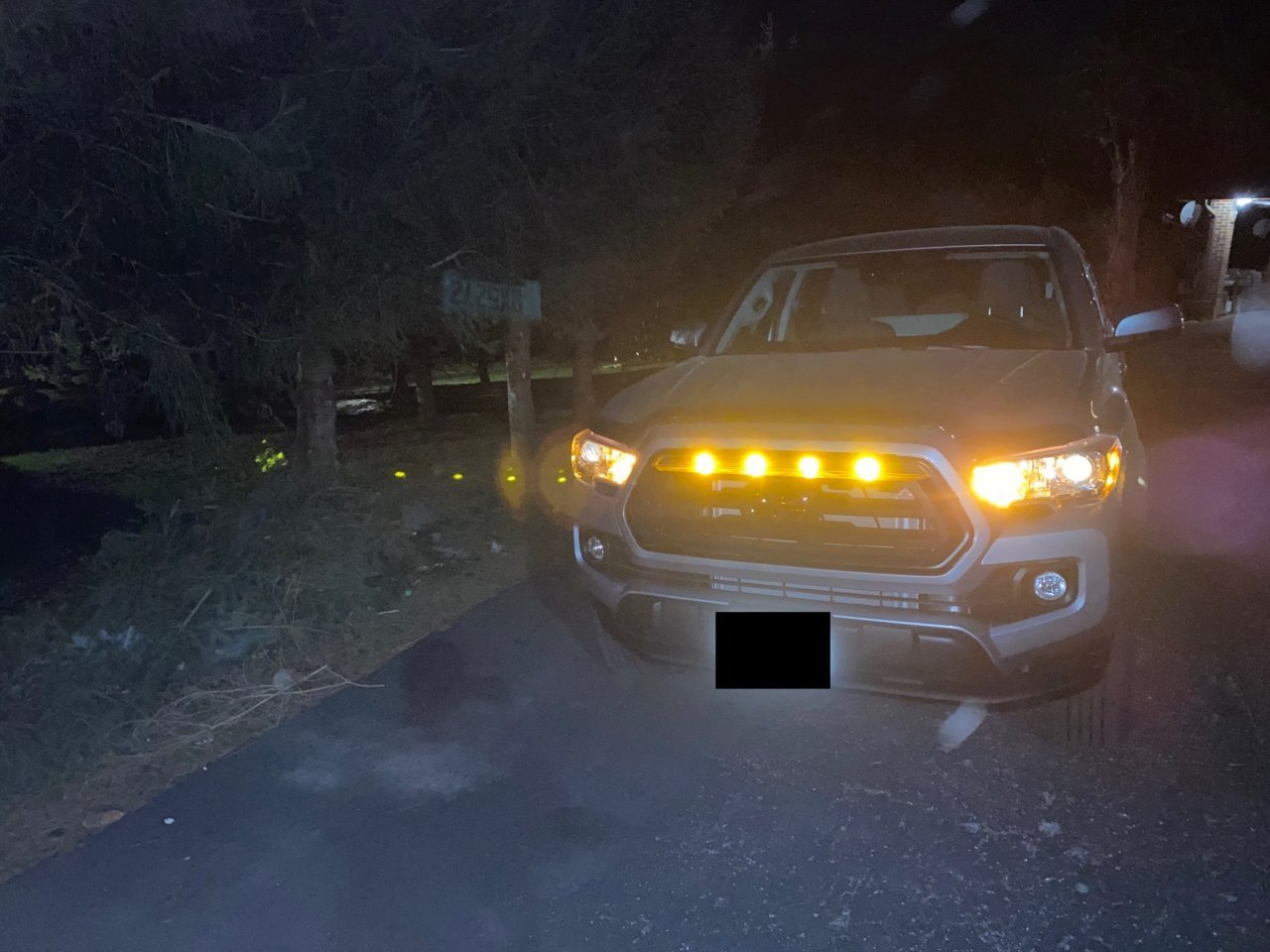

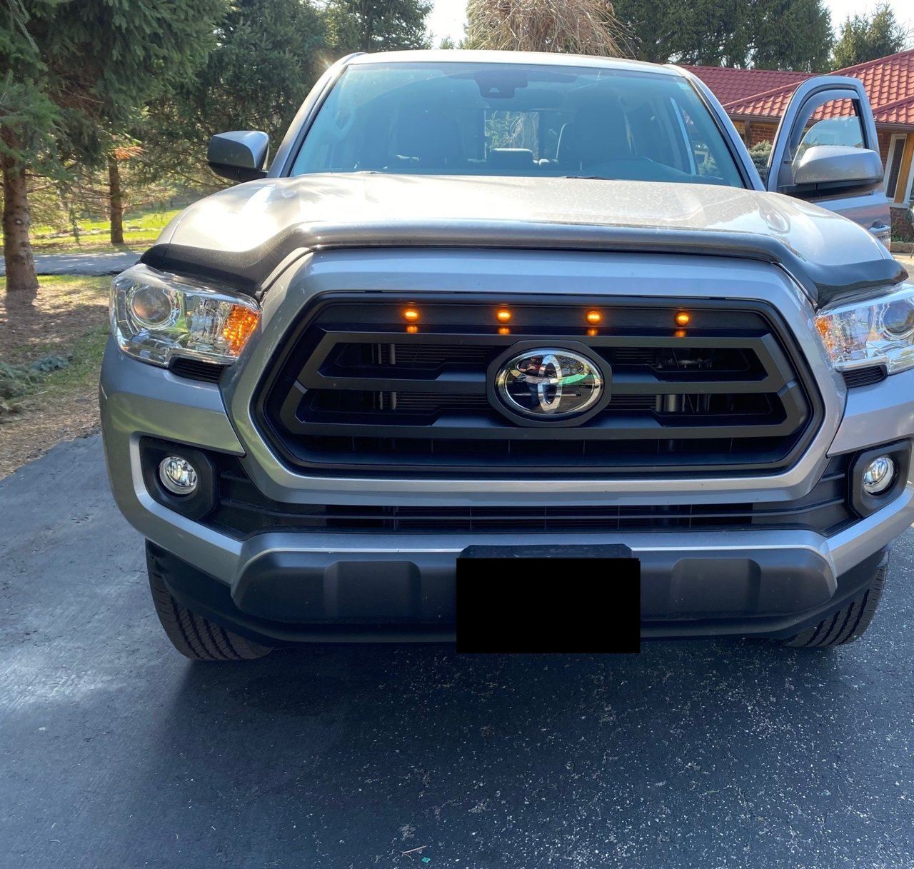

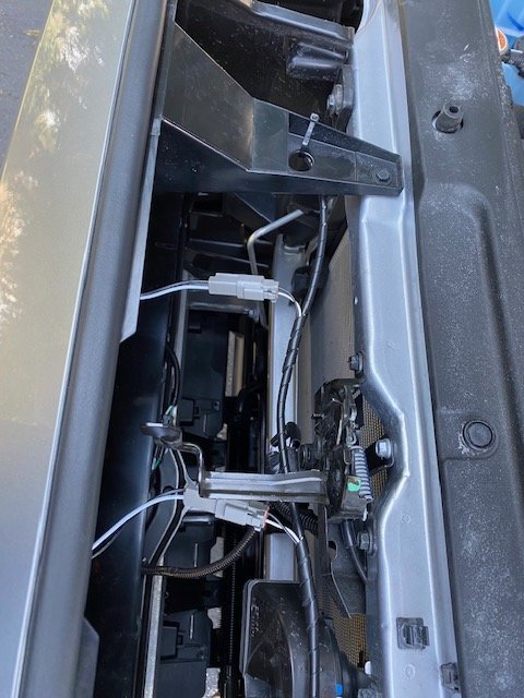

    Hello,
    I just joined TacomaWorld!
    I was going to purchase a new grill, to install raptor lights. I ended up drilling holes in my stock grill and installing LED lights from Amazon.

    Welcome! How did you run the wiring? Did you tap into a fuse or?

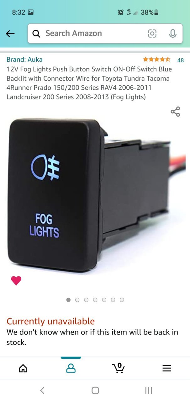

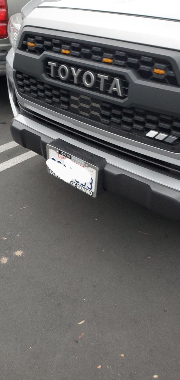

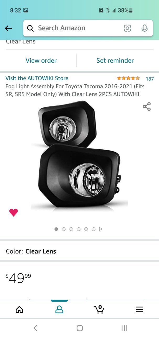

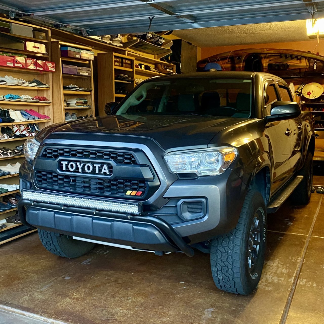

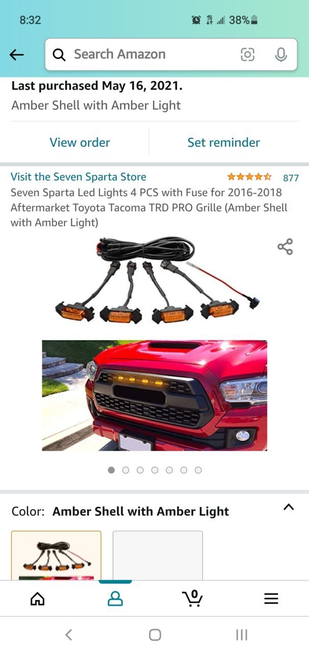

    Hello tacoma brothers I have been offline for a little bit but I modified my taco with these products off Amazon.
    Take a look and let me know if you need help :thumbsup:

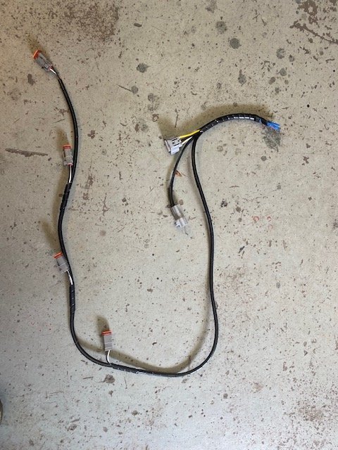

    It has been a while since I was last on. Here are some links to the products that I used. I wired this up to the driver daytime running light signal.
    These are the connectors to wire to the turn signal harness. I think there is a video of someone using a add-a-fuse to the fuse box to power the lights.
    https://www.amazon.com/gp/product/B081MWRDH5?ie=UTF8
    https://www.amazon.com/gp/product/B08XYX7LQ3?ie=UTF8
    My father ordered these lights and did not need the amber ones, so he gave them to me.
    https://www.amazon.com/gp/product/B071V9WQS9?ie=UTF8
    I also purchased these connectors to make the harness. You could use any connector/crimp you please.
    https://www.amazon.com/gp/product/B08CVDFV2J?ie=UTF8&th=1
    I used a ruler to space out the light evenly and then I used a 3/4 step bit to drill the holes.

    Looks nice, so tell me about that light bar on the front bumper. I like that, link please.
