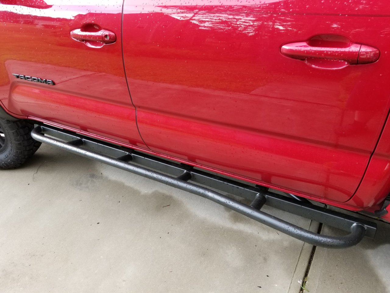

    Edit: Sorry. I thought I posted this on the "What Have You Done To Your 3rd Gen Today?" thread.

    Bolt on. Took me a good 5 hours! Took my time though since it was my first time installing sliders.

    It was sunny so I fried my legs today buy it was worth it. LoL
    Oh and that flat washer with the welded bolt and long handle is a pain to get it in there on the driver's side. Spent an hour just on that! My wife had to help me!

    How much do they weigh and do you have any pix of the frame?
    I'd like to get some and can't decide on which ones to get.

    Their site says 140 pounds but that must be for the pair. I can take some photos of the frame tomorrow for you.

    your truck looks badass! love those sliders... they look the perfect angle too- what is that angle? 10%?14.5?

    Thanks. 20* on the sliders

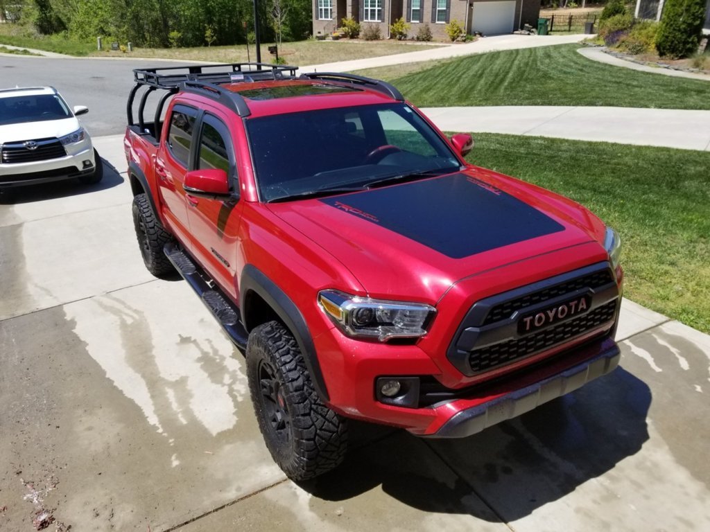

    what tires are those? winter rated? they look like 285- is that right?

    Nitto Ridge Grapplers. Yeah 285/70/17. Not sure about winter rating .

    I know this is a dumb question but I am relatively new to this but what are the differences between a 0 degree and a 20degree rock slider? Where is the angle at?

    The angle is how much of an angle the tubes are pitched up compared to the side of the frame - the higher the angle, the closer to the rocker panels the tubes will be, and the less step-friendly the slider becomes, but it also raises slider clearance for rocks at the same time, and lowers door and shopping cart protection.
    5-degrees makes for a good step while allowing for a bit more clearance and side protection.

    Just curious, as I am shopping sliders, how far do these measure from the frame, to the furthest points on both the main body section, and the kick out section also?
    And... at 20 degrees, where does that put the top of the tube,... lets say from the bottom of the driver's door bottom? I'm guessing most trucks sit different, due to varying loads and equipment weights, but think the relationship from bottom of door would remain pretty much constant.
