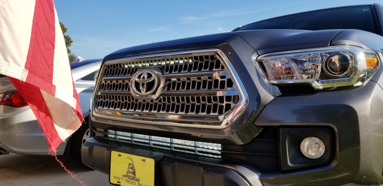

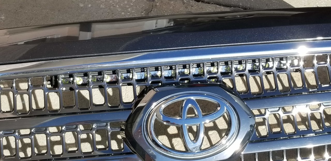

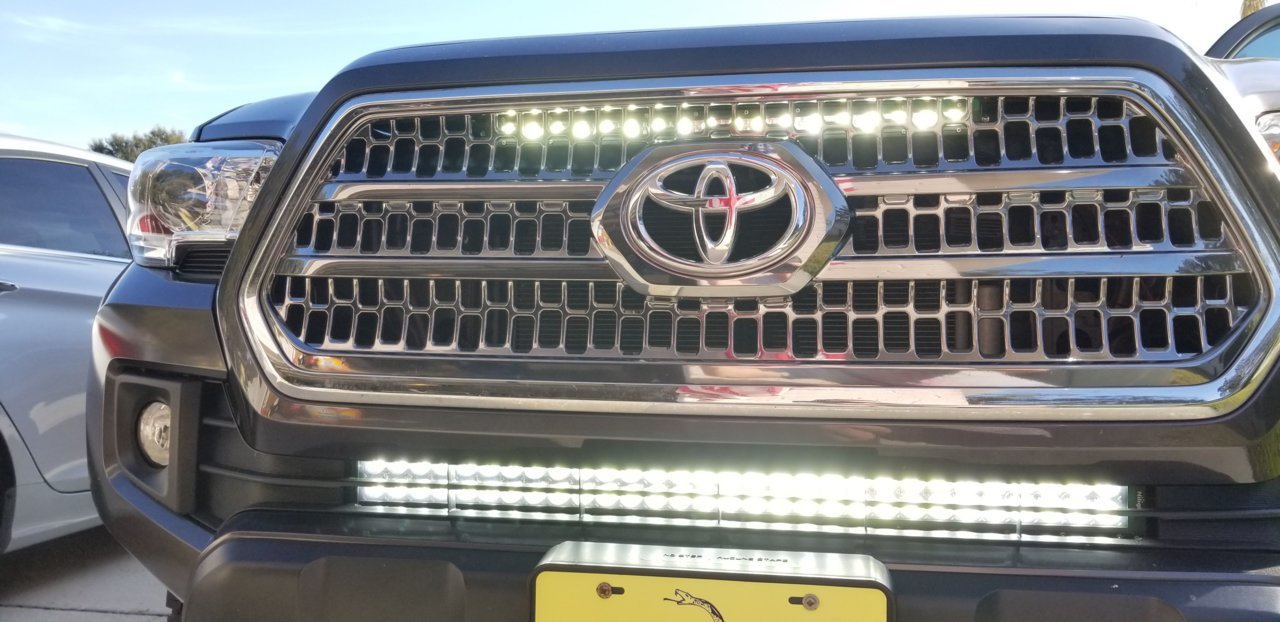

    I had a few spare hours and added this single row light bar to the top of my grill.

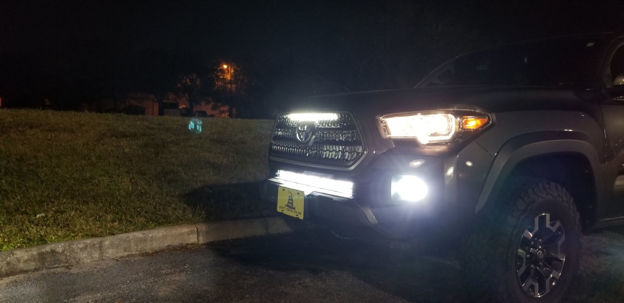

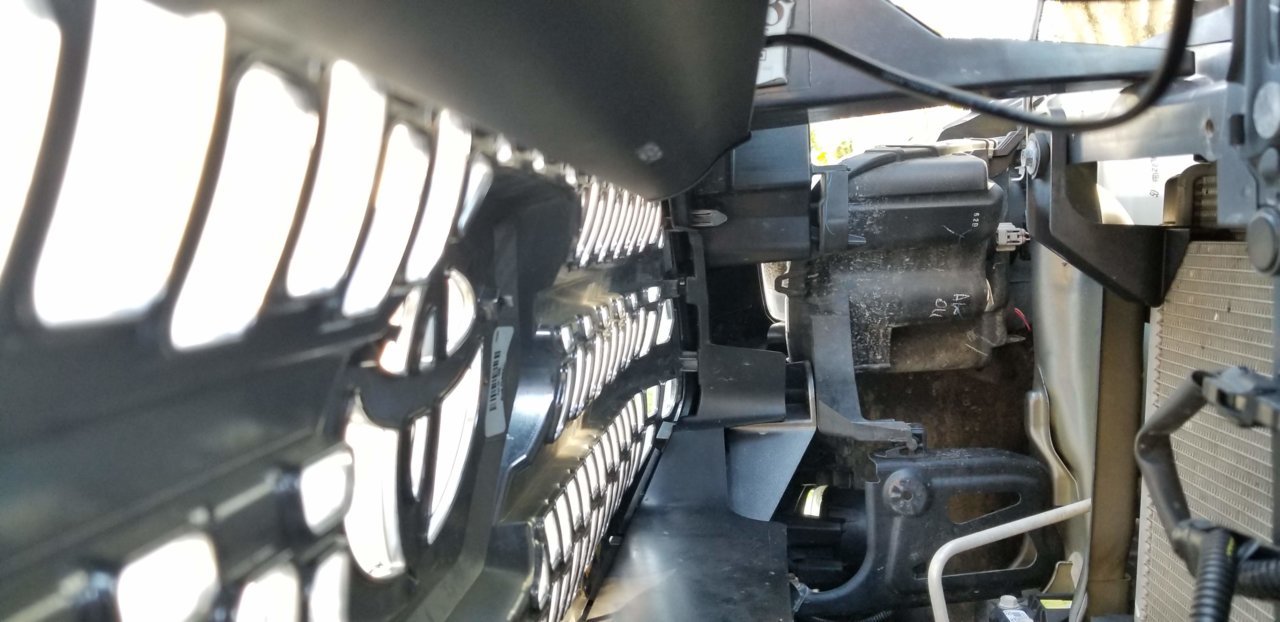

    Never considered adding a second to the top. How did you mount it?

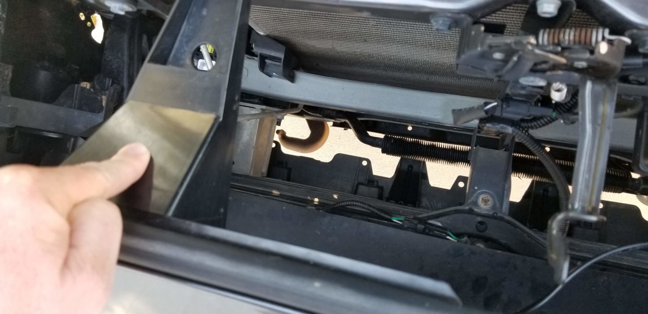

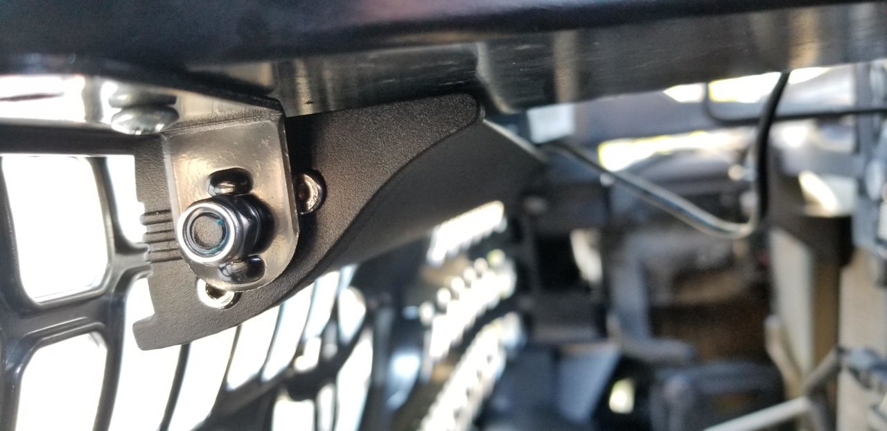

    Sorry. Guess I forgot to show that part. Once I had a good think about it, it was pretty simple. I mounted the brackets of the light bar to the underside of the grill brackets.20190207_105341.jpg

    Hmmm I have an extra connection on my harness from my lower bar so I might as well add this. I was going to add a hood scoop light but the wiring for this will be a lot easier.
    What size light bar? 18"?

    The box says 19".

    how did you wire it?

    I tapped into the wiring of the big light bar underneath.
