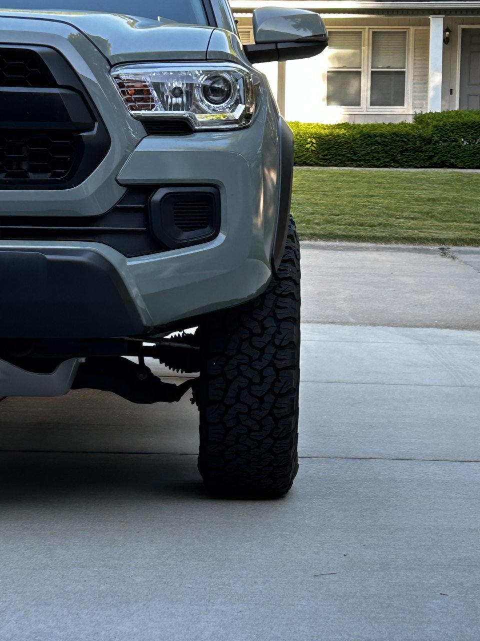

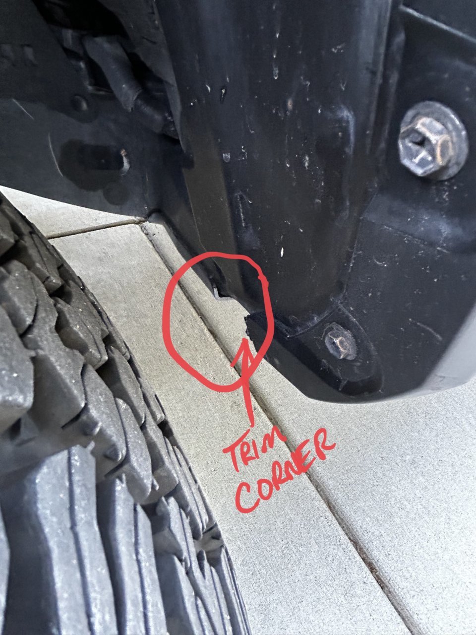

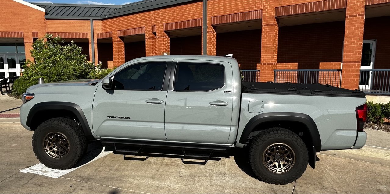

    SO…. Quick back story on this… I have been researching online extensively and finally bought a set of Spidertrax 1.25” wheel spacers (black) about 3 weeks ago. I was thinking the 1.25” may make the +4 offset factory bronze wheels, push out too much. I’m not into that type of look and have been almost completely satisfied with my current set up from when I bought the truck. I had the dealer install 265/75/16 BFG All terrains KO2’s on day one so it already gave it a better stance than stock. The Trail Edition wheels also have a 1/2” wider stance than the other Tacomas but similar if not the same offset as the Pro though. I was about to just send them back but decided to try and fit one on the front to see how they fit and looked. Well, a few hours later, I installed ALL 4 and couldn’t be happier! It can be done much quicker but I took my time, applied anti-seize and the supplied lock-tite, torque to recommended specs etc. I will tell you though, if you have 265/75/16’s and the factory mudflaps, you will have to remove at least the front ones, and trim a corner of the black area in the pic below (circled in red).
    YES, I have read all about spacer and the possible issues/ outcomes but did my homework, installed them by the book and set my trip odometer to retorque at 85lb at 50 miles to make sure.
    All in all, I LOVE the factory bronze Trail wheels but only wished it had a little better stance. I was even thinking to go with 285’s in order to achieve this but with the added weight, possible cab-mount chop etc. NOT for me! My 265 E-rated BFG’s are already heavy enough. And this achieves the look I wanted and actually makes them perfectly inline with the black fender flare when looking down on them.
    Hope this helps someone if they are thinking to do the same thing!
    Thanks for reading!
    D

    Looks great

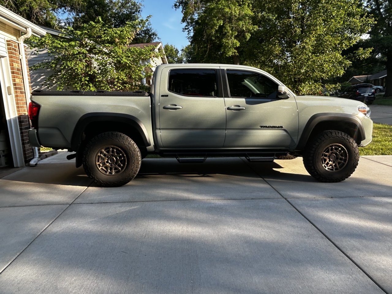

    Looks great man!!
    Get us a side shot!!

    Thanks guys! I’ll try to get a side shot tonight!

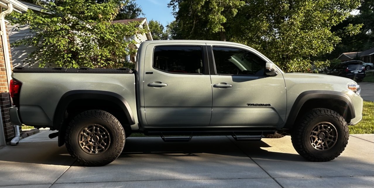

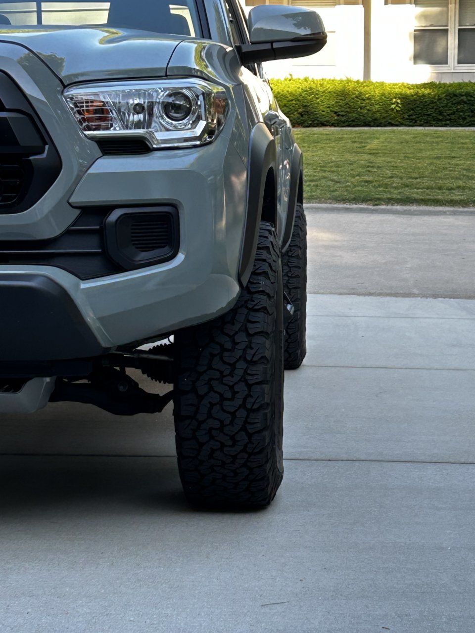

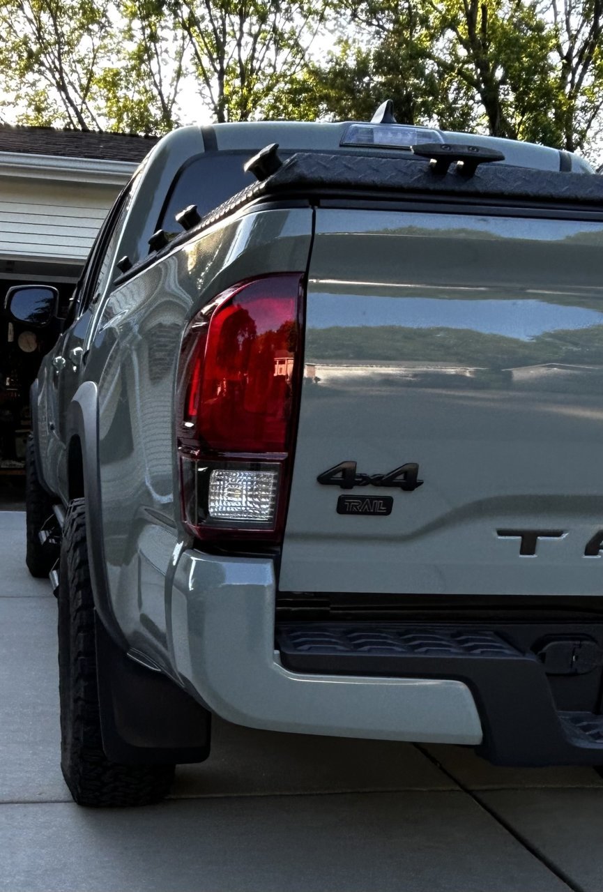

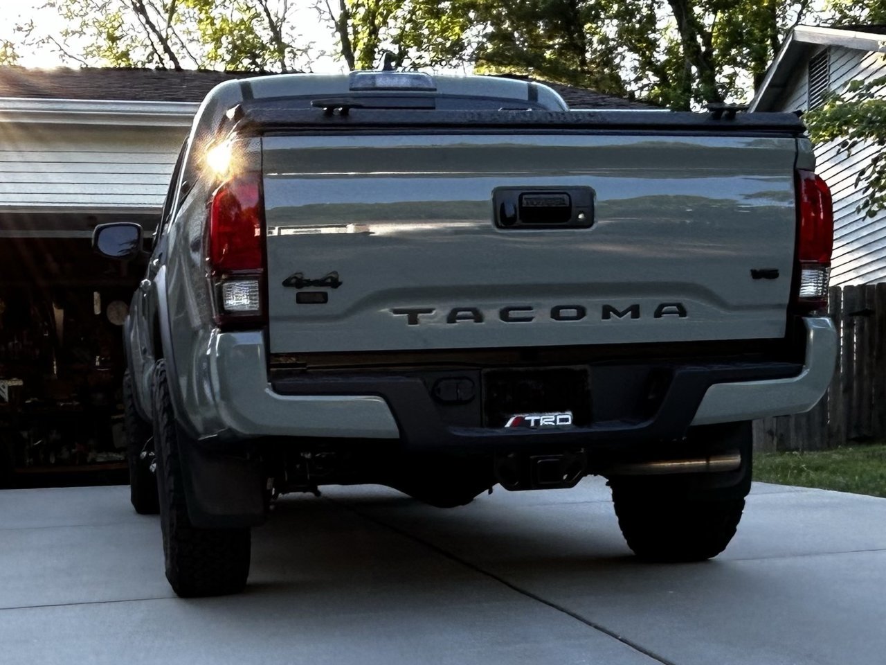

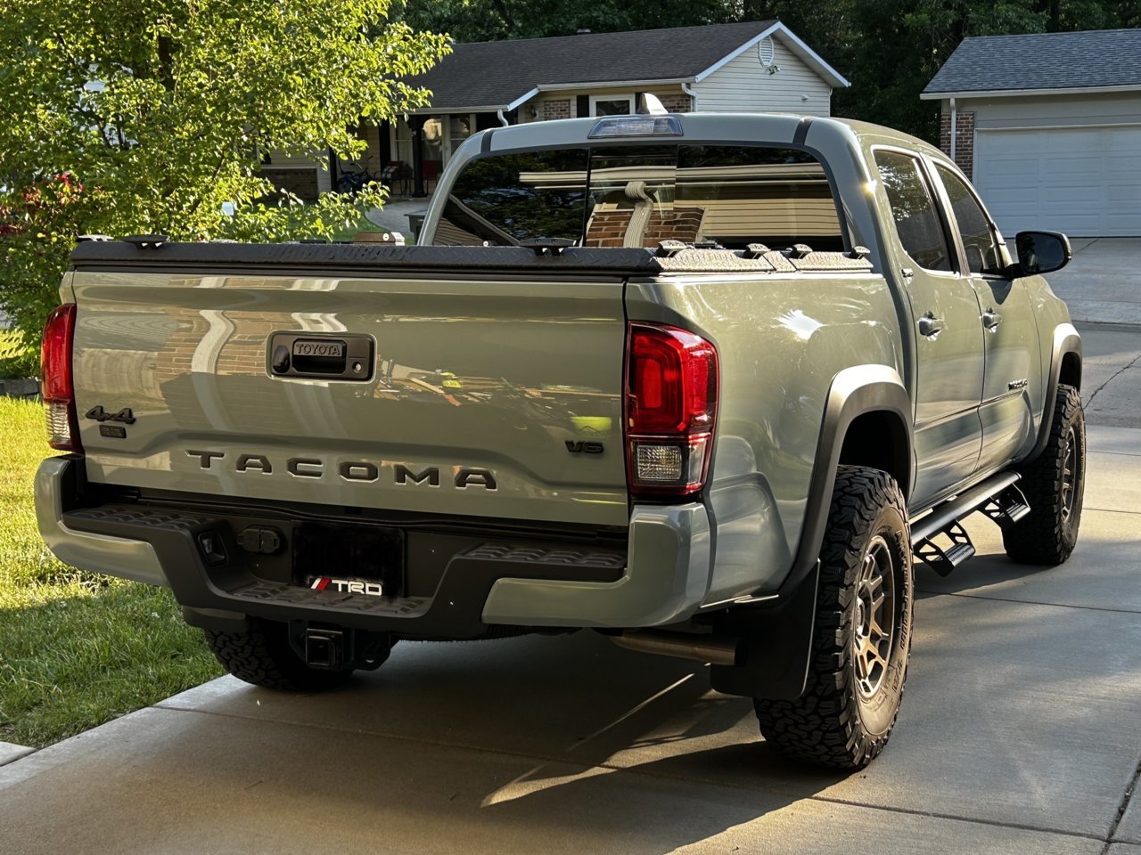

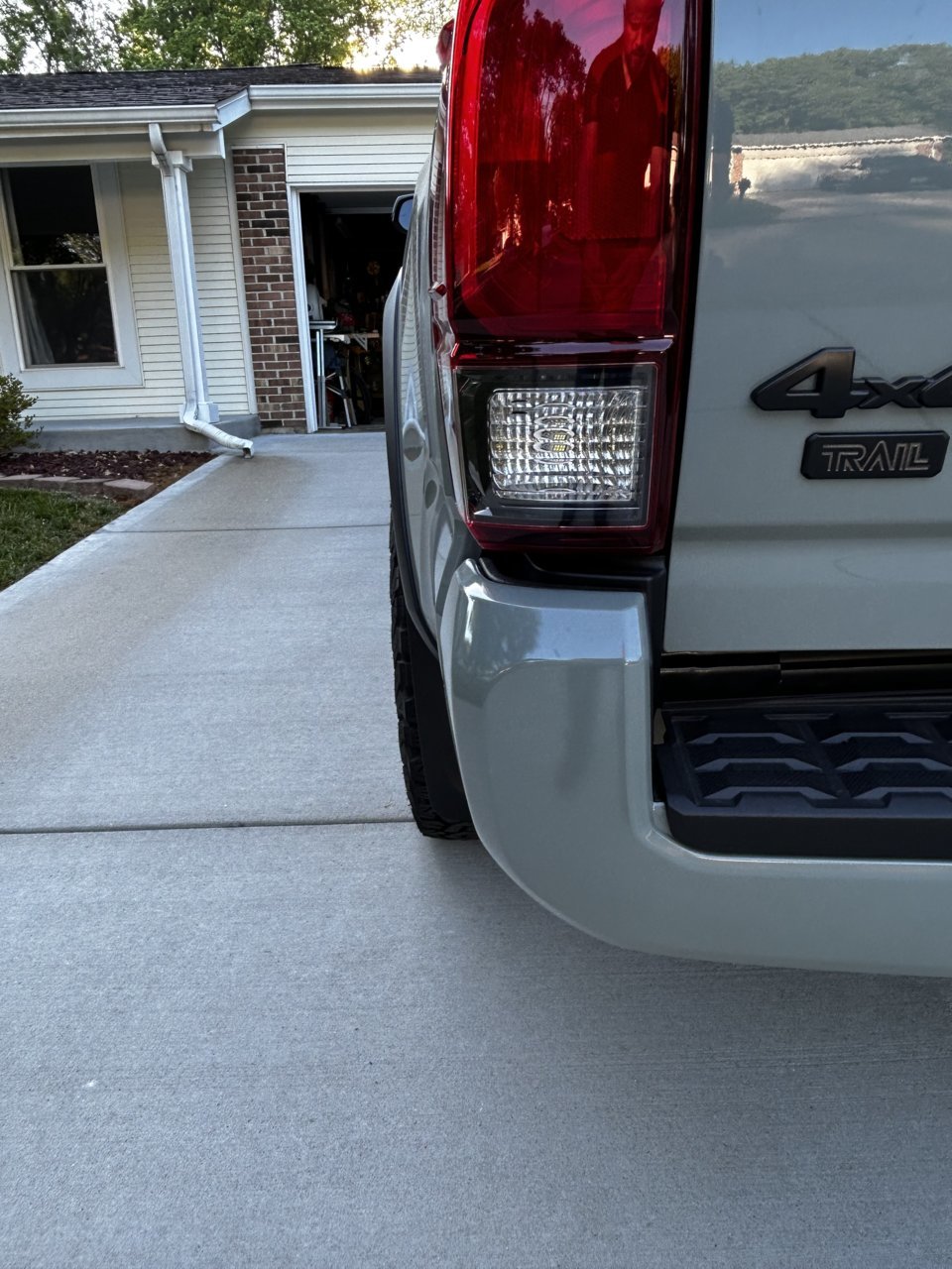

    Here are a few more with side pics:

    Sick dude...Love the wheels, that's what I went with.

    Looks perfect!!
