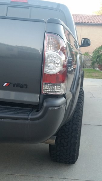

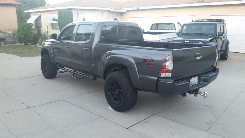

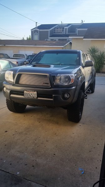

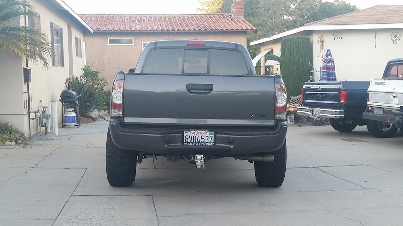

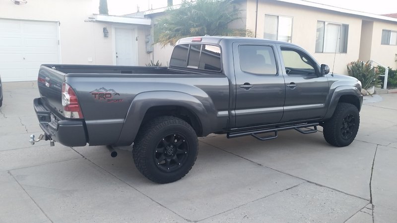

    Just picked up spidertrax 1.25" wheel spacers with lug nuts for 80 bucks. Mounted them on. Very nice quality part. I really like how it pushed the wheels out. Looks much more aggressive. I do need to trim a little, as you can see in the picture. I also added the tacoma sport picture on the bedside. Got that from ebay. What do you guys think?

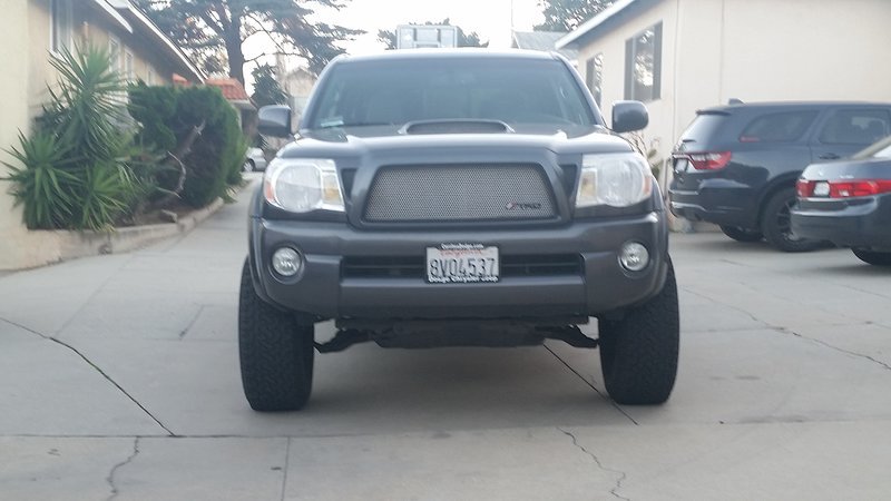

    Before. Not the best angle but you get the idea

    Keeping it a dark, clean look and adding a wider stance i think looks pretty good! But, be safe, make sure you follow the 1-1-1 rule on the spacers!
    1 day later check spacer nuts
    1 week later check spacer nut
    1 month later check spacer nuts
    Im a BIG fan of debadging! Bravo on removing the OEM badges. The small TRD badge on the tailgate is kinda growing on me though :) .... Stickers... not so much....

    Nice - I put the same size spacers on a couple years ago to see how they would look. What I ended up liking more was how the truck handled better - it would track better at higher speeds and feel better in turns - overall I liked it so much I left them on there for that reason alone. The owner of BORA spacers told me to check the torque after 5 miles and after that just every tire rotation. 2ish years later they haven't budged since. As for the front TRD badge I prefer a debadged grill, but you did make it look legit where you placed it - very clean :thumbsup:
