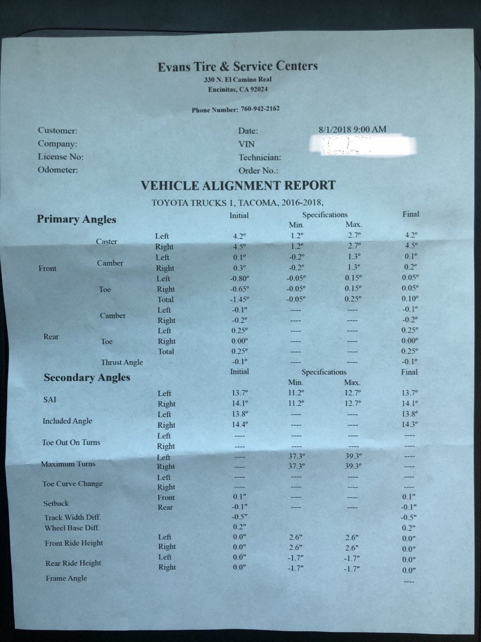

  20. Aug 1, 2018 at 12:15 PM
    #40
    cav
    cav Well-Known Member
    Apr 3, 2018
    #249307
    51
    Marc
    Encinitas, CA
    2018 MGM DCLB OR 4x4
    Bilstein 5100 w/OME 888 Coils & OME Medium Duty Leaf Pack, TC UCAs, TRD 17" Matte Gray w/ Falken Wildpeak A/T3w 285/70/17
    I did the TC UCAs last weekend and got the alignment this morning.
    When I first lifted and had it aligned I asked for increased caster to avoid cab mount rubbing. Ended up rubbing in the front, mostly on the driver side, when backing up and turning onto a street from a driveway. Usually rubbed at mid way between straight an full crank.
    Imediately after installing the ucas I noticed an improvement. Lots more room up front. As for the back I already did the CMC, pinch weld and trimming. So I think I’m good to go now.
    Alignment shop said today that the only thing out of spec, besides previous caster adjustment, was the toe.
    I’m pretty illiterate when it comes to alignment #s so I’d appreciate any weigh in on the final numbers. Is it normal for there to be variances between the driver and passenger wheels?
    BassAckwards likes this.
