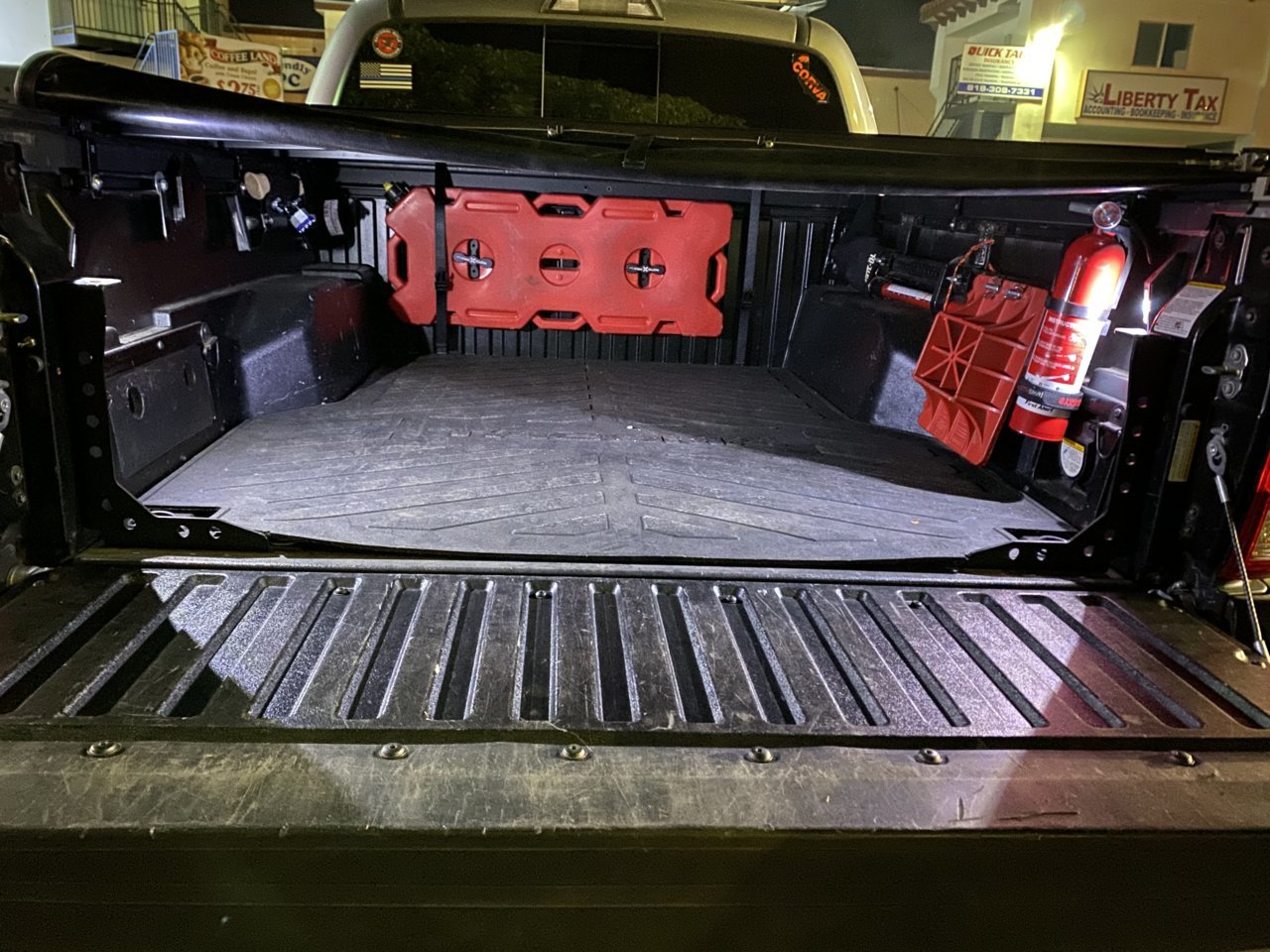

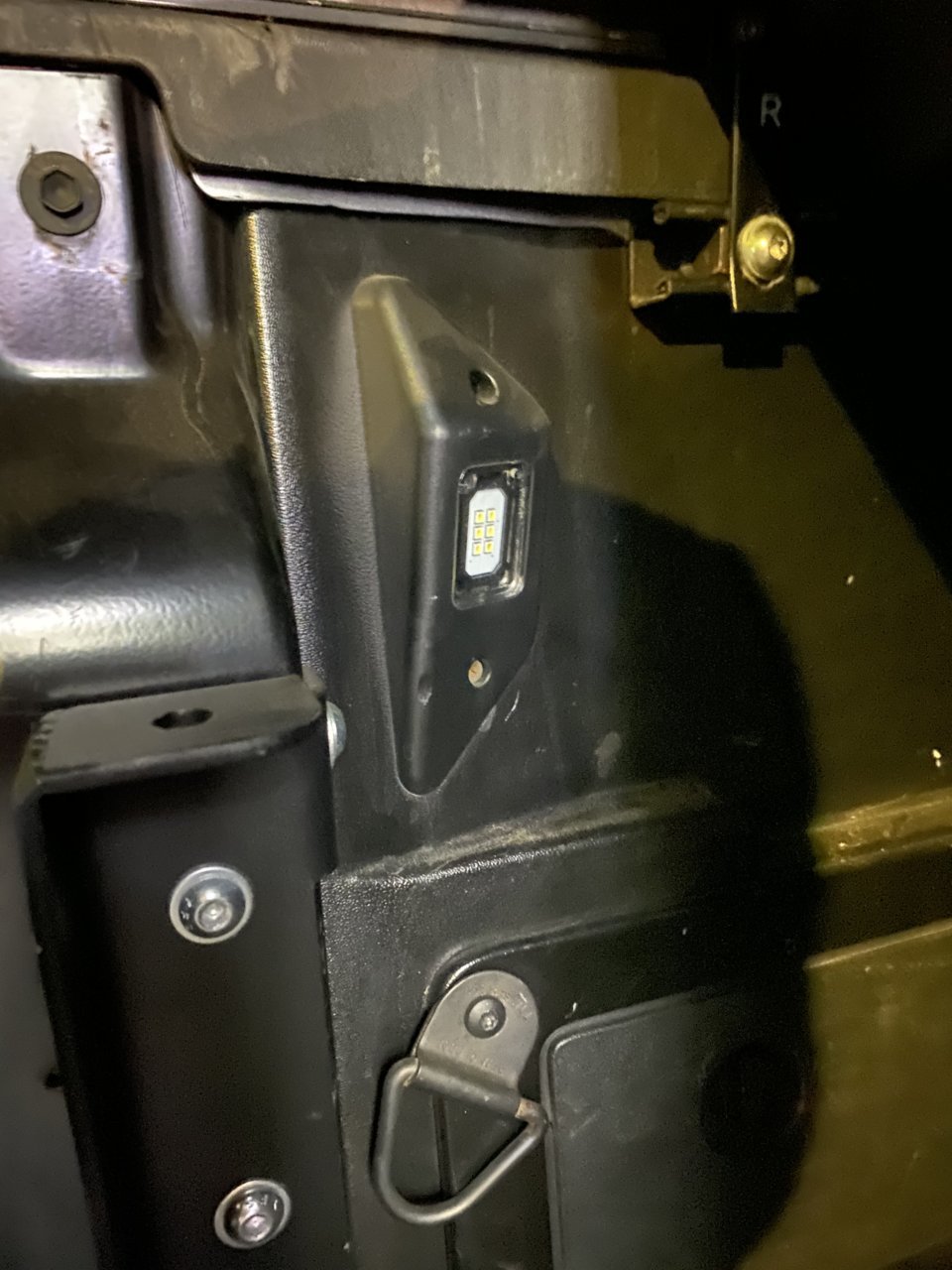

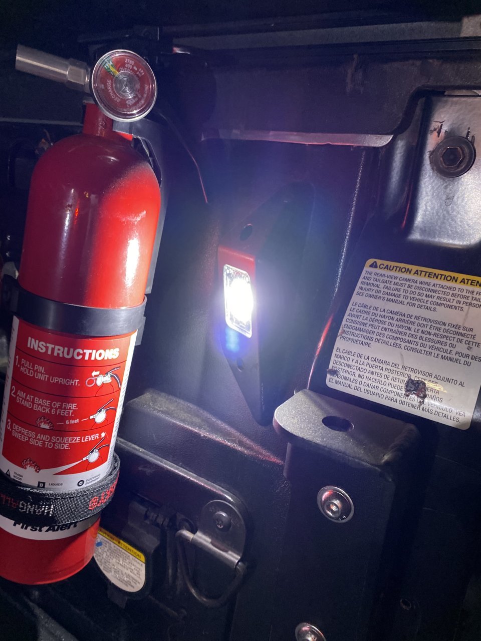

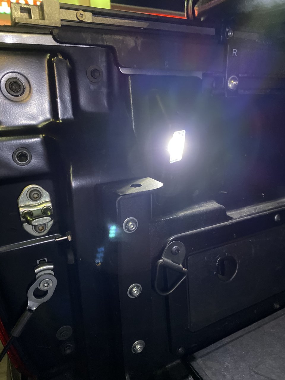

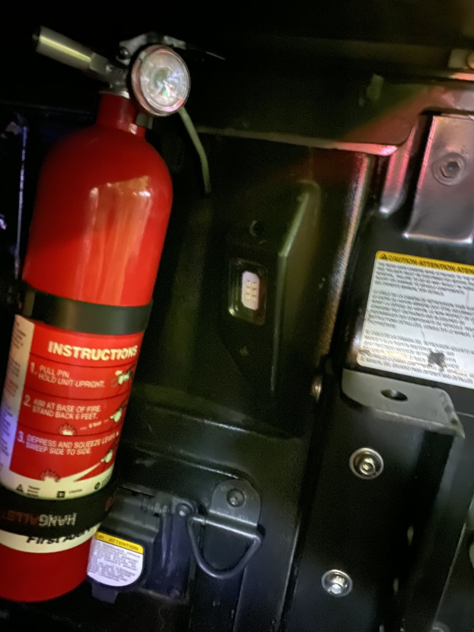

Added Tundra bed lights

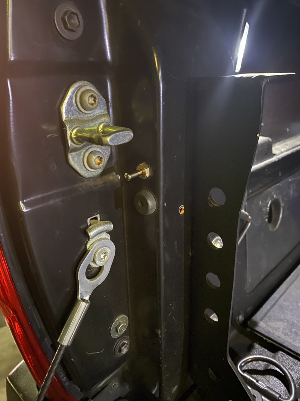

    Write up for the pin switch, and wiring diagram?

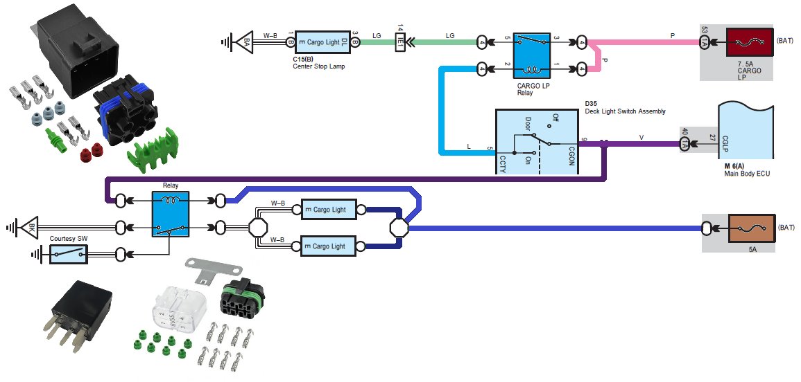

    Here's an option...
    Edit...choices for relay

    Sorry guys but i didn’t do the wiring. My friend did. All he said is he needs a relay and the switch. Ill look into it and try to do a write up.

    Show your friend post#4 and fix it...:rofl:

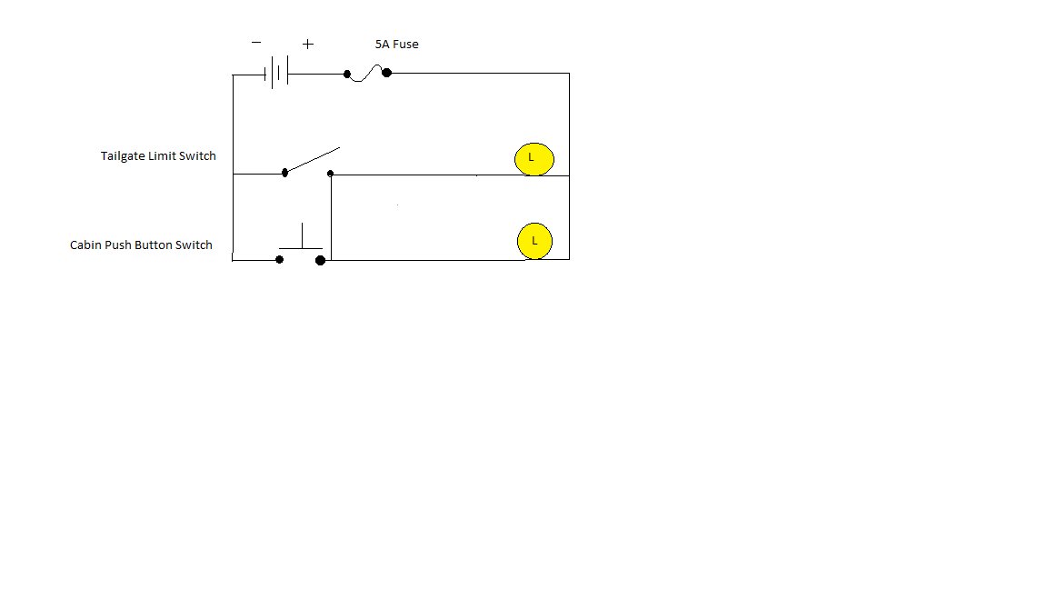

    Bed Lighting Line Diagram.jpg This is how I wired mine. I used LED strips under the accessory rails.
