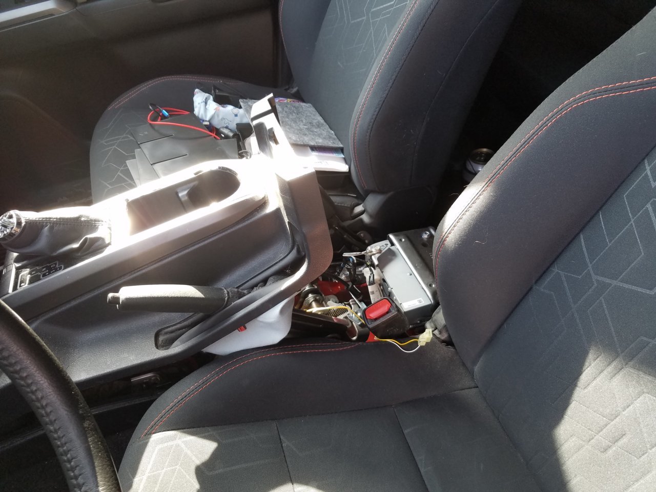

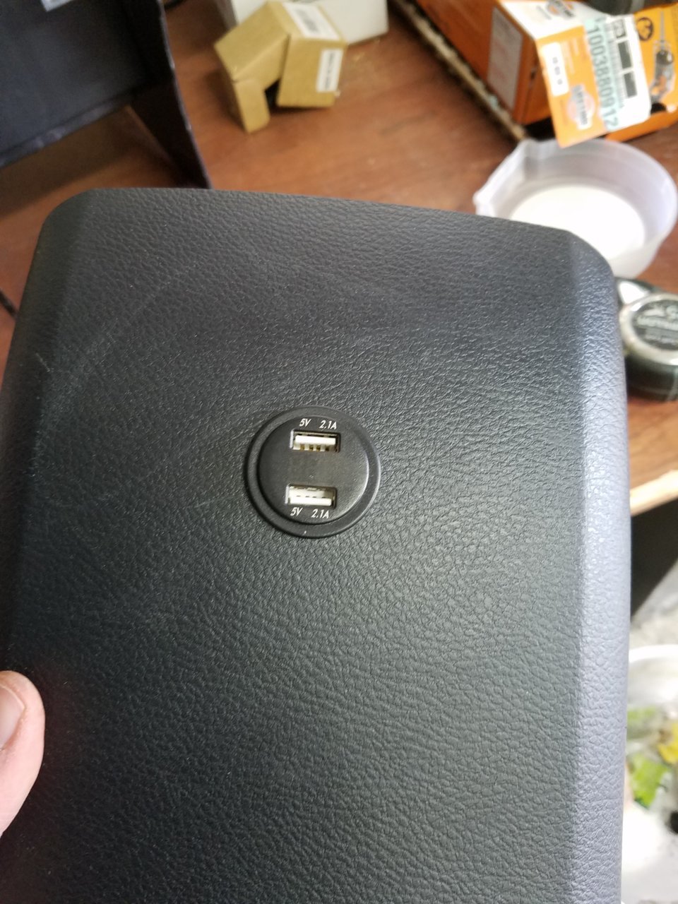

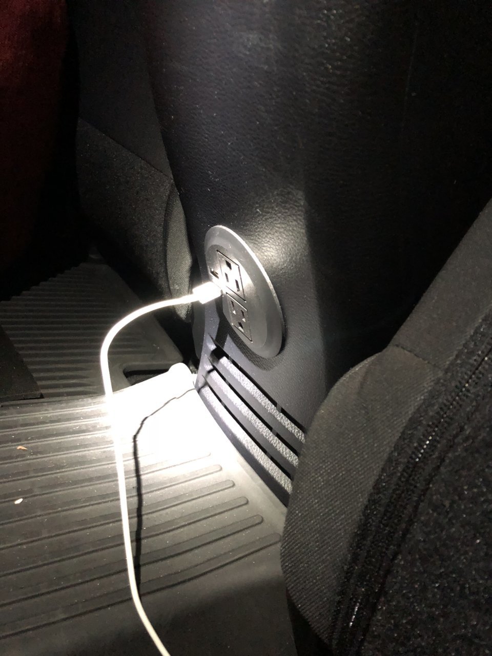

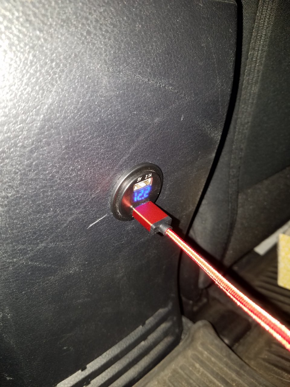

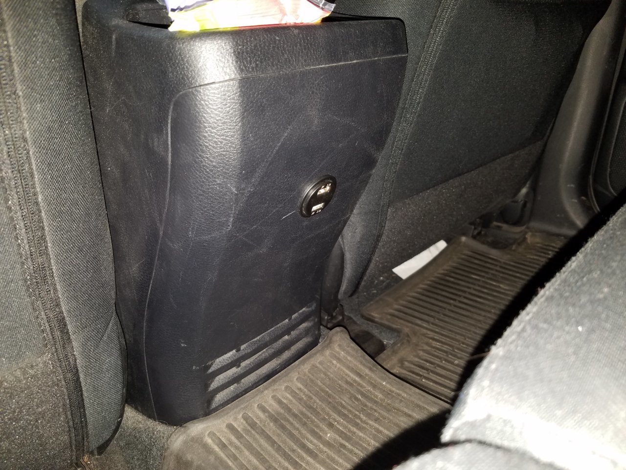

    I decided to add a simple USB charge port to the rear of the center console for use from the backseat. It got annoying having to had a cord back anytime someone needs it and using the front power when I may have needed it.

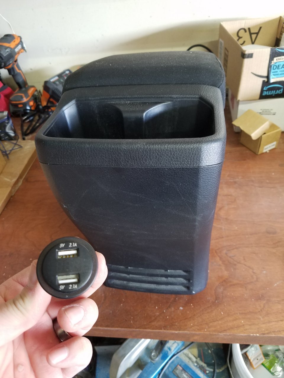

    The charger came from Amazon, it's nothing fancy. Just two ports with a voltmeter. If it were going up front I would have tried to find a true Toyota style, possibly with quickcharge. The backseat is out of sight, out of mind... This is good enough for me
    https://smile.amazon.com/gp/product/B01M4OKBSB/ref=oh_aui_search_asin_title?ie=UTF8&psc=1

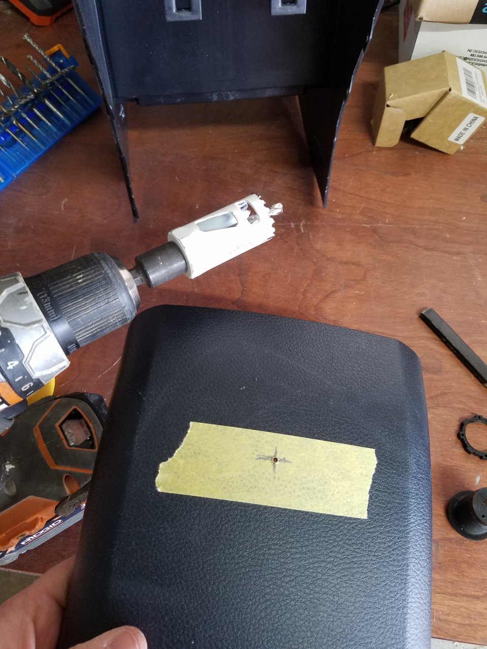

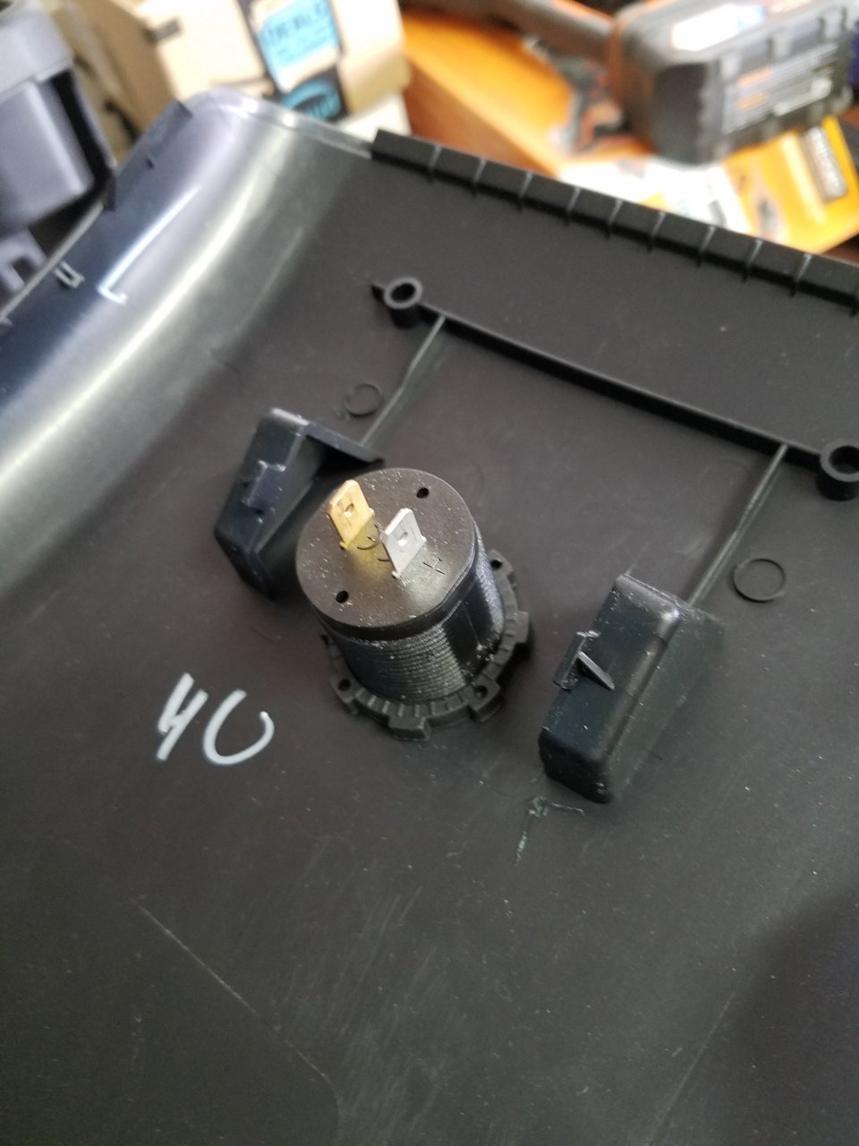

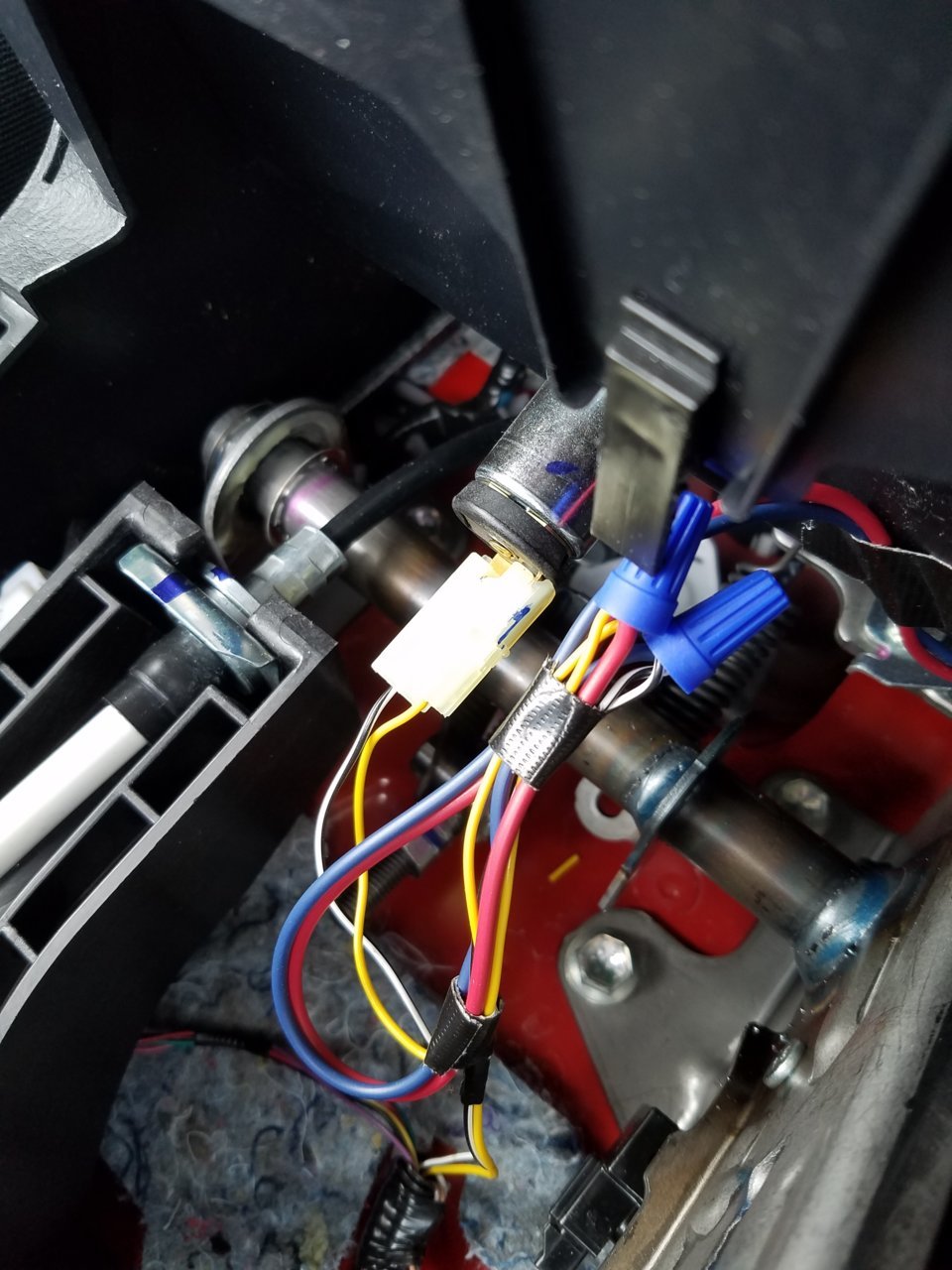

    Install went better than I expected. The center console comes apart pretty quick/easy. The front part pops off and the rear section with the cubby has two 10mm bolts in the bottom. Once apart, I laid out the hole just under the cup holders and popped the charger in.
    While I initially planned to run wires up to the fuse panel, I discovered the factory power outlet in the cubby has some slack in its wires. I chose to splice into power there to save some effort and don't anticipate overloading that circuit/fuse.
