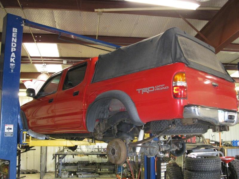

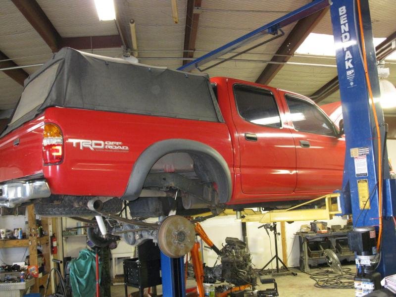

    We are building this for a customer up in Dillon, CO.
    Its a 2001 Tacoma Double Cab. Elocked. Pretty mild rig to be honest.
    The plan is TG kit "C" which some mods to lower the ride height. We are going to french the springs hangers into the frame/crossmember up front to help lower the ride height. Customer plans on 35s for this rig, and I am confident we can deliver it with a frame height around 24" on TG leafs.
    The rear will be more of the same with custom frenched spring hangers to lower it.
    We already have it on the lift and have started assembling the front axle. FWIW, the TG Rock Assault housings have come a long way in quality since they were first released. Its a nice piece and much better than stock. Its still not a Diamond, but its good for the weekend wheeler and DD that this truck will be when done.
    The rest of the build will consist of 5.29s, ARB up front, and 35s. We will also be building custom front plate bumper instead of our normal tube bumper for these.

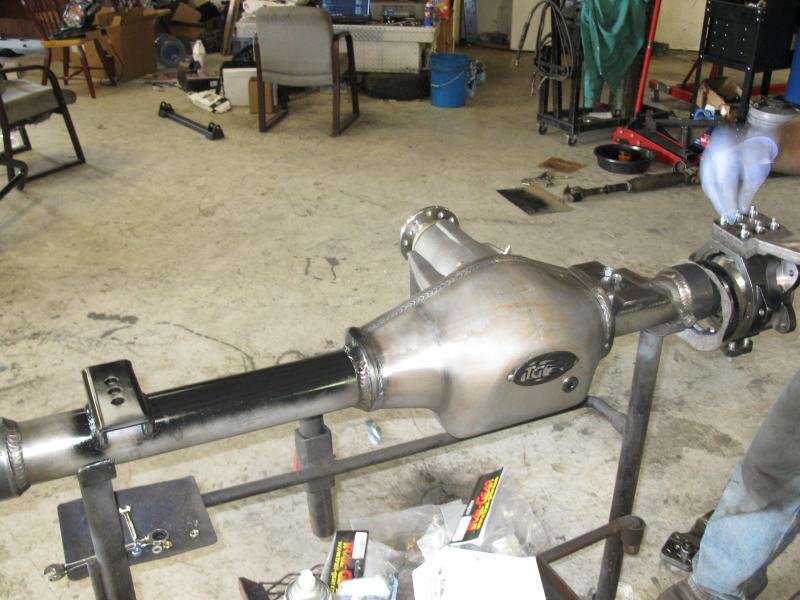

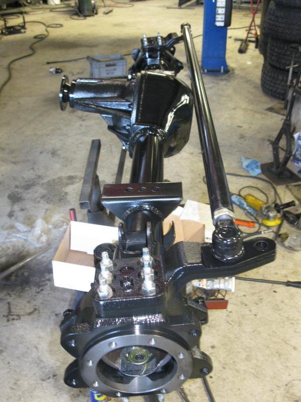

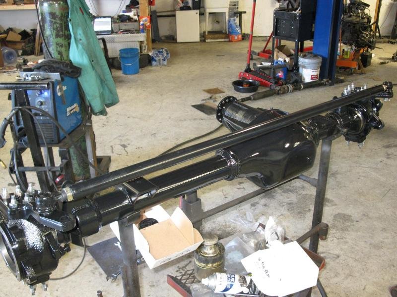

    Got the front axle all sexy today.

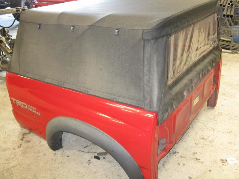

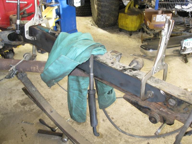

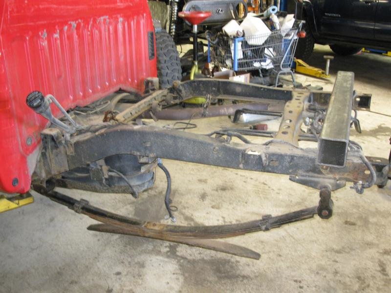

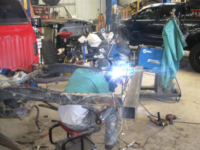

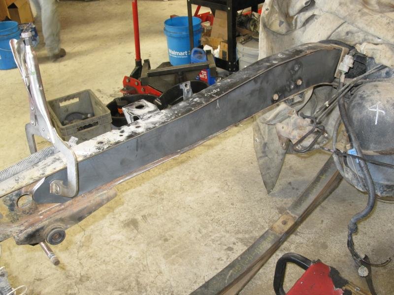

    Pulled the bed to get the rear frame plates welded in. We will also have to drop the tank to get the frenched hanger in later.
