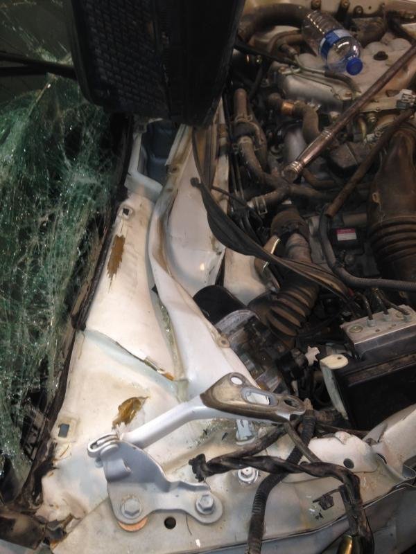

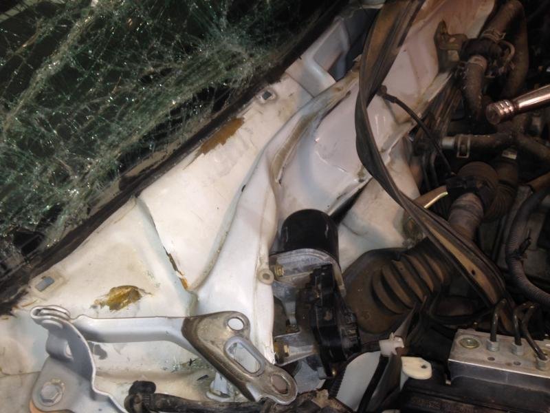

    So, Carriage Shoppe rocks! They pulled the firewall back into place. It also squared up the door perfectly and it will all be workable to get this truck sealed road worthy again.
    Talked to the windshield guy today and it will have a new one in by the end of the day as well.

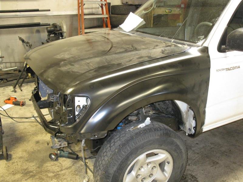

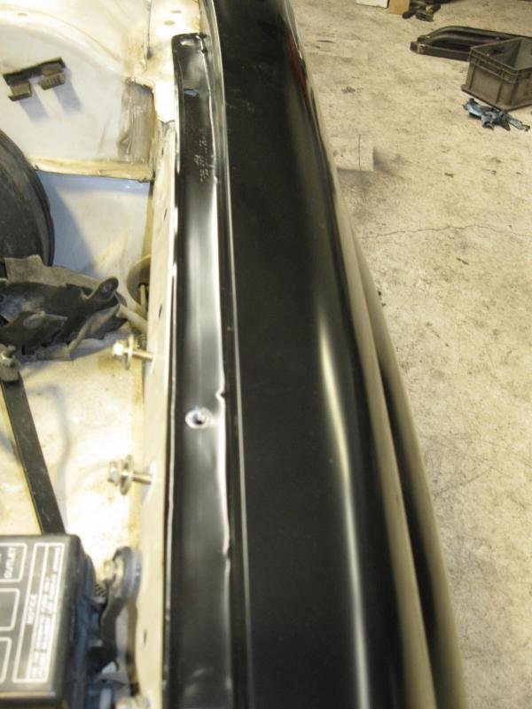

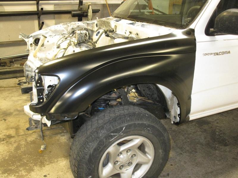

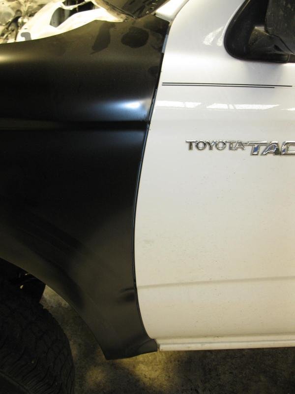

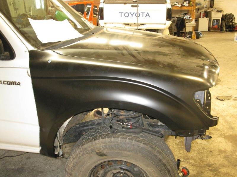

    Just picked it up.
    Slapped a DS fender on it to see fitment, and its spot on.

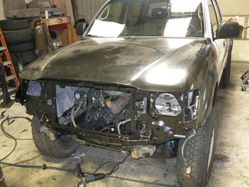

    Some fitment of panels. I tacked the PS new inner core support into place and test fitted some of the panels. Measurements are still a little off, but I should be able to dial it in a little better once I can get some more leverage on the PS panel.
