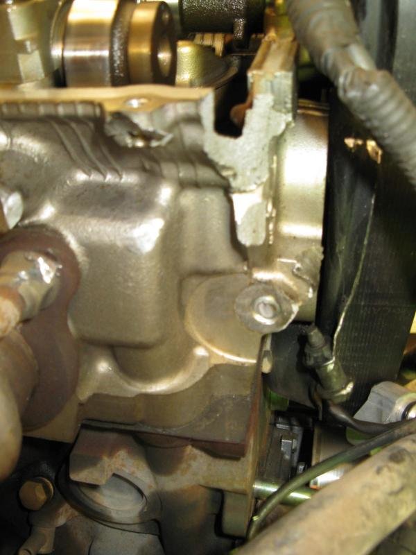

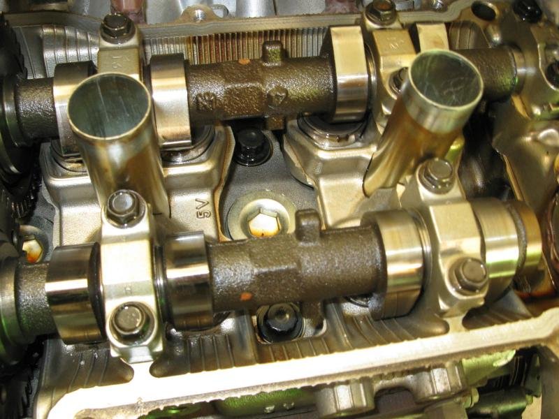

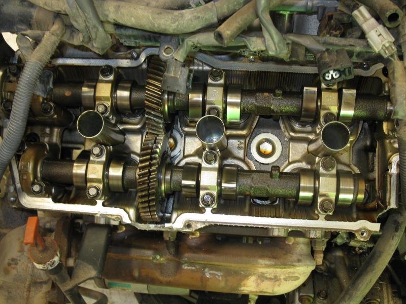

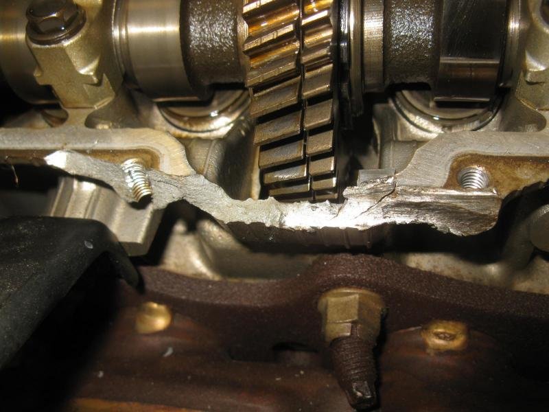

    So, a quick update as I have been ordering parts to get it back on the road. After pulling the motor and really looking at the head, there is no way we can weld it back together. Turns out that there are two places where there are issues. See the first two pics.
    The 2nd pics shows just how torn up the head is. Plain and simple is that its a lost cause as far as the casting goes.
    That being said, look how clean the internals are in this motor. This motor has 202K on it! I was amazed at how clean the internals are. The lobes on the cam show basically no wear at all.
    So, I was able to source a new, original OEM head this week for a good price. And, AMS is going to move all the parts from the current head into the new head with new Viton valve stem seals for $75. That includes grinding the valves before reinstalling them. I have a full head gasket set coming with the head casting as well.

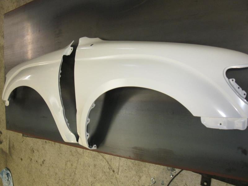

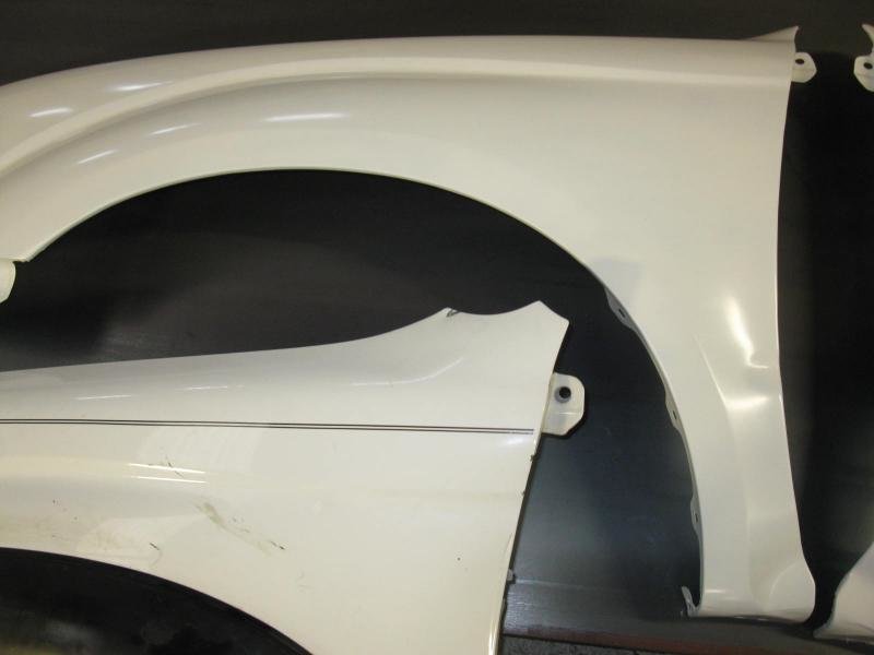

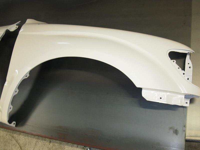

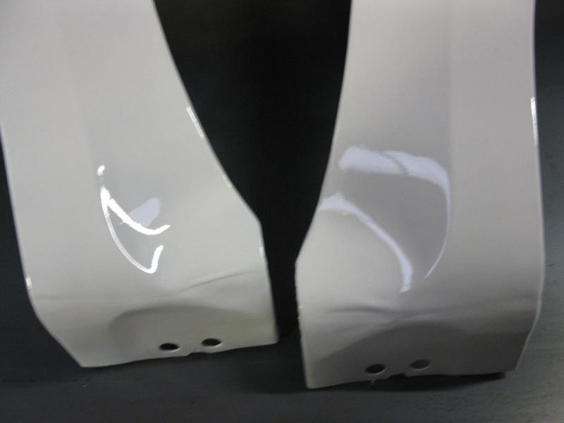

    Grabbed some mixed colored paint to match the Toyota 040 color code at Napa. I think they came out pretty damn good.
    The truck itself is going to require a legit buff as the paint is a little faded, but it should blend pretty damn good IMO.
    3rd pic is of the original fender on the bottom(with the pin stripe)

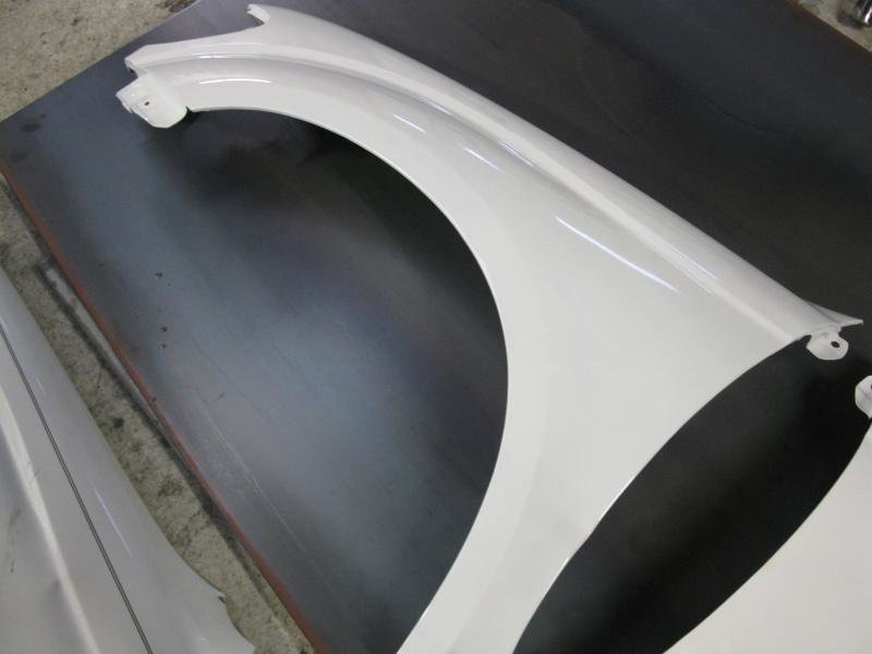

    Threw a few coats of clear on them for good measure. It might take a little wet sanding, but for around $30 in materials I think it came out very nice. Still need to attack the hood this week, but ran out of white. Ordering some more though.

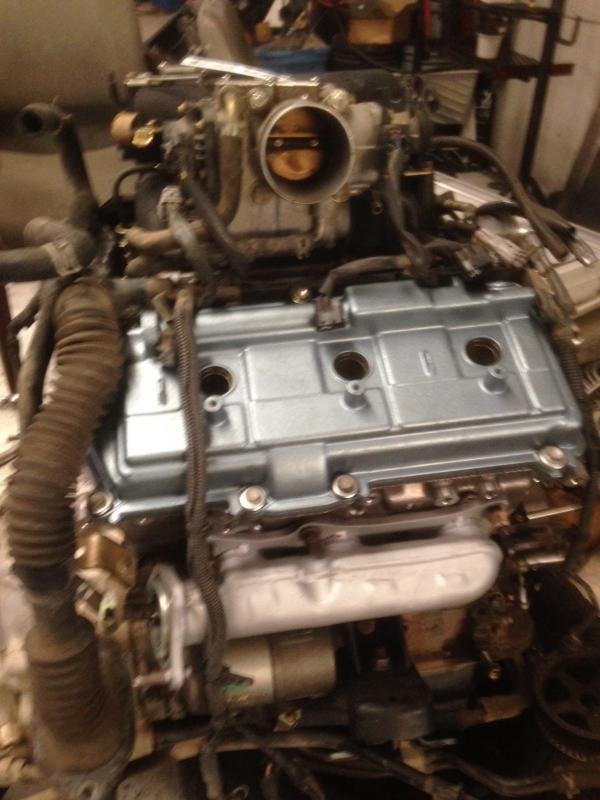

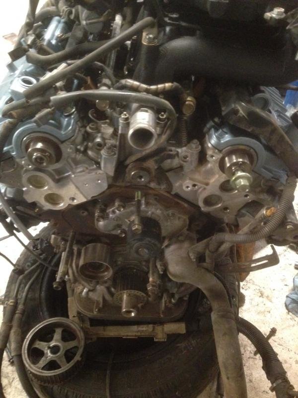

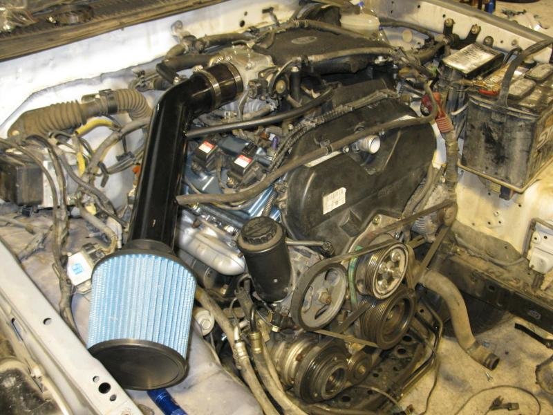

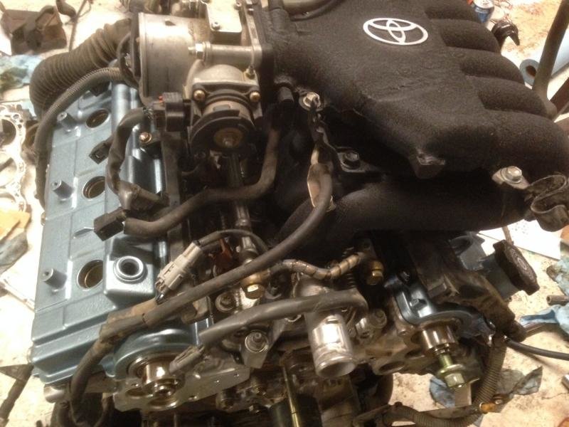

    Picked up the new head yesterday from AMS and spent all day tearing down the other side and putting it all back together. The new casting was a genuine Toyota casting and came with Cometic head gaskets and TRD racing intake manifold gaskets. It all went back together flawlessly.
    I plan to finish the new timing belt, idlers, water pump, etc. tomorrow before trying to stab it all back into the truck either late tomorrow or Monday night. Hopefully I can get it all back in so I can start putting the interior and dash back together.

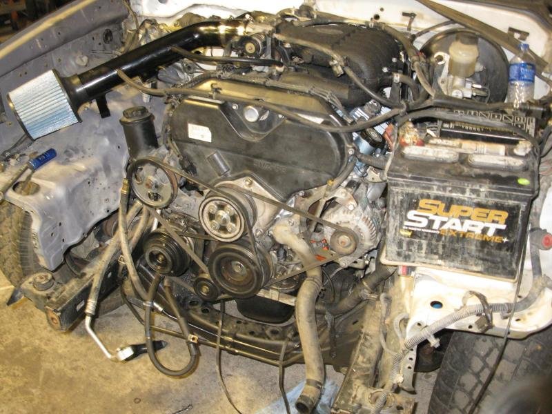

    Motor is back in the truck and runs great! Just need to plumb the radiator, install a new Spal fan, finish the core support install and A/C stuff.
    Then I will repaint the fenders and hood and get this back on the road again.
