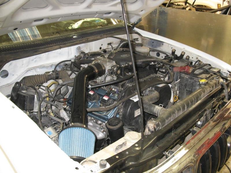

    Well, started putting it all back together today. Have to pick up my under dash A/C unit tomorrow morning as I had Tubes N Hoses in Loveland replace a line on it.
    Once I get that back, I can start putting all the dash and interior back in.
    Video of it running. Sounds like crap on video, but its a very smooth running motor.
    Double Cab Tacoma - YouTube

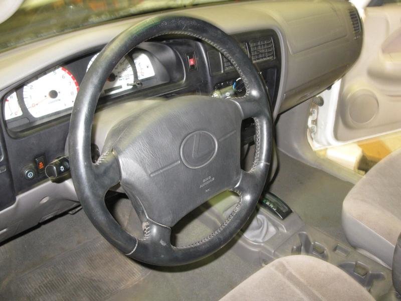

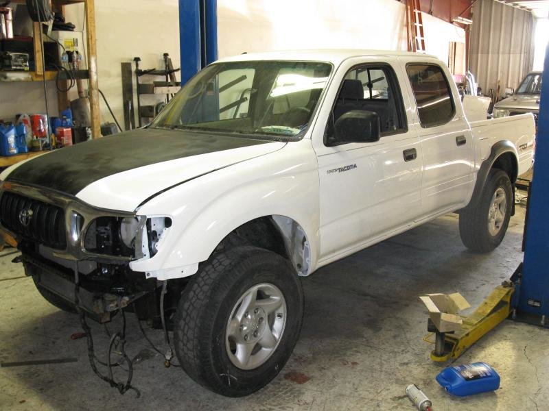

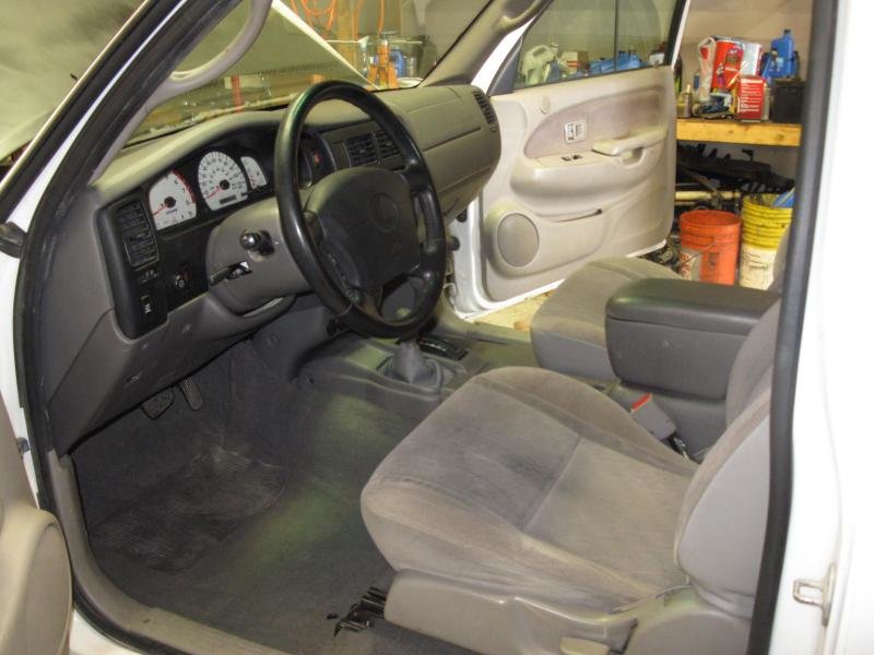

    Interior work is tedious and a PITA. Took all day to get to this point. But, its all back together. I even used the 96' Lexus steering wheel I had from the LS400 I parted for the buggy. I just swapped the cruise control arm over to the lexus wheel to get it to work.
    But, its all back together at this point. Just have to finish the grill, headlights, and fan. Then build a front bumper for it.
