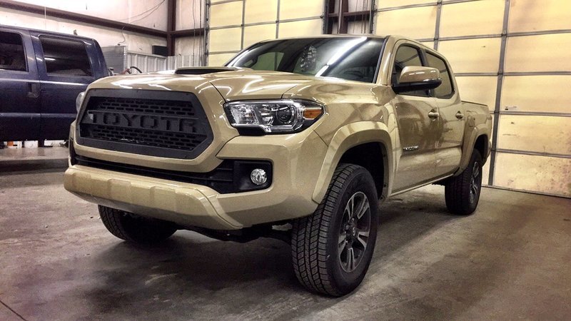

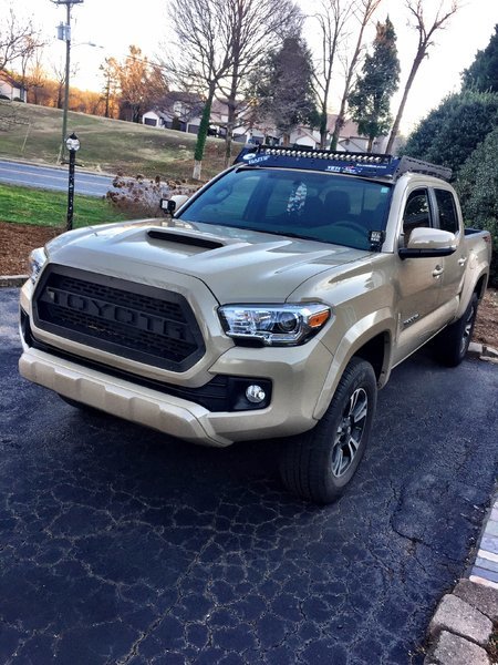

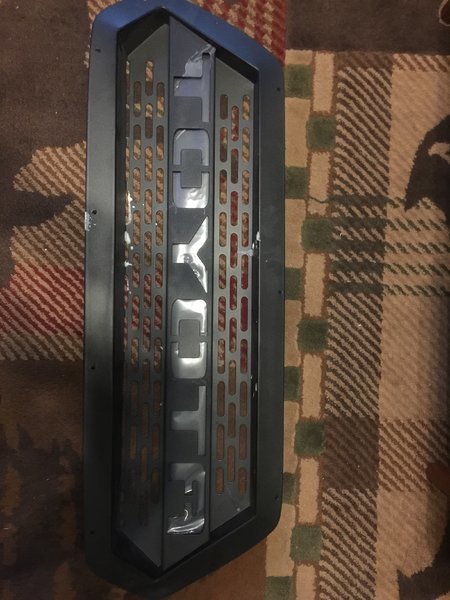

    So first "visual" mod was to get rid of the braces on the front end. Contacted BAMF and got a "damaged" recessed grill shipped out asap. Install was simple and grill only had one small blemish. No big deal to me.

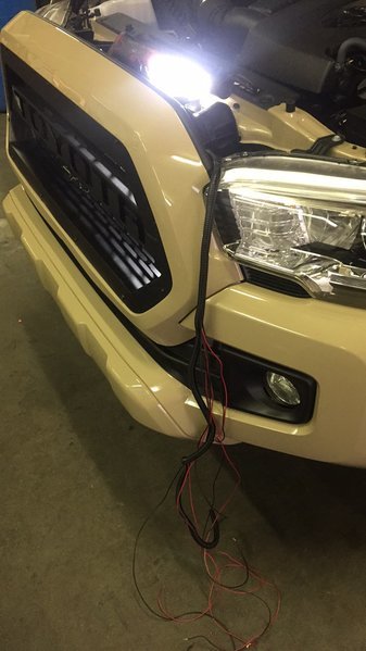

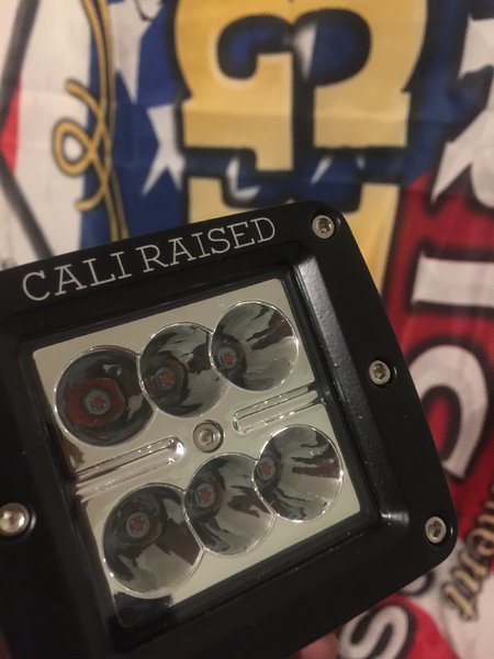

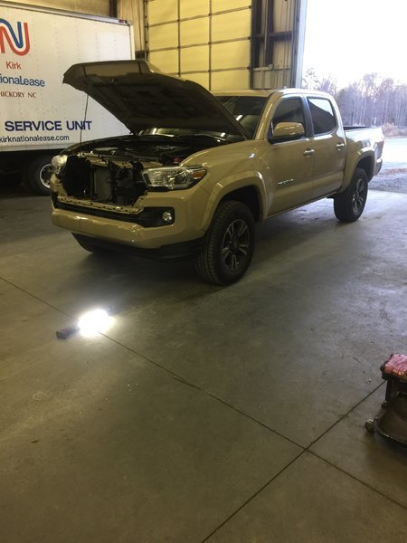

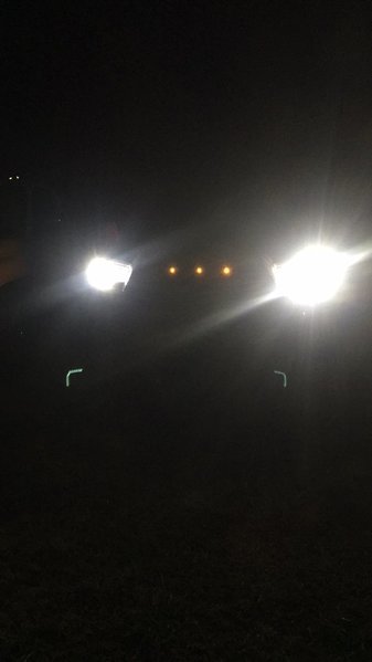

    Secondly had to put the "raptor" style grill to use and install some LED lights. Used some black bolt style LEDs from oznium turned out pretty sweet and clean in my opinion.
    Measuerd and drilled 3 holes in the brand new BAMF grill..remember measuer twice and drill once :cheers:
    Before installings the lights into the rill i pre wired them to extend their harness and use a bigger 18 gauge wire.

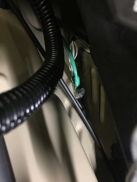

    Used heat shrink on all connectors to insure resistance to corrosion. Ran wires for all three lights in concealed plastic tubing and connected them behind the head light into two single leads. ( one power , one ground )
    Ran the ground to a ground screw close to the battery once again heatshrink and tubing was used

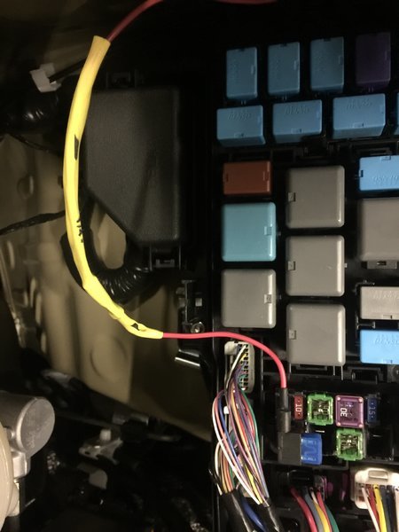

    Ran power into a "add a fuse" in the fuse box to a location where power is applied when truck is running.
    More plastic tubing was added after this shot.
    And the finished product!

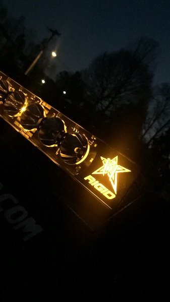

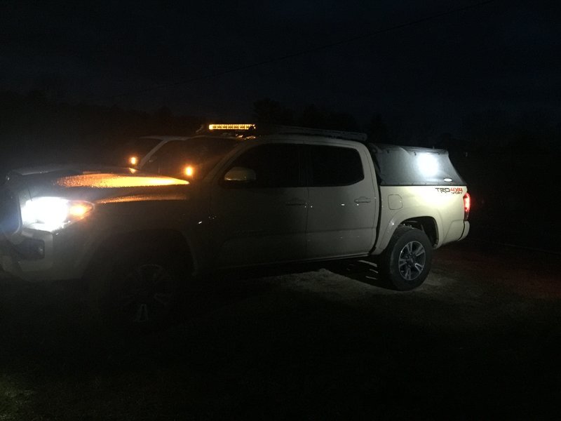

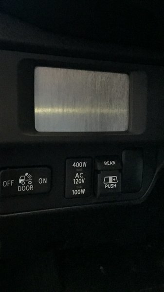

    Update since my last pos.
    prinsu cab rack
    Rigid radiance 40 inch bar
    Ditch lights installed
    Made a switch plate out of aluminum to fit the useless cubbyhole

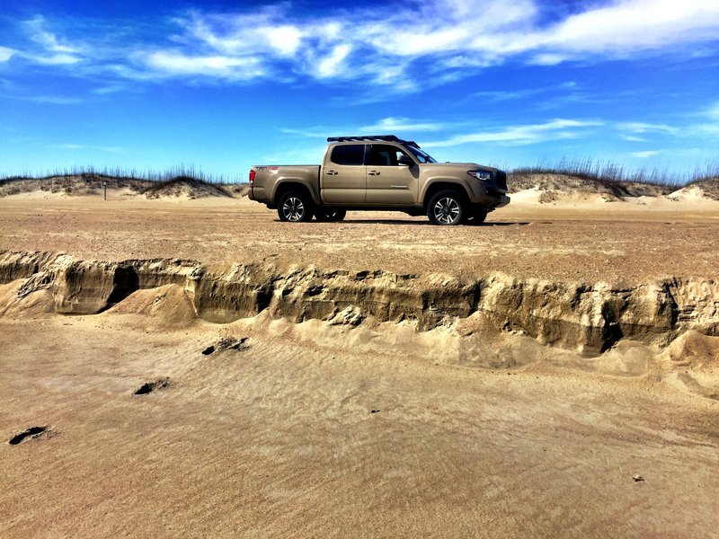

    Valentines day beach trip was a success. Stock tires managed the soft sand pretty well.

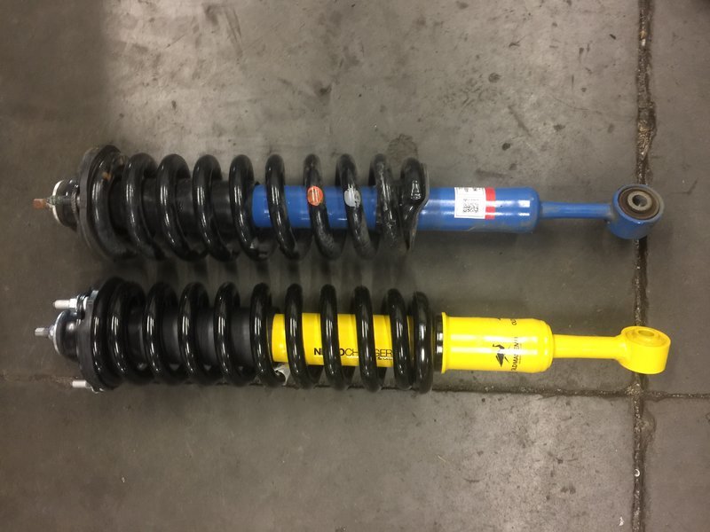

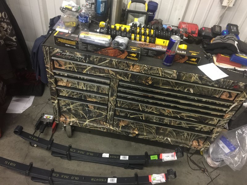

    Suspension orderd went with OME for now would rather spend the money saved from
    Not going coil overs on a rtt. And wheelers was out of the b110s anyhow and shipping was around $200. So i cancelled my order and went with the ome kit with dakar leaf pack through headstrong

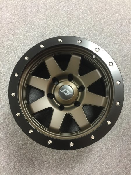

    Sneak peak of my wheels. Scs sr8s 16s in dark bronze

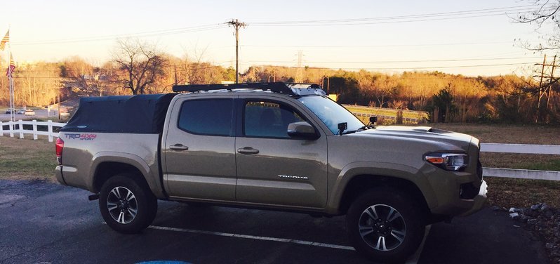

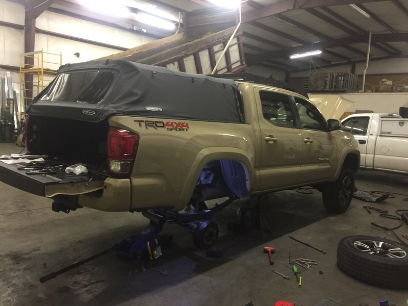

    Came home these evning to my soft topper laying on the porch. Decided to install anyways even though it was pouring rain and dark :rolleyes::rolleyes:

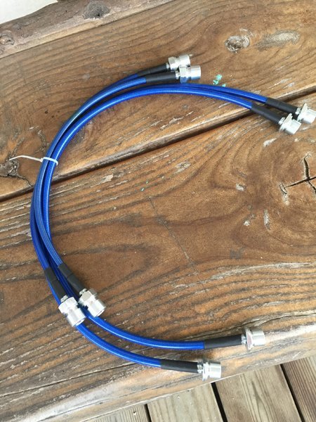

    Extended brakes lines made it thanks @OCTaco Got them a little long so i dont have to change them for future plans :stirthepot:

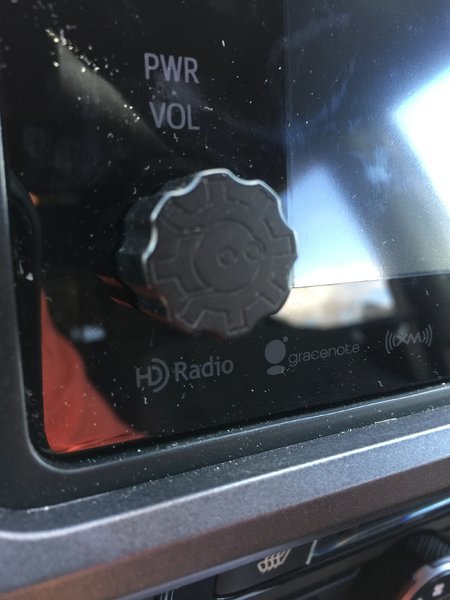

    Stuck hondo knobs on this morning

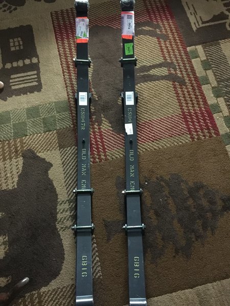

    north carolina mountains
    2020 dclb off road
    Dakar leaf packs made it just waiting on the rest of it :boink:

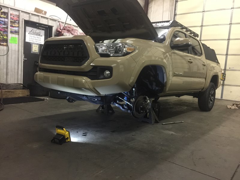

    Managed to get ome lift installed tonight solo....im tired much needed sleep. Rides 10x better then stock though.
