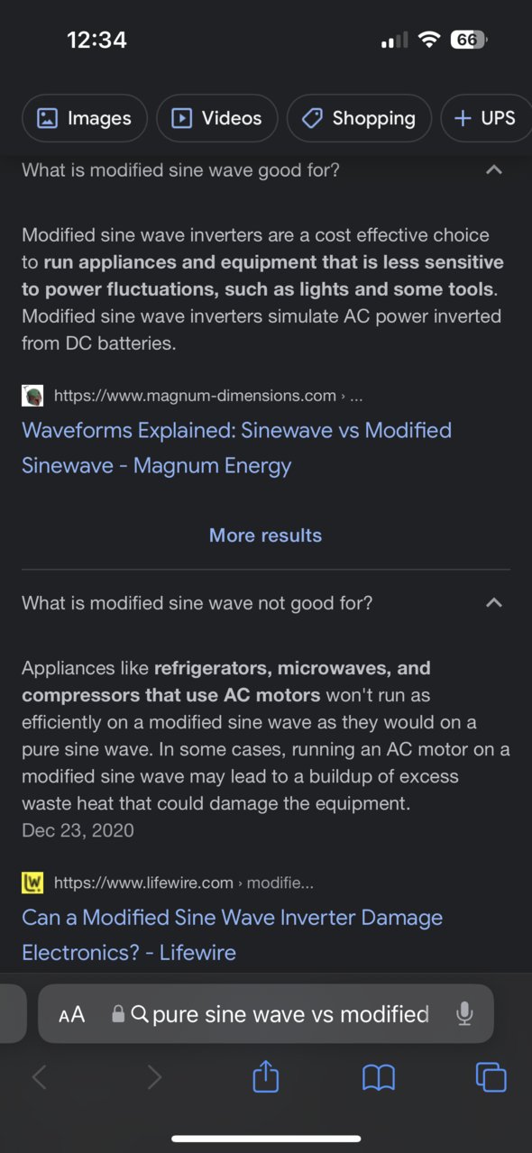

    Be cautious what you use modified sine wave inverters for. I would recommend pure sine wave. 122E7270-BE16-4C46-BA37-CC5BD0225B0D.jpg
