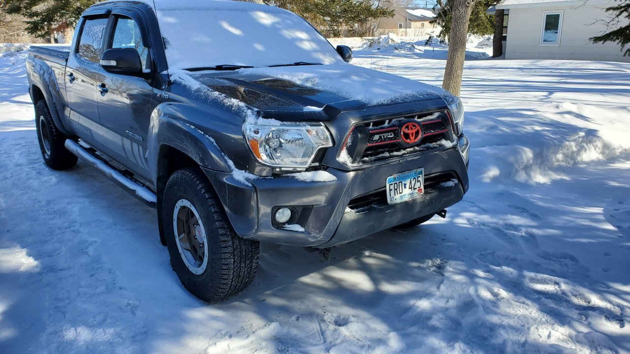

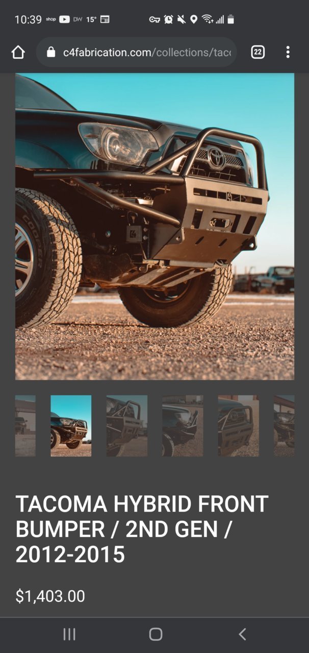

    So I recently hit a deer with my 2014 Tacoma doing minor damage. Enough however to merit upgrading and replacing my front bumper with a C4 Hybrid bumper, weighing in at 137lb and intend to add a winch as well which will add another 60lb to 90lb.
    With that being said I've been doing some research and I'm finding that I'll definitely want to upgrade front end suspension and adding a block to the rear to match the height. I haul a camper during summer time so I don't want a leveling kit.
    I'm also on a budget and I'm not looking for anything too fancy just something to keep the ride smooth and the front end from sagging.
    I'm currently looking at OME 2.5" 886 coilovers and a 2.5" lift block for the rear.
    At that lift height should I worry about camber offset or stressing of stock parts? If so what are my options?

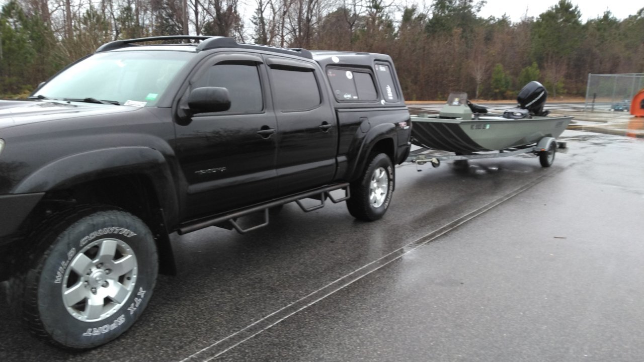

    TW 1-piece driveshaft with 1310 u-joints All Pro and Budbuilt skid plates OME Dakar rear springs 3" with 5100 5100 front set at 1.75" (3rd groove up) with stock springs Falken Wildpeak A/T3W 265/70R16 2018 TRD Offroad wheels 16x7J with +25mm offset Powerstop rotors with Z36 pads and rebuilt with OEM caliper kit Complete rebuilt rear brakes drums, shoes, springs, wheel cylinders Rebuilt rear diff with Yukon 3.73 ring/pinion Denso 130A rebuilt alternator AGM 24F Battery New OEM idlers and tensioner assembly New AC compressor New PS hose and flushed Walker SS Quiet Flow muffler Denso Iridium long life plugs #3421 (SK20HR11) OEM coolant, cap, and thermostat NAPA CV axles and new seals ECGS bushing Rhino front guard Shortened mud flaps Alziria Black Tail Lights Nilight Headlights X-Bull Traction Boards Maaco full single stage paint job 2023 Nat CV to Knuckle seals 710573 New SKF wheel bearings/hubs BR930978 New Moog stabilizer links K80946 & 948 New MOOG K80819 Suspension Stabilizer Bar Bushing 28mm New Dorman rear wheel bearings using complete axles 926-139 & 140 New Radiator support bushings Dorman 924-267 (front body mounts)
    Up to 2" in front stock UCA still work but after that no.
    New OME coils will require new 5100 or newer so more cost.
    Rear blocks will mess with your driveshaft vibes paired with the weak rear springs.
    To do a lift correctly it will cost you or you will open a can of worms/other issues.
    Read the suspension link above as many many opinions.
