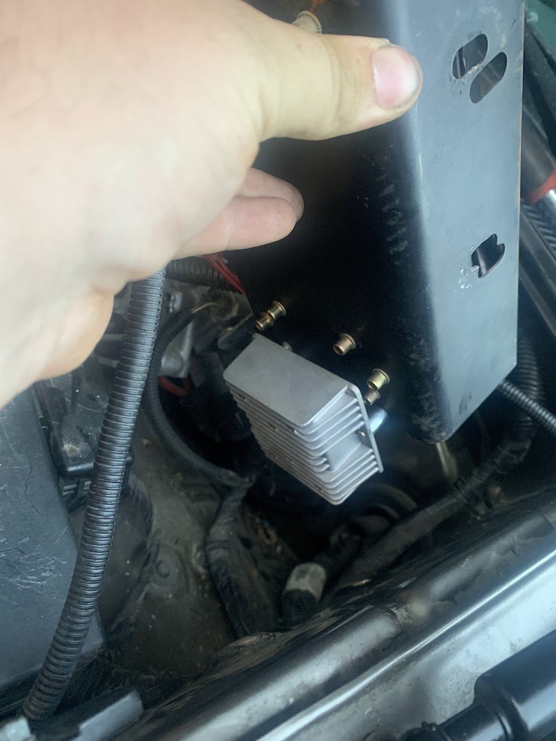

    I did this exactly and it works great. Before it charged at 100w and now 200w.
    https://www.amazon.com/gp/product/B09TB35ZGD?ie=UTF8&th=1

    Running the Bluetti EB55. I think it plugs into the MPPT port but I can let you know later if you need it.
    Set it up almost 2 years ago so I dont remember

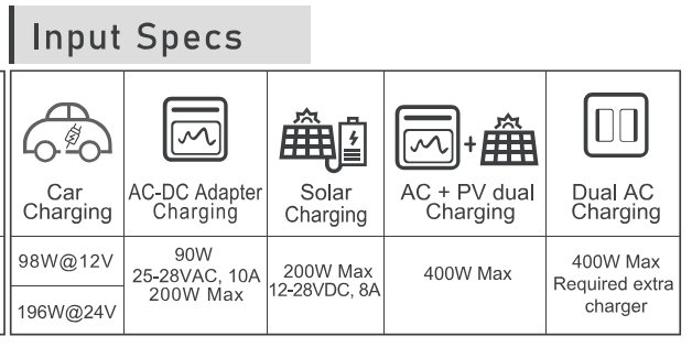

    I see that for the AC200. For the EB55 it was pretty clear you could charge at 8 amps either at 12 or 24 v.
    Below is for my powerstation, not yours.
