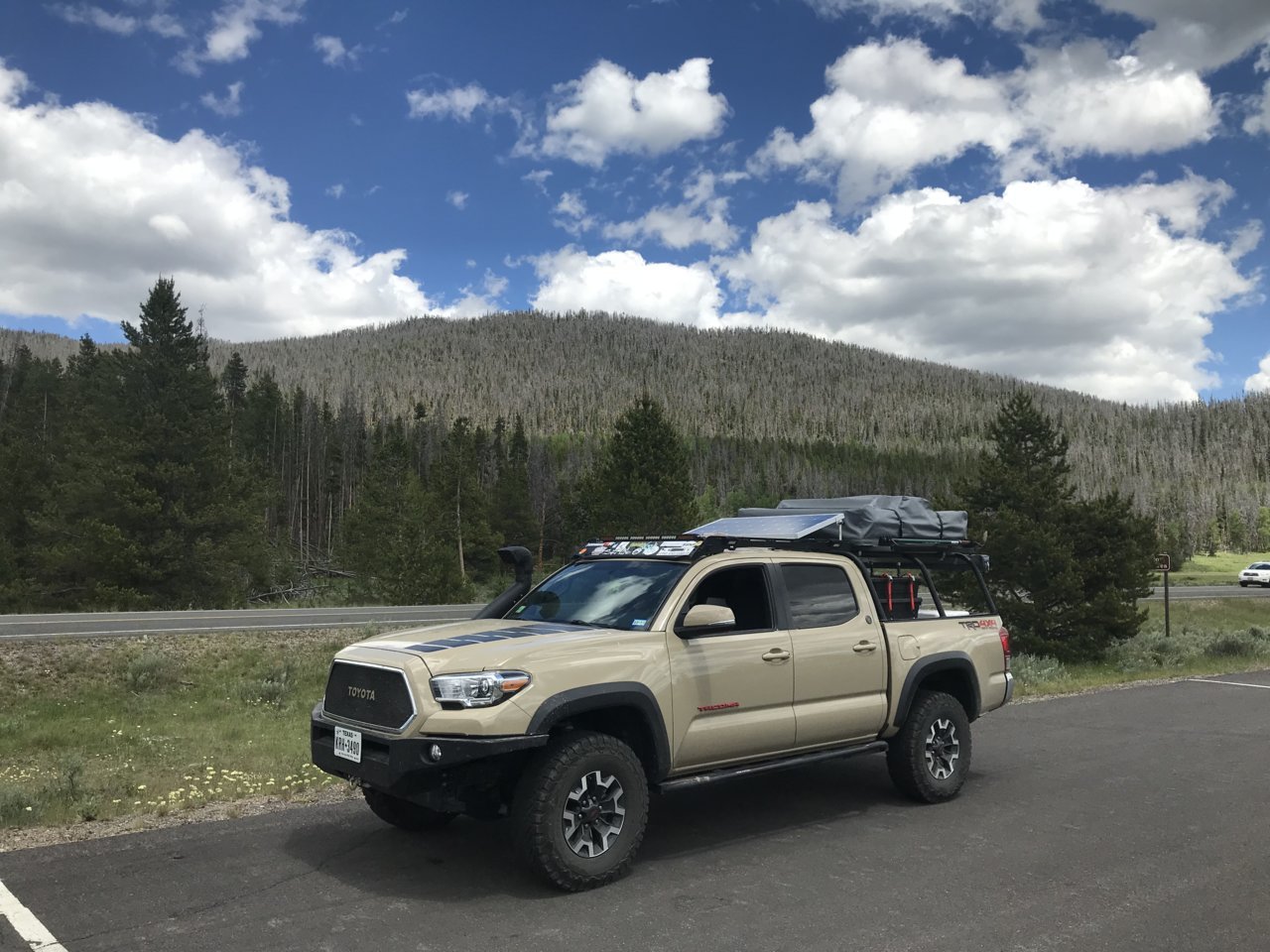

    Dakar heavy packs have served me well with a pretty constant load of 4-500 lbs in the back. I tow heavily also and The Dakar springs have been great.
    My truck tips the scales at 5860 lbs with me, normal load and a full tank of fuel. Just for prospective.
    This pic is loaded to about 6800 lbs for our last trip to CO.
