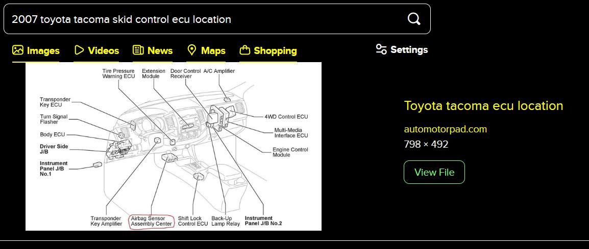

    I am worried if I botch the splicing I will create a bigger headache. So I was considering trying to tap that same signal elsewhere - at an ECU behind the glove compartment. The 'skid control ecu' connector on that model-year's wiring diagram is labelled 'stop' and is much more accessible (assuming it is that same cold-side which would be sensible to me). I think it is pin 14 on the ECU connector. However, the diagram I read this off of was for the 'skid control ecu' (i.e. ABS ecu?). There are a bunch of ECU's on the truck and I am not confident I have assessed this correctly b/c I can fid a 4WD ecu but no skid control ecu. Again my real interest is in the stoplight cold-side circuit which I need to feed to the controller. If I can also find the reverse that would be great so I could ru that back to the 7-pole connector at the rear of the truck. I've seen the reverse circuit called out on the driver-side kickpanel ID2 connector but my Tacoma looks different than the thread I found.I've attached some visuals that lead me to my conclusions/confusion(?) and you'll see they are helpful but in the case of the ECU locations the 'skid control ecu' isn't directly listed on the visual.
    So the questions boil down to two:
    (1) Is the skid control ecu the same as the 4WD ecu (if not what is the location of the skid control ecu)?

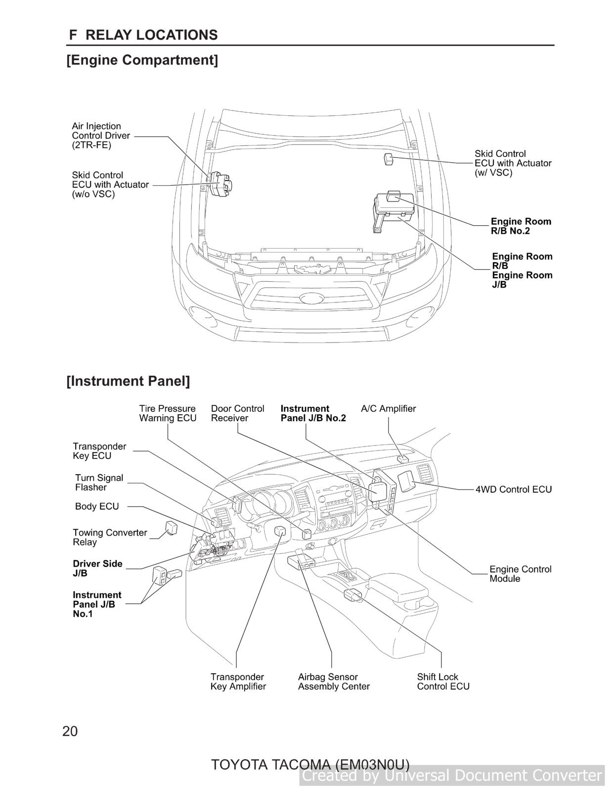

    Not sure what that module location diagram is for what you have but it's not a 2nd gen tacoma.
    The Skid Control ECU (ABS Module) is under the hood.

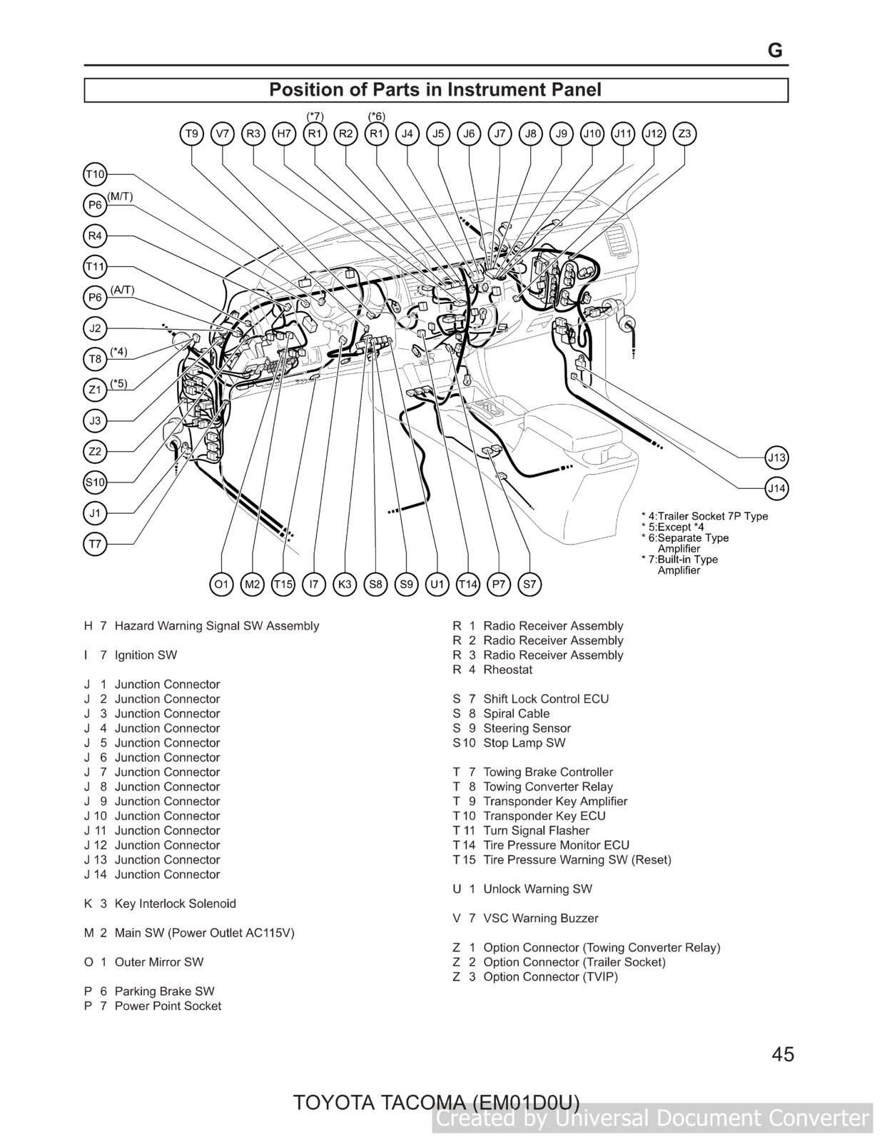

    The easiest place to get what you need would be the T7 (Towing Brake Controller) connector (it's kind of hidden) if it's there, if you don't have the tow package it may not be but it's worth checking.
    Pin 4 (Blue) is the Stop Light Switch wire.

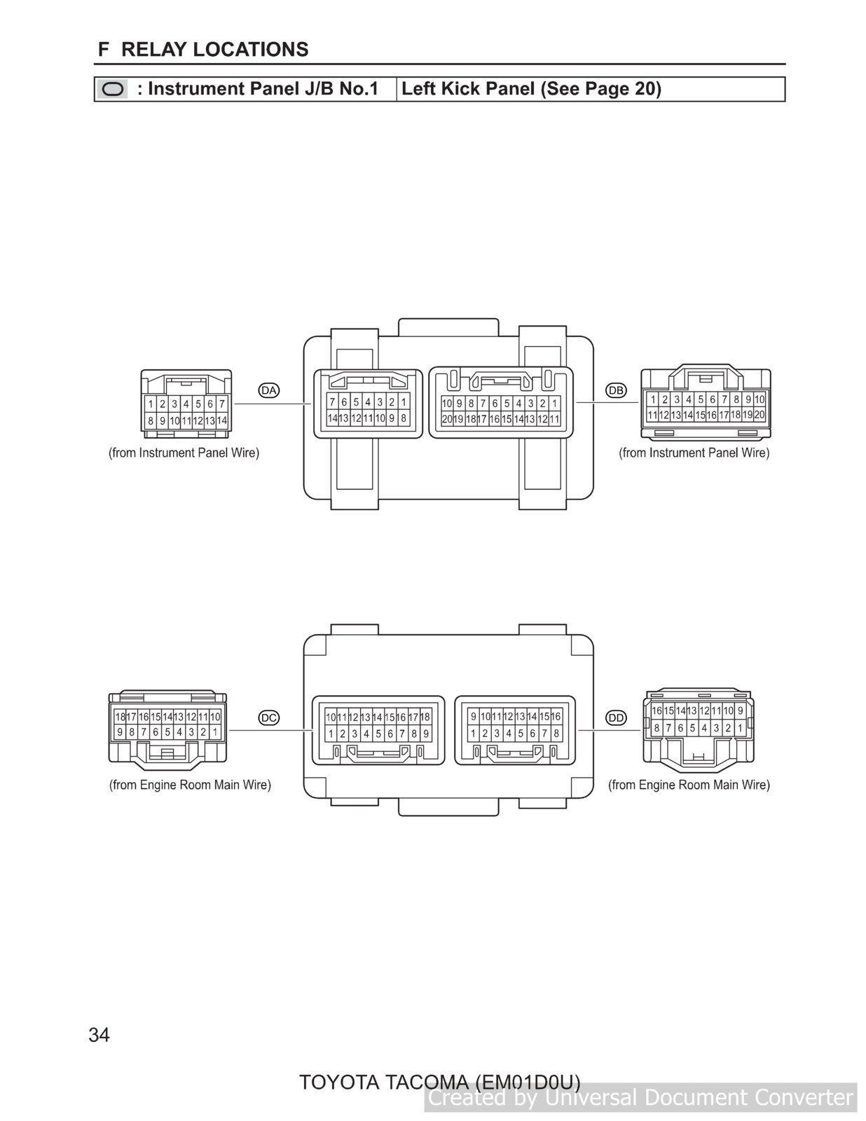

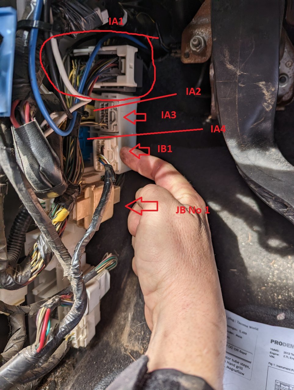

    As far as the Stop Switch signal wire there are plenty of places to tap into it, the next easiest if you don't have the T7 connector is either connector DB (Pin 3 (Blue) or Pin 14 (Blue)) or DD (Pin 5 (Blue) or Pin 13 (Blue)) at the Instrument Panel J/B No 1 behind the left kick panel.
