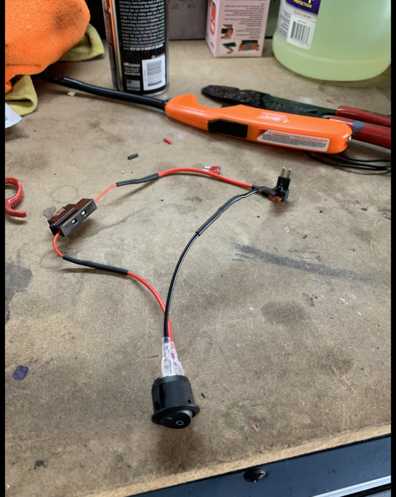

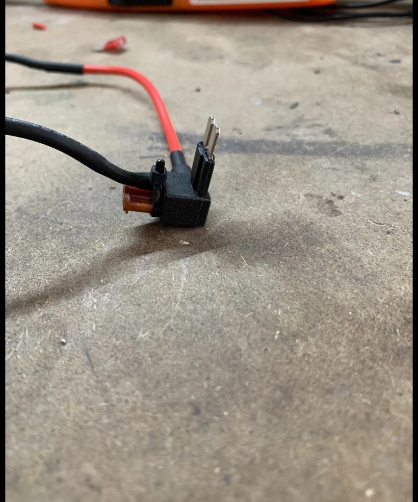

    I built one like this for my Kia and my daughters Hyundai since they were stolen a lot the last couple of years. No issues in almost 2 years.
    extra fuse in middle is unnecessary but I had one anyways. Just hid the switch under the dash and I know exactly where it is by feel. Haven’t done truck yet since it’s normally in garage.
    Guess I’m not saying which fuse was used but you can pull one fuse at a time and find one where it won’t crank haven’t looked on the Tacoma yet though.
