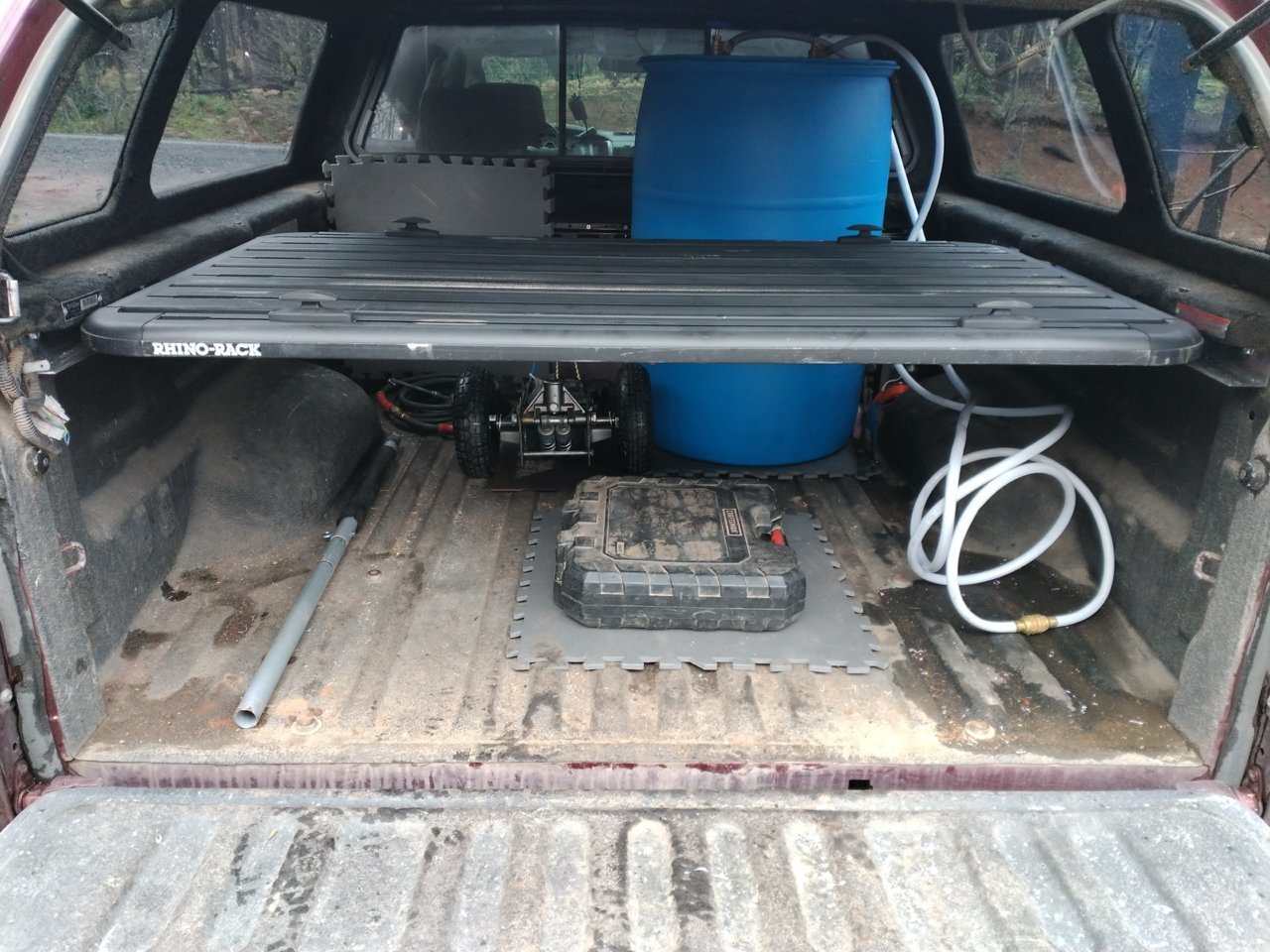

  12. Mar 25, 2022 at 8:25 PM
    windsor
    windsor Just a guy
    Dec 31, 2014
    #145322
    7,669
    Homeless in Oregon
    2008 Tacoma Super Duty aka Tundra
    Canopy, fitted seat covers, OBA with self leveling air bags, 100w solar, dual Rhino Rack Pioneer platforms, side & rear LED work/FU lights, CB, cell booster. 7x16 cargo conversion, 3" lift, 7'x6.5' fold down aluminum rear deck.
    In my Tundra
  13. Mar 25, 2022 at 9:13 PM
    phdog
    phdog [OP] Well-Known Member
    Jun 27, 2017
    #222534
    1,277
    Jim
    Northern Colorado
    2017 TRD Off Road
    w/Super Terrific Happy Hour Mod
    Nice. Could you expand on that a bit? Did it just happen to fit that opening? Did you add anything to mount/hold it? Thanks.

  15. Mar 25, 2022 at 9:31 PM
    windsor
    windsor Just a guy
    Dec 31, 2014
    #145322
    7,669
    Homeless in Oregon
    I used aluminum angle bolted to the holes or the OE side rails. I later added 1"x4" aluminum rectangle tubing to get the platform almost level with the edge of the canopy and have a little more support.
    It's enough that I can lay down on the platform and it holds strong.
    I narrowed the platform and put the slats closer together. If I had to, I could have easily shortened it to fit between the rails. I like that I have pretty much unlimited mounting options for whatever I want to mount on top (tool box, jumper cable box, tow strap and air hose box) or hang below (shovel, axe, spading fork, roll up construction sign holder, and jack handle mounted on the bottom).
